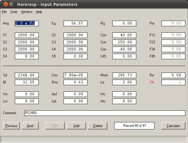

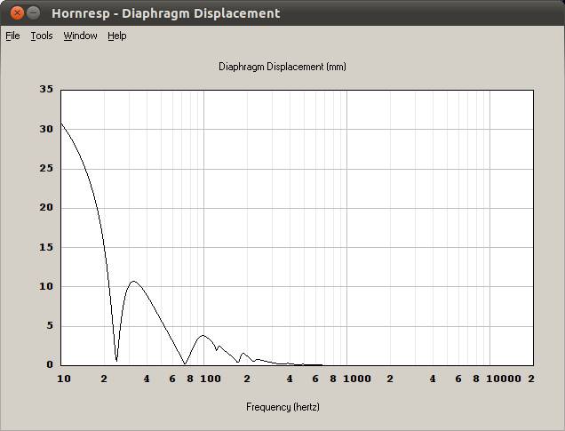

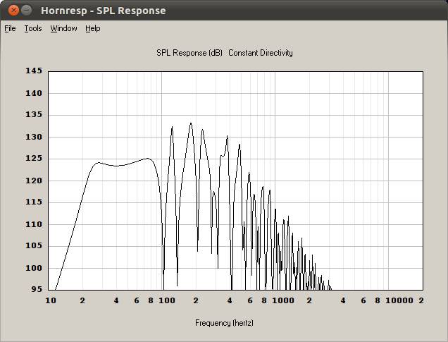

Hmm, I posted on the other thread, so assumed a 1pi space loading. For an outdoor 2pi loading it needs to be larger, but due to HR's mouth size limitation I had to increase the cutoff to 21.7 Hz, which is still low enough to achieve your stated performance requirement.
