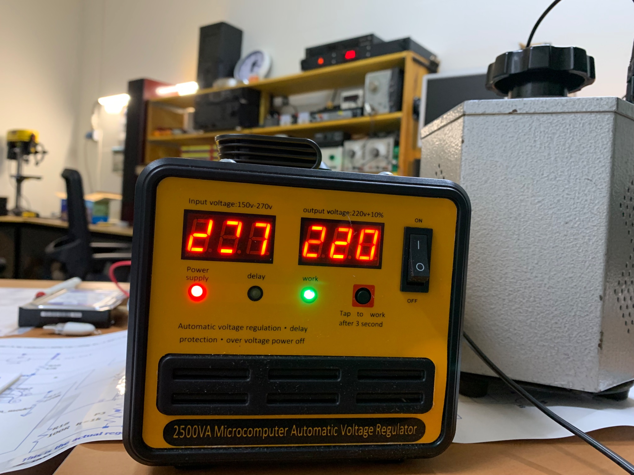

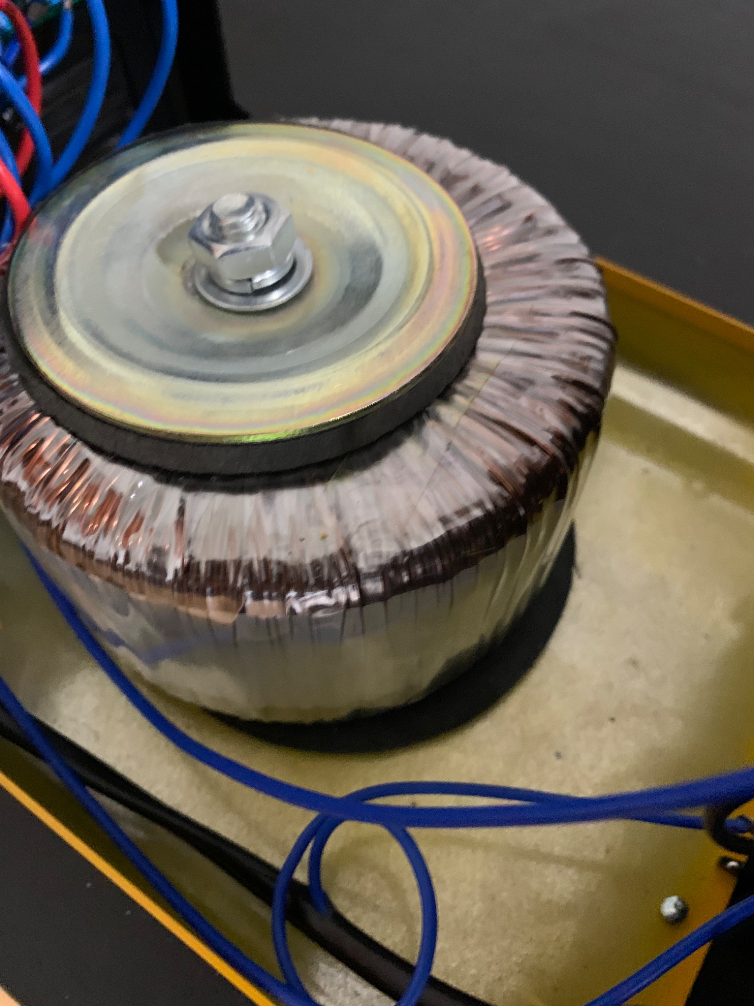

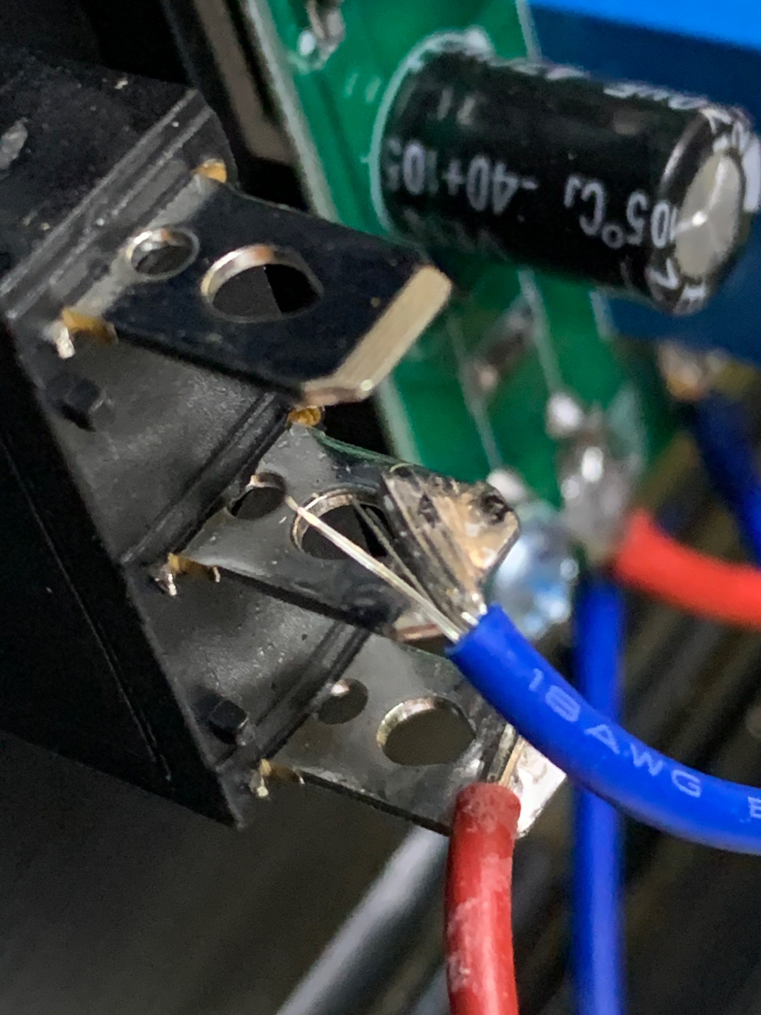

I received this unit this week from China and I ran some tests and took a look at the inside of this unit.
First of all: it works! I tried with input voltages from 200 to 260 Volts from my old Philips variac and the output is always close to 220 Volts.
When I looked at the inside I noticed quite a number of issues:
I think you will be able to see most of this on the pictures. My conclusion is that this unit is NOT according to EU standards and potential unsafe to use.
I will be able to fix these safety issues, but I would never use such a unit out of the box without modifications.
Regards, Gerrit

- On the website the unit is offered with a VARIAC with a motor for continuous changes. However I received a unit with a TOROID with multiple voltages, switched by 3 relays. So I did not get what I ordered! Grrrrr!

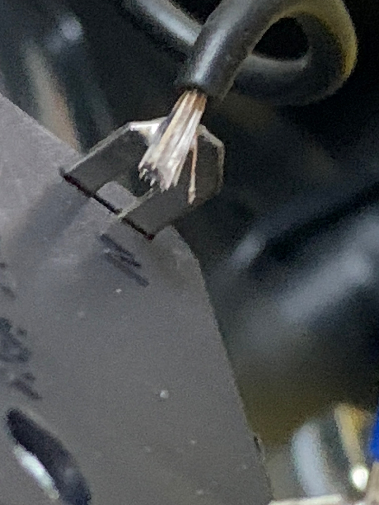

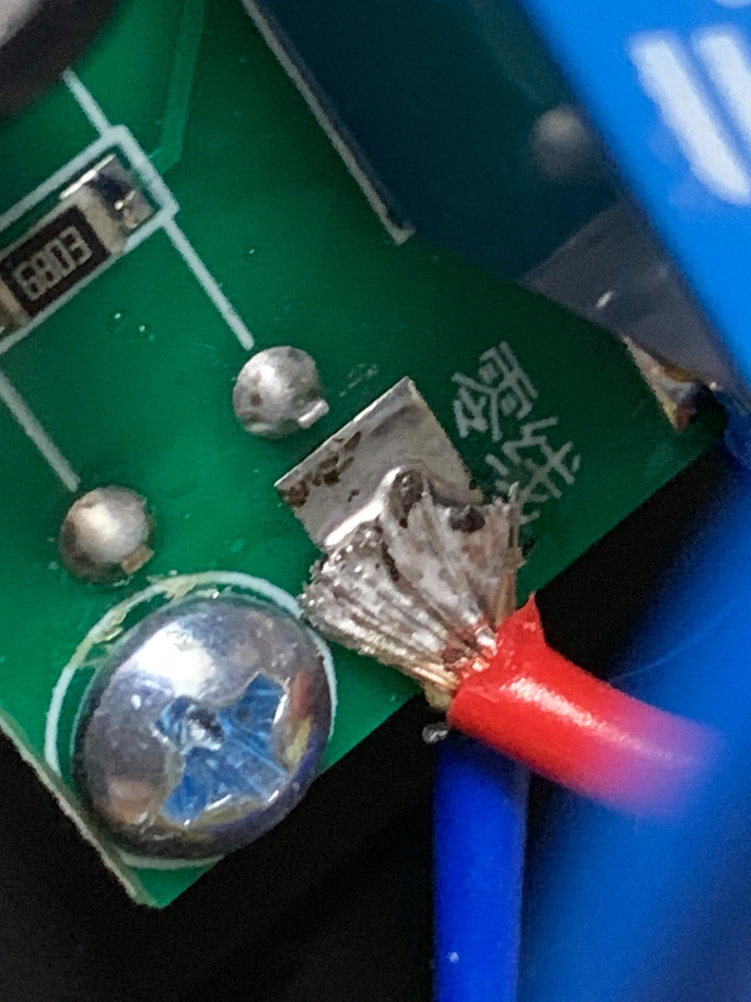

- The soldering of the internal wiring is terrible.
- One wire, soldered to a PCB nearly touches a metal screw.

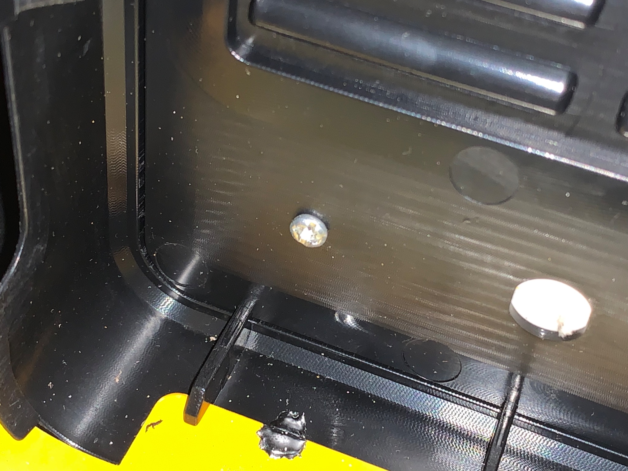

- The grounding screw on the back of the unit is connected to the enclosure, made of PLASTIC. The top shield is not connected to the ground screw in any way either.
- The TOROID’s mounting screw was loose and the toroid was hanging by it’s wires.
- The internal wiring should be good enough for 2500VA. This means the thin wires should be able to carry more than 10 Amps. I cannot believe this is true.

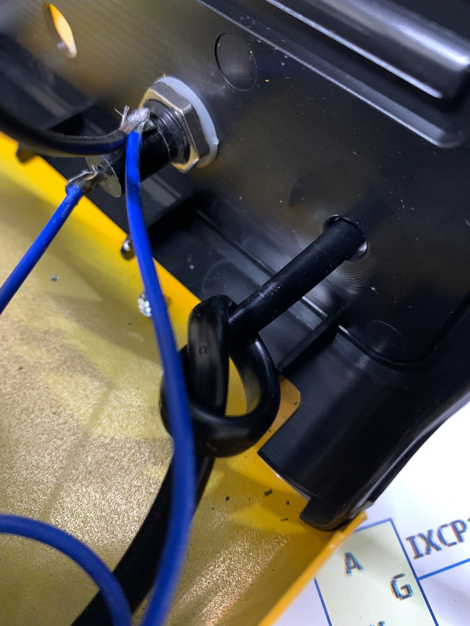

- The power cable’s strain relief is just a knot in the cable.

Horrible workmanship! And the seller committed fraud by representing it has a motorized variac. Depending on how you paid for it you should dispute the charges or request a refund.
You can probably clean it up and make it safe(r).

I’m now rebuilding it with proper wiring, proper grounding, a grounded power cable, a proper grounded Schuko power outlet and an automated output switching instead of a manual switch. First of all I mounted the toroid properly and stable. The automated output switching can be switched on and off with an extra switch.

Returning it and finding a safe one maybe is more efficient. This is one of the worst built devices of lately. Who can tell if the transformer itself is safely wound? The switch also does not seem to be a double pole type as required in the EU. Like many hobbyists the chinese manufacturer did not understand that IEC inlets are meant to be used with faston connectors. For 2500 kVA at 230V (China has 220V) normally 2.5 mm2 wiring is used but it is surprising how many Ampères can be pushed through thin cabling for a longer time.
It seems a stabilizing transformer (look that one up, it is special) and the 3 relays for 3 input ranges. These work but often at the expense of 50 Hz hum. The ones with electronic triac based tap control are to be preferred over relay types. Stabilizing transformers are somewhat unusual to many and they are also harder to understand.
