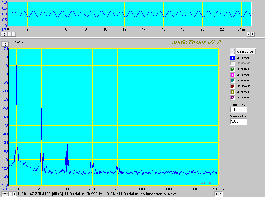

http://www.pmillett.com/starving.htm
This is at a very high output power level.
At the P. Millett website 'Starving Student Hybrid'
This shows the ear-friendly tube type of distortion we an expect.
Very Dominant is the 2nd harmonic.
At this extreme high output level THD is 5 % 😉
In order to get any change in sound, we have to be able to hear a difference. Distortion is to change, add something to the sound.
And the distortion level we has to be well above 0.1-0.2 % to get a change in sound.
To try to get tube sound out of one tube amplifier with 0.01 % THD is impossible. We might as well use one Op-Amp with feedback.
If we want tube sound effect, we must give the amplifier chance to effect the input signal in some way.
MOSFET and Tubes are known to both have more of nice 2nd Harmonics distortion.

unusually nice harmonic spectrum indeed, some negative feedback would make it look a bit more homely...
