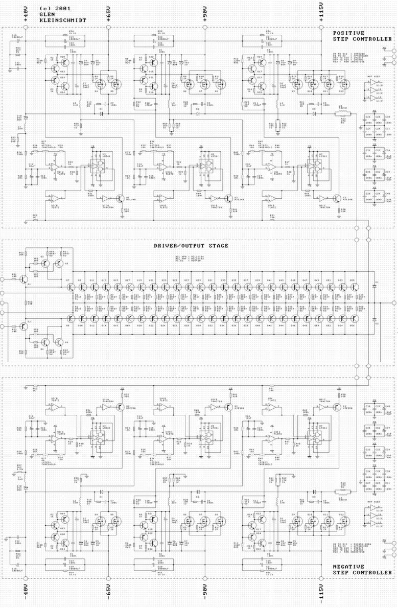

It's only a simulation rather than a real built amp but from my own calculations then if it's designed for a 1R load then yes it could do it. Glen posts good stuff on this here site and knows what he is talking about..
nonono look at all the rail switches! 40v + 65V + 90V+ 115V = 310V rails!!!
310/4ohms = 77.5 amps x 310v = 24kw factoring in line sag that's about right. 20kw

They are added I thought they were switched between? Or turned in stages?
Prob 2ohm peak is 310V rms capability ~210V.
It's only +/-115V. Those rails don't add, it just runs off whichever one is needed. Real world power with +/-115 rails goes from a low of about 650W/4R with a typical undersized toroid (RMX2450, EP2500) to about 1200W/4R with a solid regulated switcher in something more expensive. Maybe 2k-2.5k per side at 2R, but only for a short time. These amps only use between 4 and 6 pairs of outputs per channel.

Just to explore this rail switching philosophy.
The amp is set up and biased and output offset set to near zero when the lowest voltage supply rails are operating.
A good compensation scheme will keep the output bias and output offset under some form of controlled limits to ensure the amp performs on these low voltage supply rails.
Let's increase the the supply rails to the maximum to accomodate a high level transient.
Will the controls that governed output bias and output offset be able to keep those variables within the limits that applied when only the lowest voltage rails wer operating.
Particularly, consider the output offset. If this offset momentarily diverges from the quiescent value when the high voltage rails switch in, will the changed offset plus the transient combine into an indistinguishable "signal" that gets passed to the speaker and thus be heard as a form of added distortion?

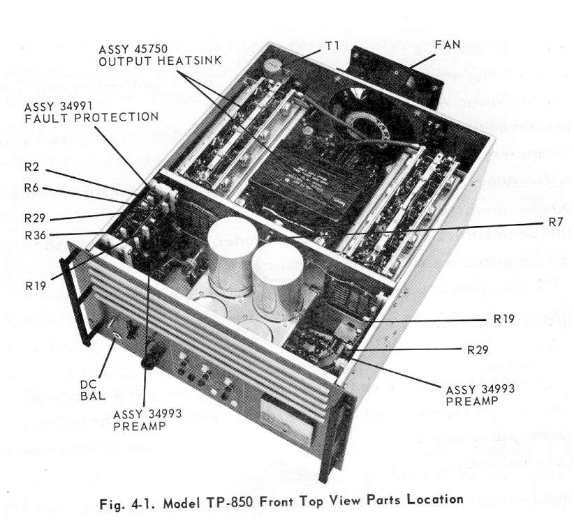

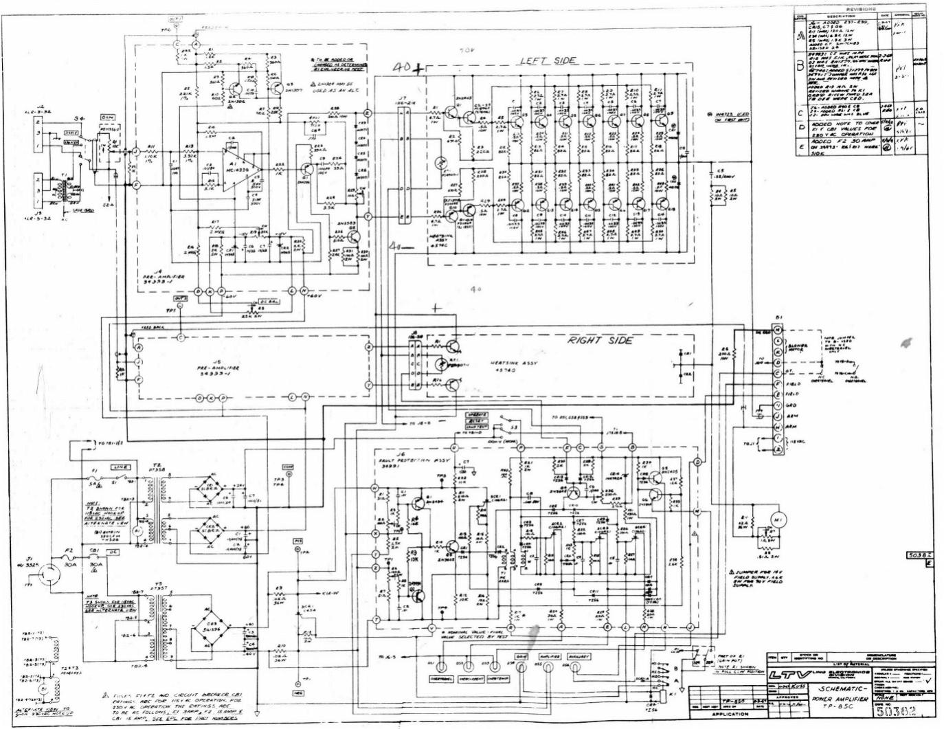

To me it does not look like the rails add when switched.
However, we could be looking at half of a balanced circuit.
An example;
The Ling TP-850 has a balanced output and makes a measly 800W to 1 Ohm from a +/- 40V supply.
