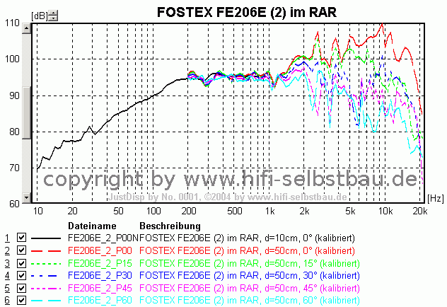

look on my homepage
look the single measurement of a 206 E
than you understand why i constructed the sats:
than you understand why i constructed the Saxophon

The 206e, even if the cone is tamed, it can still be a bit beamy and will dramatically lack upper hf response off axis, even by 10-15 degrees. A phase plug should incrimentally help this trait but will most certainly not "erase" that trait. I tend to use the smaller Fostex drivers in my commercial designs because they have the best HF tone quality and off axis response to my ears. Frankly, it is a matter of personal taste.
