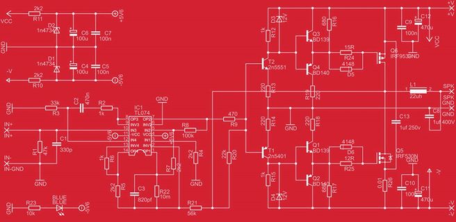

2x65volt dc. voltage .. the output voltage is getting warmer ... 4 ohm when the transistors are warming .. Sound is good but .. What could be the cause? Is it necessary to interrupt the nucleus? For air flow? Is the voltage high? What is the reason ?

As you made the drive-circuit yourself, a reason for heating is likely to be shoot-through effects. Short lasting but high current surges.
Next, the choke sees on one side ground level (without input signal) and on the other side a square wave signal with 130V amplitude changing polarity every 1-5 microsecond. An enormous magnetic cycling of the toroidal core that leaves important magnetic losses.
Solution: For the shoot-through it is difficult to avoid unless you use a monolithic driver or increase the dead-time. For the core - a bigger core with less magnetic losses. Or less supply voltage.

You are using the same amplifier as in the thread ultra simple class d amplifier.
Use just one pair of mosfet and use a gap E core or micrometals T106-2. And u will be fine but i guess bd139/140 heat up badly. In my case it was so.

No, I have not tried the Ultra Simple Class D. I can assure you that doing high frequency push-pull switching with a rather optimal take-over and without significant shoot-through is a science. This is why designers often choose for monolithic drivers.
I have quite a lot of BD139/140. Do you run them at 130V!?

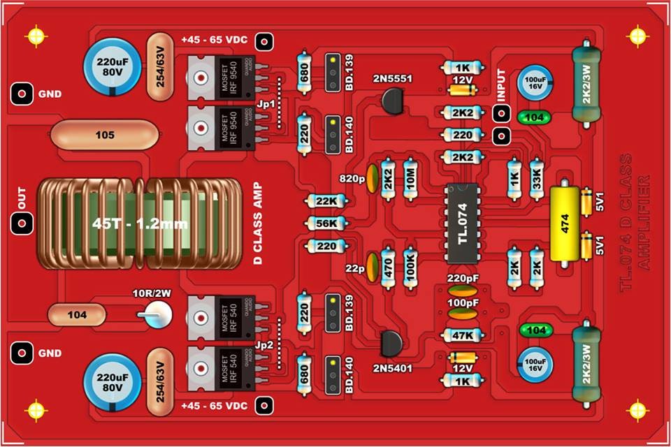

When I asked if you used BD139/140 at 130V, and did not get a reply, I checked your board layout. It seems you are using IRF540. I checked the datasheets from NXP, ST and Fairchild. It should be rated for 100V.
Do you use IRF540 with a +/-65V supply?

This is not my post. And this board is not designed to be used above 50-0-50v dc. So you have your answer.
