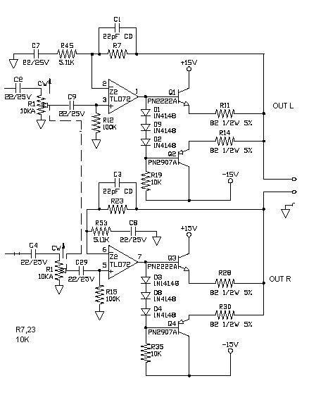

I'm trying to build an audio distribution amp to split a 4v line level audio signal from a car cd player into about 20 outputs- I work in a store selling car audio equipment and need the distribution amp to demo power amps. I remember seeing a schematic here recently with 4 outputs- pretty simple opamp circuit. Would something simple work for as much as 20 outputs?

biff584 said:
Thanks for the replies everyone. Can someone direct me to one of the schematics from TI, national, or some other schematic showing a resistive splitter distrubtion amp?
"some other schematic"
On each output place R=100-150R

Eric, I was going through another thread (the mic preamp one) where somemone mentioned Rane. Playing around their site, I found the following schematic:
http://www.lashen.com/vendors/Rane/da-26.asp
It is down towards the bottom. to my untrained eyes, it shows 6 channels each driven by its own op-amps.
Granted, I am not a sound engineer and haven't seen a distribution amp in person and you seem to be in this profession. but do you know of actual distribution amps using power amp (chip or otherwise) to resistively split the signal? I would love to know.
