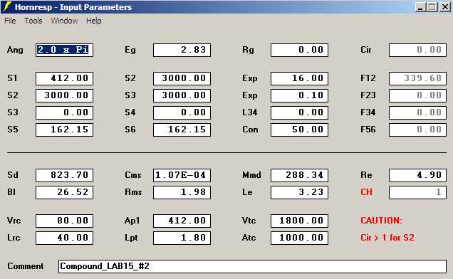

Hi bear,
The LAB15 allows for a smaller BR volume, do you think it would be suitable here?

We can trade:
I saw the pic and read you post, and since you and many others don't provide any data to make a comparison I'll just have to let it go because it really has very little to do with this whole thing except...
The thing is that you assume the yamaha cabinet is built to the same end as the A7. But what makes you think the smaller Yamaha cab actually has the same "problem" as the A7? The A7 does not have what would be normally characterized as a rising response, the horn loading falls off below 300 so basically it is falling response on both sides. So why poo on someone's speakers when we have practically no data that suggests there is an actual problem. Sure they are small and don't go low but that's what subwoofers are for anyhow.
Code:
Insert A7/x hornresp here... ;)
We can trade:
Code:
ID=29.00
Ang=1.0 x Pi
Eg=28.28
Rg=0.01
Fta=33.23
S1=232.26
S2=4548.38
Lec=84.13
F12=79.19
S2=0.00
S3=0.00
L23=0.00
T=1.50
S3=0.00
S4=0.00
L34=0.00
AT=10.68
S4=0.00
S5=0.00
L45=0.00
F45=0.00
Sd=880.00
Bl=27.62
Cms=1.58E-04
Rms=5.04
Mmd=85.19
Le=3.50
Re=10.00
Nd=1
Vrc=15.00
Lrc=15.24
Ap1=232.26
Lpt=1.80
Vtc=2750.00
Atc=993.15
Pmax=100
Xmax=5.0
Comment=JBL 2226J 80Hz JMLC Home Audio
