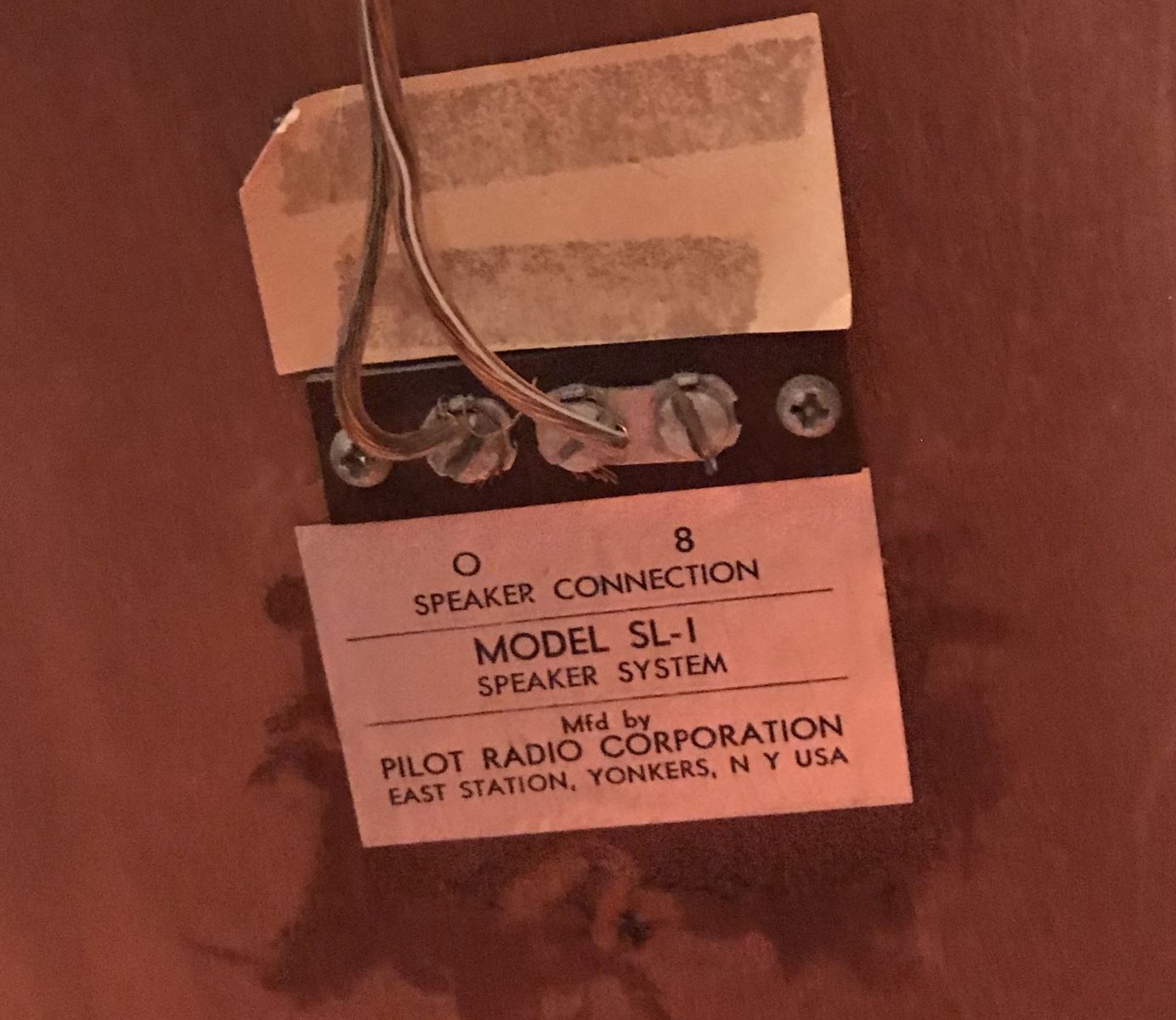

Is this a commercial speaker? If so, which make and model?

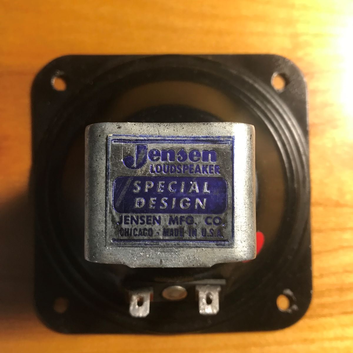

The "tweeters" don't look identical. Could this be two tweeters piggybacking on two midrange drivers?

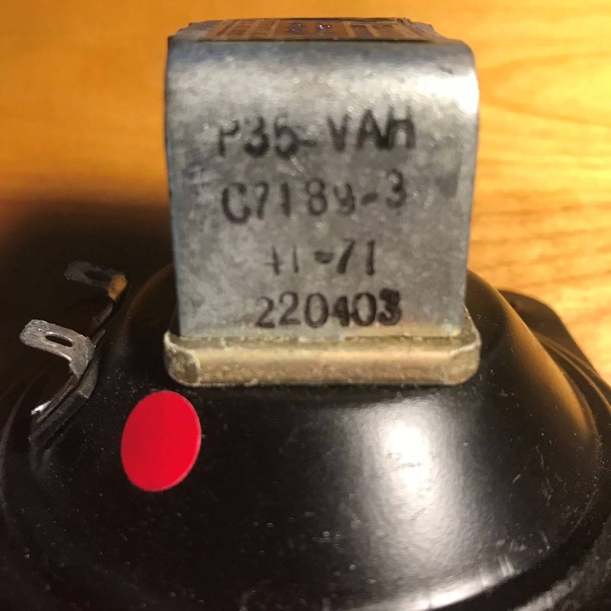

This is incredibly old. No zip code or even Postal Zone (2 digit) on the Pilot Radio address. 67 on one of the tweeters. 22 on another one, probably a replacement. Jensen in Chicago. The wikipedia article on Jensen Electronics has been edited to imbecility, but I imagine Jensen is no longer in Chicago.

The two right tweeters were replaced.

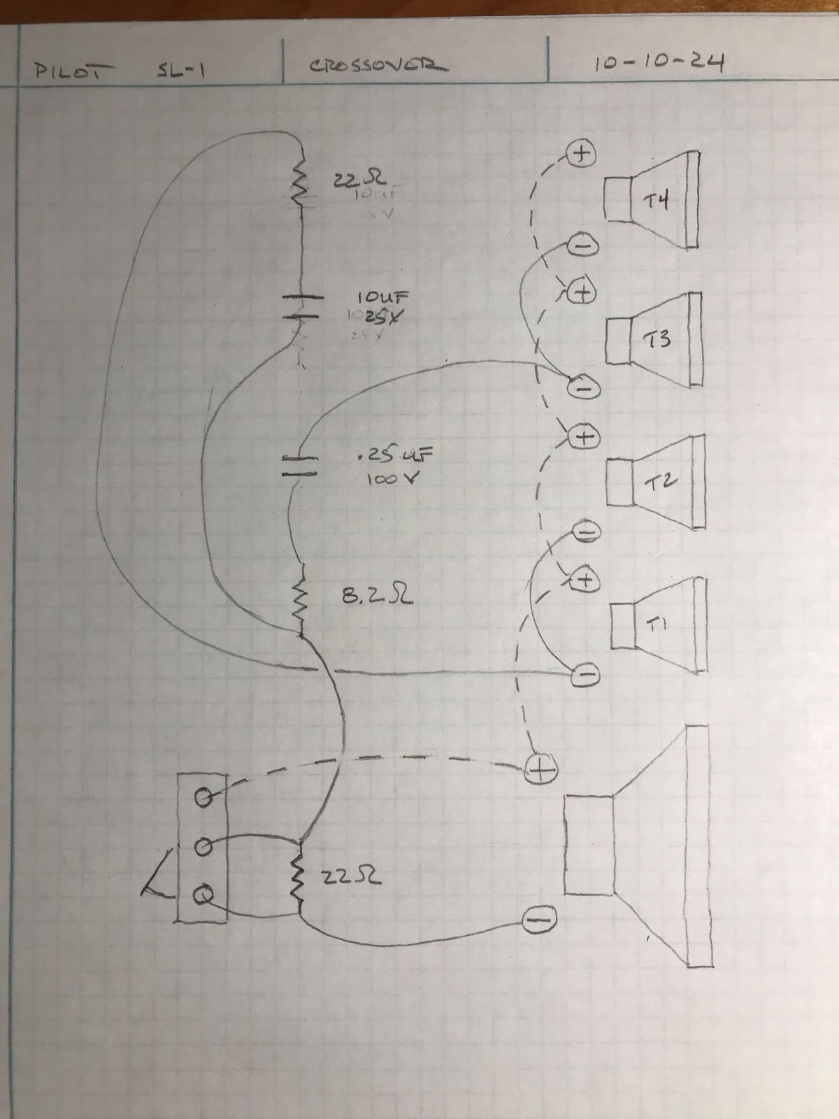

Can you draw up up the XO?I see something interesting. Make sure to include the resistor at the binding posts. It appears to bridge the two + terminals.

All drivers made early in 1964. 🙂
BTW, they are listed as nominal 16 ohm. That’s likely why the parallel wiring.

Drawing the schematic revealed that my assumption was wrong, two of the tweeters are actually wired differently so as @Galu suggested, two of them are likely used as mid-ranges

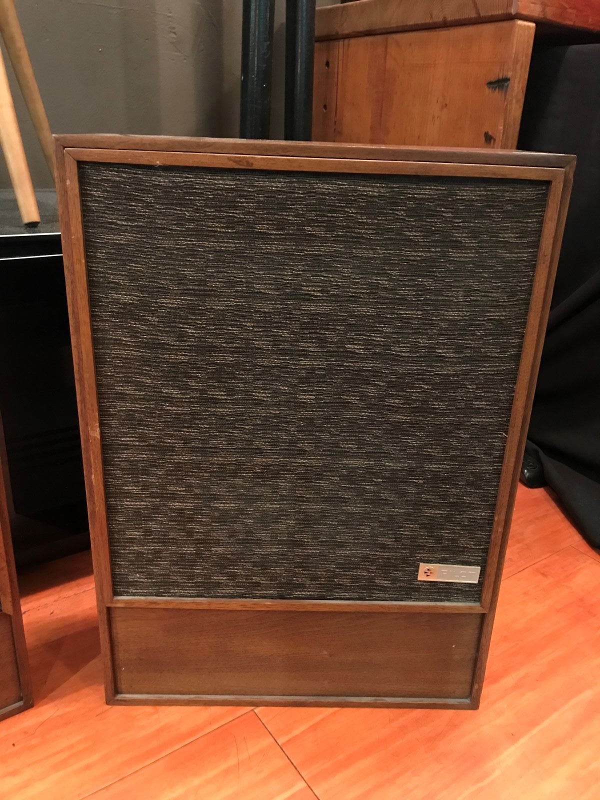

What a funny old speaker >
I would love to hear its sound, even given its ridiculous dispersion characteristics 🙂
First impression was that it did not sound very good, unfortunately, the other has a woofer with an open voice coil and two of the smaller drivers have torn cones. I bought them because I like the cabinets and will restore them.
