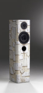

I went ahead and ordered the Vifa WH! Because I found a few posts that stated a little about the sound of it, it was describes as really detailed and transparent, which is exactly what I'm looking for. As for the tweeter I changed my mind, and ordered the Neo3 PDR instead, because I had been looking for a cheap ribbon tweeter that could reach low in the frequencies, and this driver seemed to that very well, also found a Danish review of the driver, in which it was really liked for its detail...
The thing you mentioned with the WH that has to be crossed at 1000, I hope that is not absolutely nessesary, and it doesn't seem to be from what I can see on its diagram, 2000-2200 seemed like a very good frequency for it to be crossed at? Since I intend on using a 12db Linkwitz-Riley passive crossover...
Now what is really bothering be is that I have come to be very interrested in the Dipole speakers. But I can find no beginners tutorial to the subject, answering the most simple questions about the construction... And most of all calculations :0)
Update...
Well after a lot of seaching and wondering, I decided on the Vifa XT18WH and a Neo3PDR ribbon tweeter. Both drivers that seemed to suit my needs perfectly, quick and natural response...
When I recieved the drivers I first mounted them in a friends Carlsson speakers, with a Box Volume of 20 Liters, the results were stunning. An impressive clarity than I was not used to, also the deep bass surprised me. On the D-S-T webpage it states however that the Vifa driver was optimized for 8-14 liter reflex cabinets, so as a compromise I decided on a 15 Liter cabinet, in the hope of even more accurate bass. Also the Carlsson speaker I tested the drivers in had a brace with 3 * 7 cm circle-cuts, therefore I decided to use the same priciple. The Neo3PDR will be mounted in a floating way, suspended by to rubberbands(or O-rings) between the tweeter and two thin sticks that are to be placed on each side of the front panel.
Will be back with more pics, when the project approaches a more completed state...
During construction:
Current status:
And from another angle: (With Cheap Cat protection enabled)
