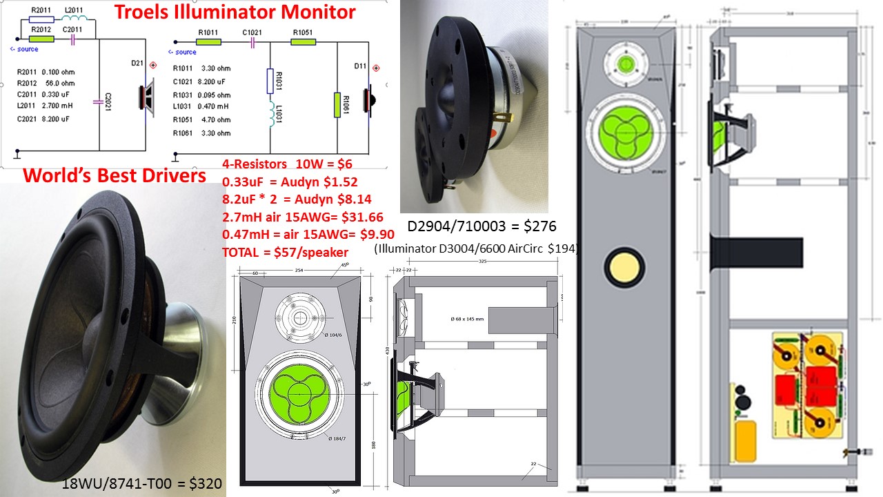

Troels Gravensen's Illuminator Monitor uses the 7" ScanSpeak 18WU/8741T00 driver paired with either 7100 or 6600 tweeters. Troels provides documented crossovers for both an RC delay circuit block, and also LR2 second order circuits. Cabinet construction drawings included.

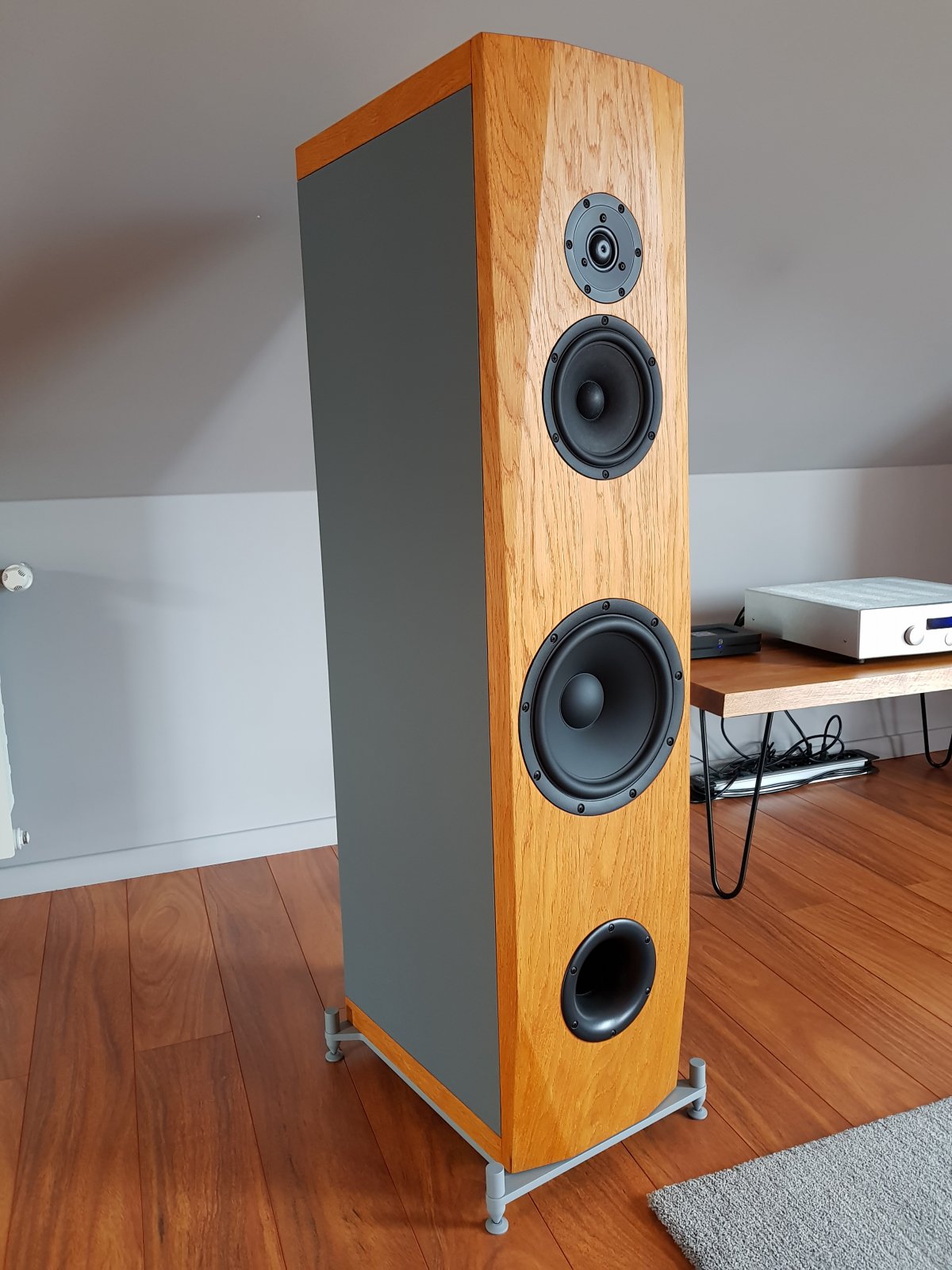

You meant this speaker? I found it on Youtube and it really triggered me to build exactly the same pair for myself..

The Illuminator Monitor LR2/LR2 crossover using "standard" quality parts cost ~$60
If you decide to build a narrow floorstanding speaker, build a 3-way with the 9" Satori woofer.
