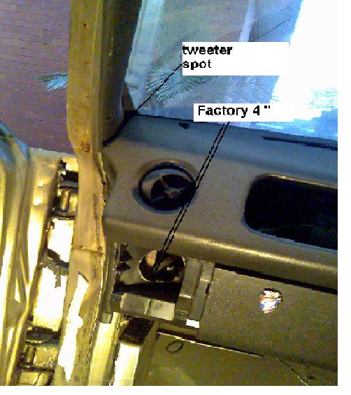

im putting a sound system into my new car and im gona put a component system on the front doors and subs in the boot, i want to know whethere i should MAKE a 2-way component system or a 3-way component system on the doors, even though im also gona have subs in the boot, is it a waste of money for 3 way or is it worth it??

i am looking at the new peerless range, i would prefer a tweeter, a 4inch and a 6inch on the doors wich will be passive and then active a sub in the boot, these drivers fit perfectly but others would fit easily aswell, thx

Yeh but as i mentioned before my car has perfect places to fit a 3 way, wouldnt it be better to put a 3-way in my car??

yeh ill take pics of the locations of the vehicle, as soon as i can, but i want to know what size speakers i should use in a 4-way including a tweeter and a 12 inch subwoofer??... i was thinkin of one of them being an 8 inch but that will like do the same job as the 12 almost so there's no point of putting that, but will the 6 inch go down to like 70 hz?? and wat type of midrange seal back or normal 4 inch or 2.5 inch... after i know these things i can tell u wat drivers i want to use and show parameters and ask for recomended x-over points.

3 way in door where all sound is coming from same spot thinking 6,4,tweet?
i say NO WAY MAN!!!
1st you would have to build a passive network deviding the frequincies correctley NOT because it is fun to have each speaker have less work to do, that is NOT THE REASON, the reason is you want a divided network to make all speakers play in seprate range so no 2 or more speakers play same thing below 4 ohms,
For example if you had 2 4ohm subs in parrell the amp would see lets say 1 ohm (it is really LIKE 1.36 but nevermind that)
BUT if one sub was crossed over from 0 to 50 hz and other sub was 50hz and up the impeadiance would stay at 4 ohms, i hope you catching on. so 3 way on highs are good if you plan on running the 6 inch speaker down below 50Hz, i mean you need a ton of power and the 6inch must be in a sealed enclousure to be able to do it. if you do do 3 way i would build a custom X over using Polyproplene caps and air core inductiors. go 12db on the tweet at around 4500hz (but check the impeadance curve 1st dont want to rolla speaker off in a high impeadance band that is a no no)
for shure 6db bandpass on the 4 inch and 6 db low pass on the 6 inch, run the 6 inch 6db low pass to around 300hz run the 4 inch 6db highpass at 600hz ( 1 oactave seperation on 6db junction to have a -3db at 1/2 oactave of 300 and 1/2 suboactave of 600 to make bolth speakers nominal impeadiance stay at 4ohms) run the 4 inch lowpass 6db to at about 1.3kHz it will slowly roll off and will give a small rise in impediance around 3kHz witch is a good thing, If you have 30 band eq you notice that 3kHz sounds like poo poo..
OK that is a 3 way setup done right...it is better if tweet and mid are in dash close to eachother and midbass in kick or door to apply a 3 way really really efficatavly.
But the easiest way to achieve the same or most time BETTER sound is just keep it simple do a 2 way...serious it sounds better most of the time. make shure to build a sealed enclousure for midbass and just dont be afraid to put massive amounts of power on your highs...

i tottaly understand what ure sayiing, and thats wat i plan 2 do, the only reason im doing 3-way instead of 2-way is because i got the space in the dash, and 3 way will sound better ofcourse, except i plan to make my 6.5" go down to 80(not 50) and if i wanted to y cant i put the 6,4,twt on the door together????????????????????????????????????????????????????????????????????????????????????????????????

well you could put the 6,4,1 in the door but if all speakers are close together and crossed over correctley the load will remain 4 ohms so that being said, it would have the same amount of output as just having a good single driver capable of playing the entire bandwith.
If olny one speaker is blaynig band with than the phase carickteristicks
are much moore desireable. But if you have a dash location i say use it put the mid and tweet right next to eachother so it will image good. Your goona loose some of the sweetspot because you will have a dash speaker very close to your left ear (if your the driver of car) so arrival times will be kinda screwey but in return you will have a very high and very realistic soundstage.
I mean i am talking about a front speaker system being driven off a single two channel amp for all front speakers.
If you are using mutipale amps for the front than that is a entirely diffrent critter and everything i stated earlier wouldnt apply because you now dealing with mutipale electronic X-overs and stuff....
But IMO a very big ( at least 100w X2 @4ohm RMS rating ) just for front speakers is the best choice for a simple but very effective system.

so your telling me 3-way is a waste of money cayz my 6 inch will just go to 4k or wateva anyways!!
yes, basicly,
You just gotta use your best judgement on what will look the best and sound the best, good experiance or advice can help allot too but if your the one doing it than hey.. you know what you want...
there was one car i did where there was a black hole @ 400 HZ so bad even if i boosted 400hz on eq all the way up , i was fighting distrutiave interfariance soo bad..there was a 6 and a tweet in door. i added a 4 inch in door with the other speakers but it had its own amp and olny played 400Hz, i had it crossed over at 400Hz 12db highpass electronicly and 6db passive low pass at 400Hz, that 4 inch speaker was in a sealed enclousure as well. and that fixed my 400Hz black hole enough , I could have just mooved the placement of the 6 inch so 400Hz wasnt canceling at driver head area but than i would have had to re-do the entire door and pannel. i didnt want to have to do it just for a few db at a specific frequencie... do you see what i mean.
but in prior practices, a 6 and a 1 inch sounds great, if youu have a dash location to utilise than use it you will like the way it sounds..

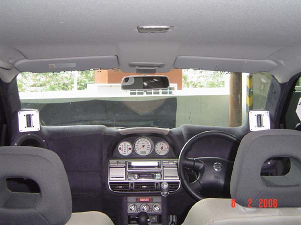

by looking at pic, what about making some fglass kicks for a 4 and tweet and than just do a 8 or 6 in each door?
y make another enclosure wich will take up more room, were i can just put the 4 inch in the already made enclosure!!!
