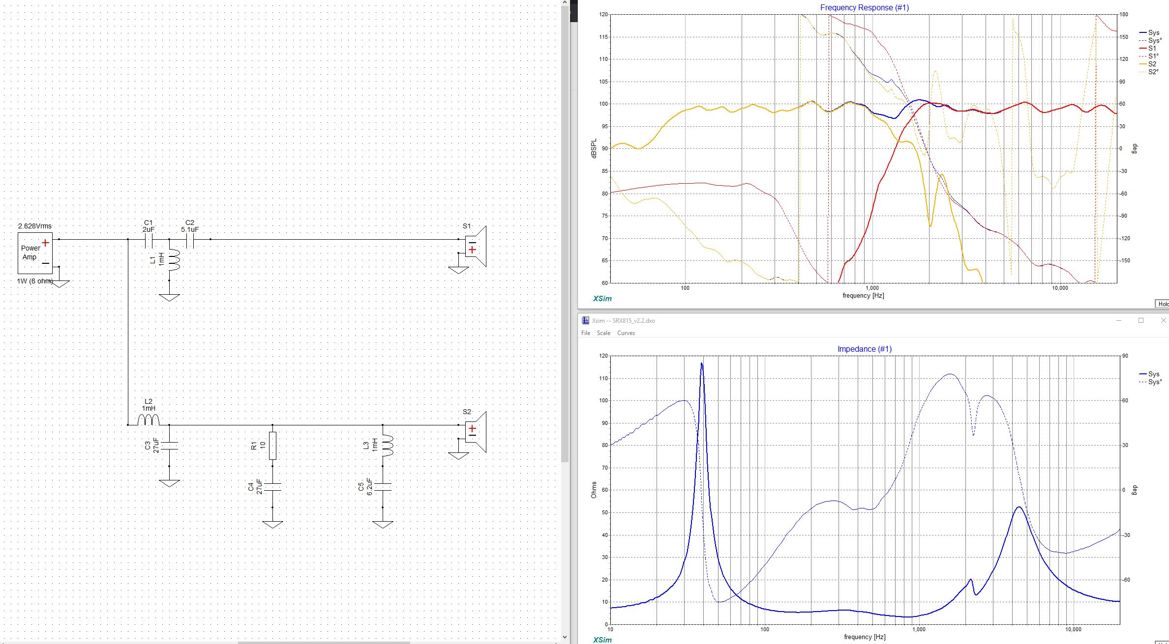

I'm trying to build 2-way speakers for my small band.
Since I'm new to this world, I wanted your professional review on my crossover design before I buy the parts and build it.
Not sure which details I should provide you, But I hope that the pictures attached will say everything.

There's alot of stuff needing to be addressed with your crossover.
What's the reasoning behind R9, C7 and R1? Having a 3 ohm resistor in line with the woofer doesn't make any sense. How did you come up with that crossover design? That massive 1 ohm impedance dip is going to cause amplifier problems. That's likely caused by the L4 in the HP, which shouldn't be that small crossing over at 2k.
The selenium D220 doesn't need much response shaping in the midband, unless you use it on a weird type of waveguide. The woofer doesnt really need much filtering since it already falls off sharply at 2k, maybe just needs a zobel and a larger inductor for BSC.

Thanks for your detailed reply.
Please let me try to explain (to the best of my knowledge...)
R9 and C9 - reduced the very high jump on the Imp. together with them, I got "flat" Imp not higher than 8 Ohm. Isn't that what's needed? I really don't know...
R1 - reduced the F3 to be flat. without this resistor I got higher response at the lower freq.
1 Ohm Imp dip - Correct. it is caused by L4. Should I add series resistor to that?
I'll appreciate it if someone could draw the parts needed to get a good cross-over design and Ill do the tuning.
I'm familiar with this work but definitely want to build things with my own hands. I used the same drivers since I think this will fit my app.

I'm sorry for being somewhat rude, but if you would know how to tune a crossover, you would know how to design one. And from the first attachments, I doubt if you do so. Look at the impedance drop at 2k, your amp will like that 😉.
Really, do yourself a favor, build a known design with a know crossover. Or start from scratch, throw simulation apps away and go read about speaker and crossover design. Would you fly a plane without practice and qualifications?

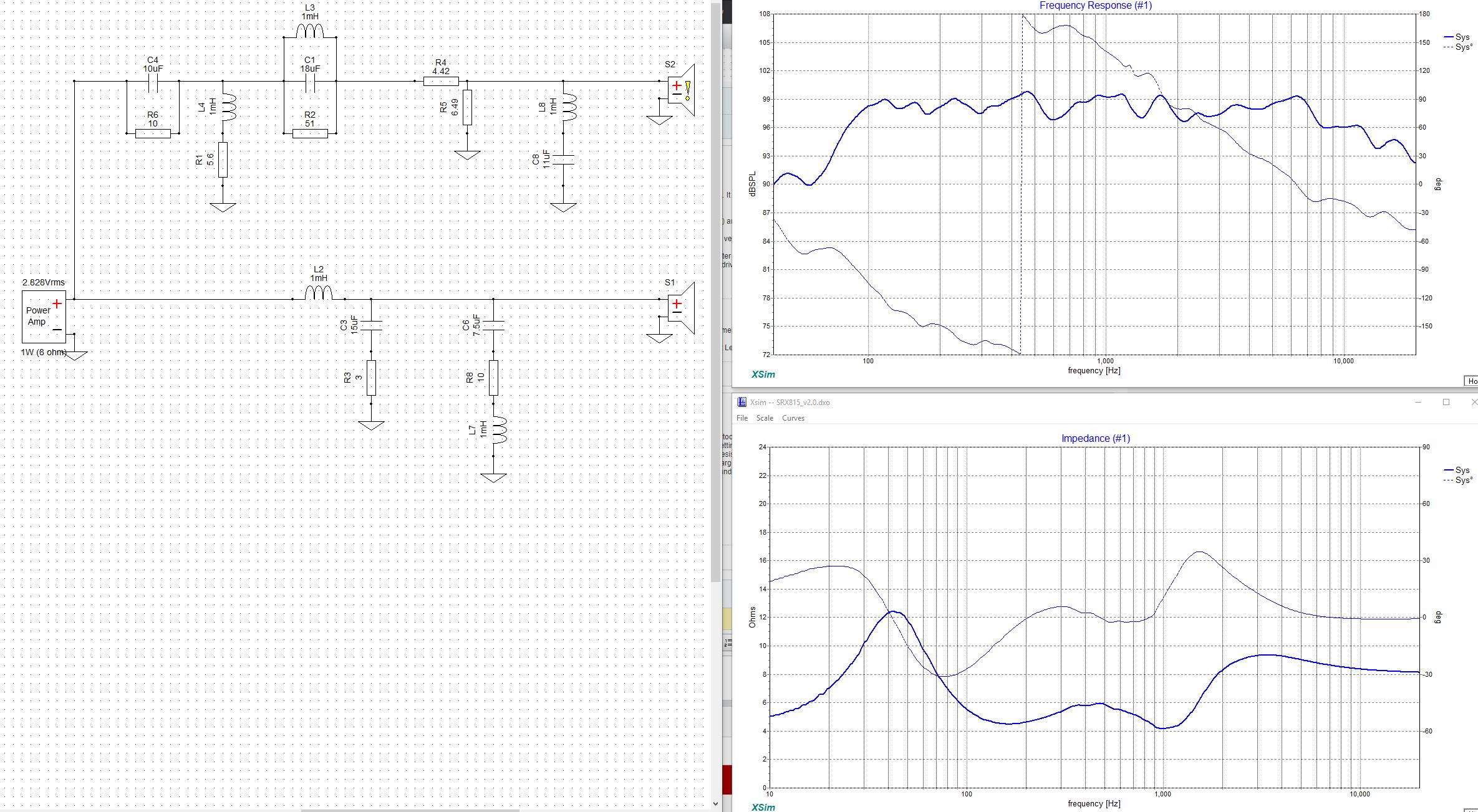

I do appreciate every comment.
Just to explain, I'm an HW ee. eng. working for many years in the industry of high-speed designs. Unfortunately never dealt with audio. but, ... I do like to do things with my own hands and understand everything I do.
Hence, I took your advices above and come up with two new options which differ by their impedance response. [see attached files]
It would be great to get your comments.
