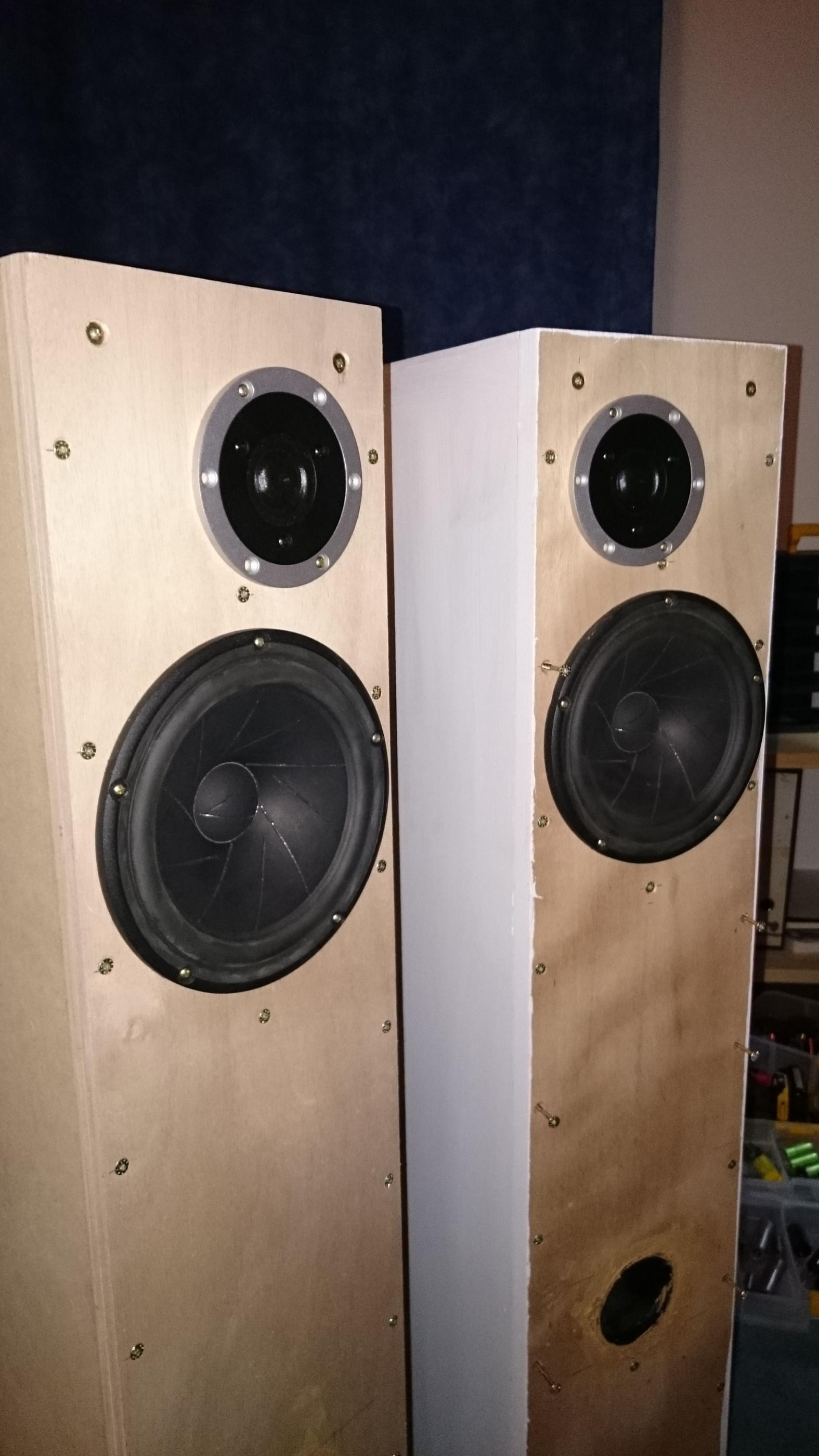

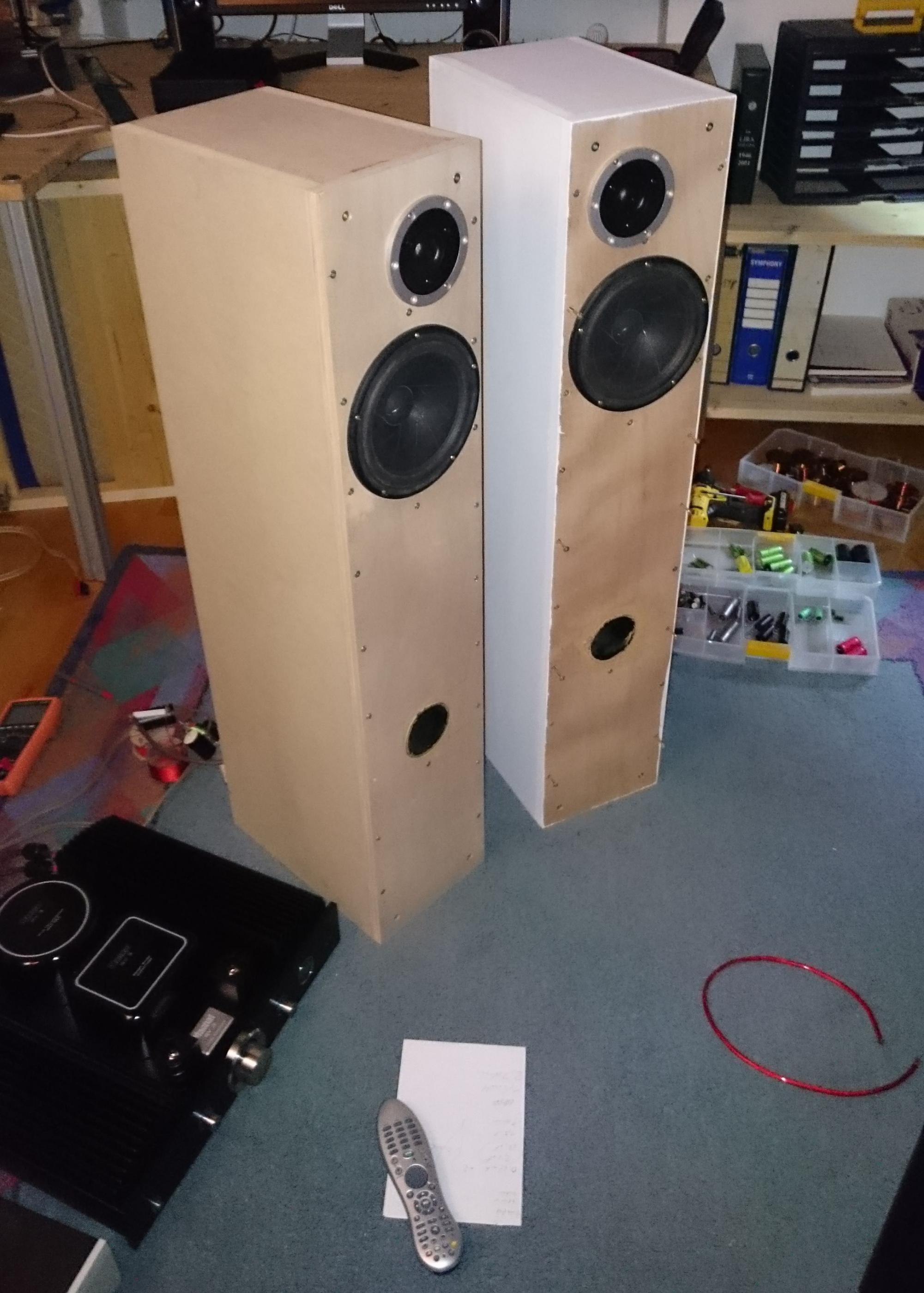

Hello, i started a new 2Way project for my home hifi.
My passion started in the car hifi field. Now i have a pair of Scan Speak 18W/4531-G00 that i used in my old car.
So i decided that it is time to build a new speaker for my home.
After looking for many projects with this driver and consulting a user of this form i decided to use a 35l bassreflex cabinet.
For the tweeter i used the sb acoustics satori.
Both drivers are 4 ohm drivers.
Currently i'am trying to get out the best result by optimizing the crossover.
But already now iam very pleased with the result 😎

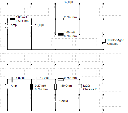

Corssover at the moment is 12db low pass for the woofer and 18db high pass for the tweeter. It was developed by measuring, trying a lot of different components, hearing and simulating. I dont know if its the best but its sound good to me, waiting for some comments 😉 thanks

Why the series RCL network, the Revelator does absolutely fine without it, just use a higher value inductor ( to try it you can drop an iron nut in the gap of the coil ). The tweeter has a parallel RC, for what reason have you used it?

You should try/simulate with a higher value inductor and no serie RLC.
Something around 2.2 / 2.5 mH depending how much BSC you like.

For a 2.5Khz crossover frequency a 1.35mH is enough, for a LR2 function a 8.2uF cap suits well. There is a very slight midrange shout of the Revelator in the upper midrange, the proposed value above would clear it but some people like the sound when the driver is left shouting, its midrange is mellow. If you want it this way, the inductor can be dropped to about 1.2mH.
The 1.5R /1.5uF is a pretty pointless idea.
Lack of any real tweeter attenuation indicates you don't understand BSC.

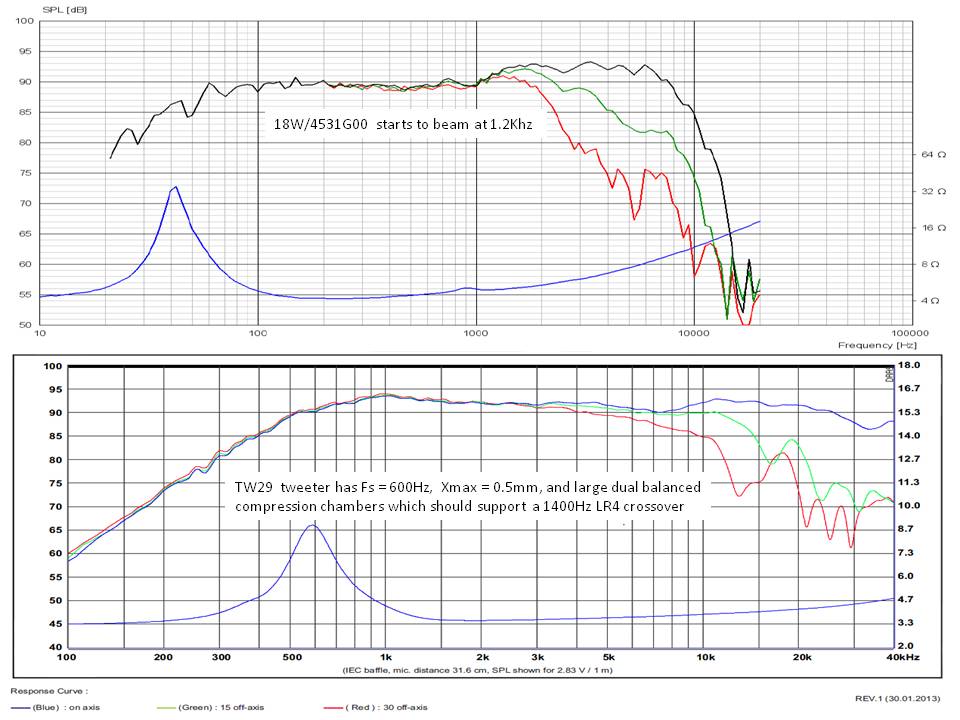

Daniel,
From just looking over the datasheets:
The 18W/4531G00 starts to beam and experience early cone resonances around 1.2Khz.
The TW29 tweeter has Fs = 600Hz and Xmax = 0.5mm, which should support a 1,400Hz LR4 crossover.
Have you simulated symmetric LR4 acoustic slope Xovers at 1.4-1.6Khz?
Do you plan to specify some speaker toe-in to manage beaming if you use a higher Xover frequency and lower slope?
You are using a flat baffle... not stepped... not sloped... so the crossover must handle the poor time alignment artifacts. Using slightly different Xover frequencies with a symmetric acoustic LR4 partially masks audible artifacts from poor time alignment over a narrow LR4 span. There are driver offset spreadsheets on the web.

Anyway, Daniel, I think that unless you have measurement equipment, you should learn to use a program like passive crossover designer to see what these components are actually doing. Real measurements are better of course but simulations are at least a step in the right direction. You likely won't get the best results by ear alone.

I will try it without the rcl network and increasing a little bit the inductor for the low pass.
pguerin: its a 4ohm woofer, the idunn has a 8 ohm woofer, therefore the values you proposed dont fit my design.
linesource: i havent simulated such a low corssover point, i will try it in the next days.
I used Boxsim to simulate the crossover and i measured the frequency response with a calibrated mic.
i will try the proposed changes, thanks to all 🙂

Is it that bad? 😕i tend to look at the 15 degree off axis and where that starts to really drop off.

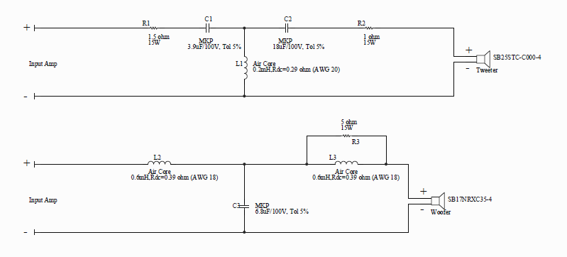

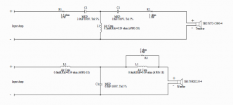

Here's a point of departure you might find useful, the SB acoustics EKA design for similar low inductance 4 ohm drivers:
SB Acoustics :: Eka
You must lose your 1.5R+1.5uF shunt on the tweeter. I don't know what you feel it does, but it will take impedance uncomfortably low for a solid state amp, being near a short at HF. That 33uF of yours doesn't seem to do much with a 2.7R resistor either.

So I think the very basic layout is about right here. You can use some of your current values too. But some component values change with crossover frequency and attenuation of course. Hope it helps.

Eliminated the RC on the tweeter. I will make some frequency measurements in the next days and also try some of the hints. thanks
