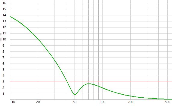

I get the same values as Ugg10. With 10W you get 100 dB, but Xmax (3 mm) will be exceeded below 40 Hz (see attachment). You'll need a sub if you want a lot of low bass, but that's true of a lot of 6.5 in drivers.

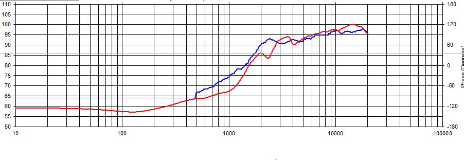

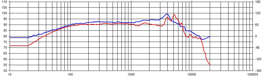

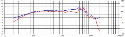

As I mentioned in the previous thread I did find the FR and impedance graphs from Monacor. I converted them to .frd and .zma files and compared them to the files you provided. The woofer files match quite nicely except the Monacor file is about 2 dB higher than yours. The tweeter files don't match up as well, particularly at about 1250 Hz where the Monacor file shows a peak and your file shows a dip. Here are the two comparisons, Monacor files are in blue and your files are in red.
And here are the Monacor .frd and .zma files. IMO the Monacor tweeter file is a more typical infinite baffle response than the file you provided, but that's just my opinion.
Don -
Yes, you can't get phase information from converting graphs. My plan is to add baffle step & diffraction effects (since we have cab dimensions and speaker positions), add high and low tails and then create minimum phase versions which will have the phase information. I also have a good estimate of the z-axis value which is the last item needed for the simulation.
