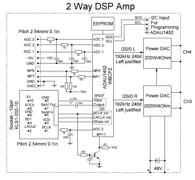

The structural diagram of the dual-channel 200W PWM DAC with ADAU1452 chip is shown below.

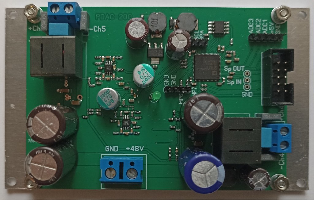

The board looks like this.

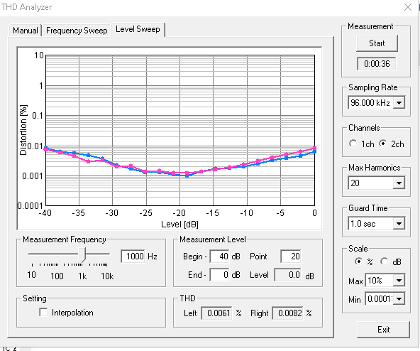

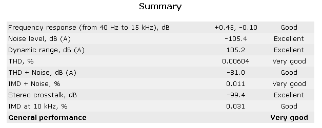

Measurement results, R load=4R, Vcc=48V.
Performance parameter PWM DAC:
- Output power: 200 W per channel, with a 48 V supply and R load = 4 Ohms.

- THD: less than 0.005% on 8Ohm load, and less than 0.008% on 4Ohm load
- SNR: 105dB(A)

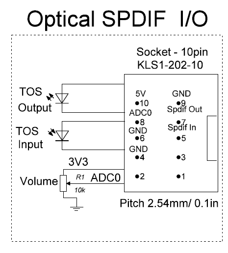

The board is compatible with input/output boards that also have a volume control potentiometer.
Board with coaxial input + $10.
Board with optical input without ESP32 + $10.
Board with optical input and ESP32 + $15.
More information on using the ESP32 input board can be found here in post number 10.

I don't make ADC input boards, I haven't used analog audio outputs for a long time.Any board with analog input (which ADC?)? or only digital input?
If you need an analog input to this board, the board has an I2S input to which it is very easy to connect any ADC with an I2S output. For example, here is an ADC with an I2S output.

The board size is 100mm by 70mm. The heat-conducting plate size is 120mm by 72mm.what is the size of the PCB, and what is the size of the mounting plate?
