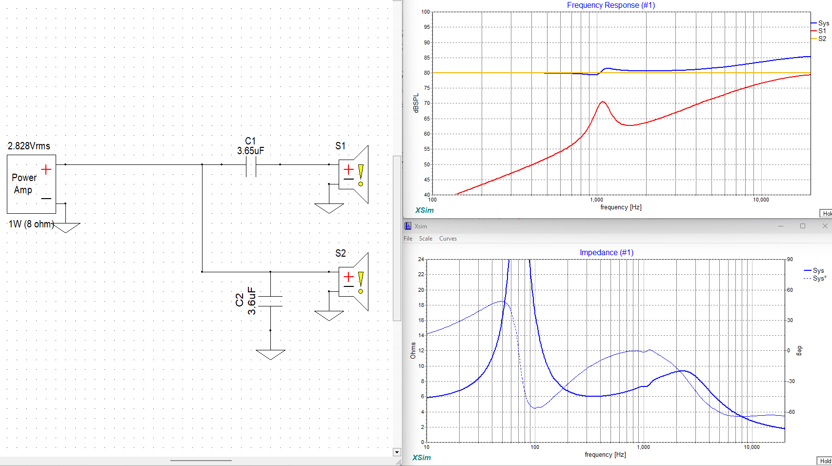

Here's a quick XSim model of what I think you're asking about. This used impedance files I had handy, but I left the frequency responses flat so the filter action is more obvious. A simulator is handy to get a feel for what things do in-circuit, and there are free and easy-to-use options out there now.

Capacitors are cheaper than big inductors. The Peavey SP4-XT crossover has a 33 uf cap parallel the 2 1508-8HESF woofers. I don't know if the woofers are in series or parallel, but the -8 typically means 8 ohm impedance. The RX22 tweeter has a 2.5 uf series the tweeter and a 350 uH parallel the tweeter behind the cap. 350 uH is a cheap inductor. I believe SP4-XT is rated at 4 ohms. Another SP4 is rated 4 ohms with 3.2 ohm minimum.With nothing else in the woofer leg, the capacitor in parallel there will also drag the impedance down at high frequencies, which you don't typically want.
That's a short at high frequencies...you'll break many amplifiers with that circuit.
The amplifier is a voltage source, so the capacitor across the amp output terminals does nothing for the crossover.
Some amplifiers could have stability problems as well.
Bands that buy a 113 lb 1000 w continuous rated Peavey SP4-XT do not IMHO produce much high frequency output.That's a short at high frequencies...you'll break many amplifiers with that circuit.

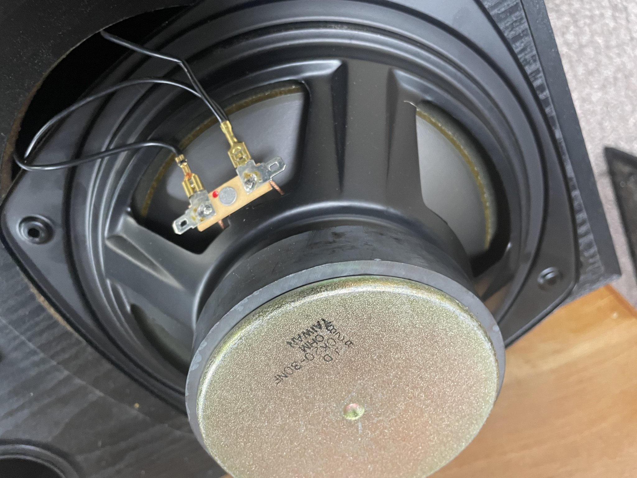

Update, there are a couple of flag terminals series the woofers before the 33 uF cap that says "1.6 mH"

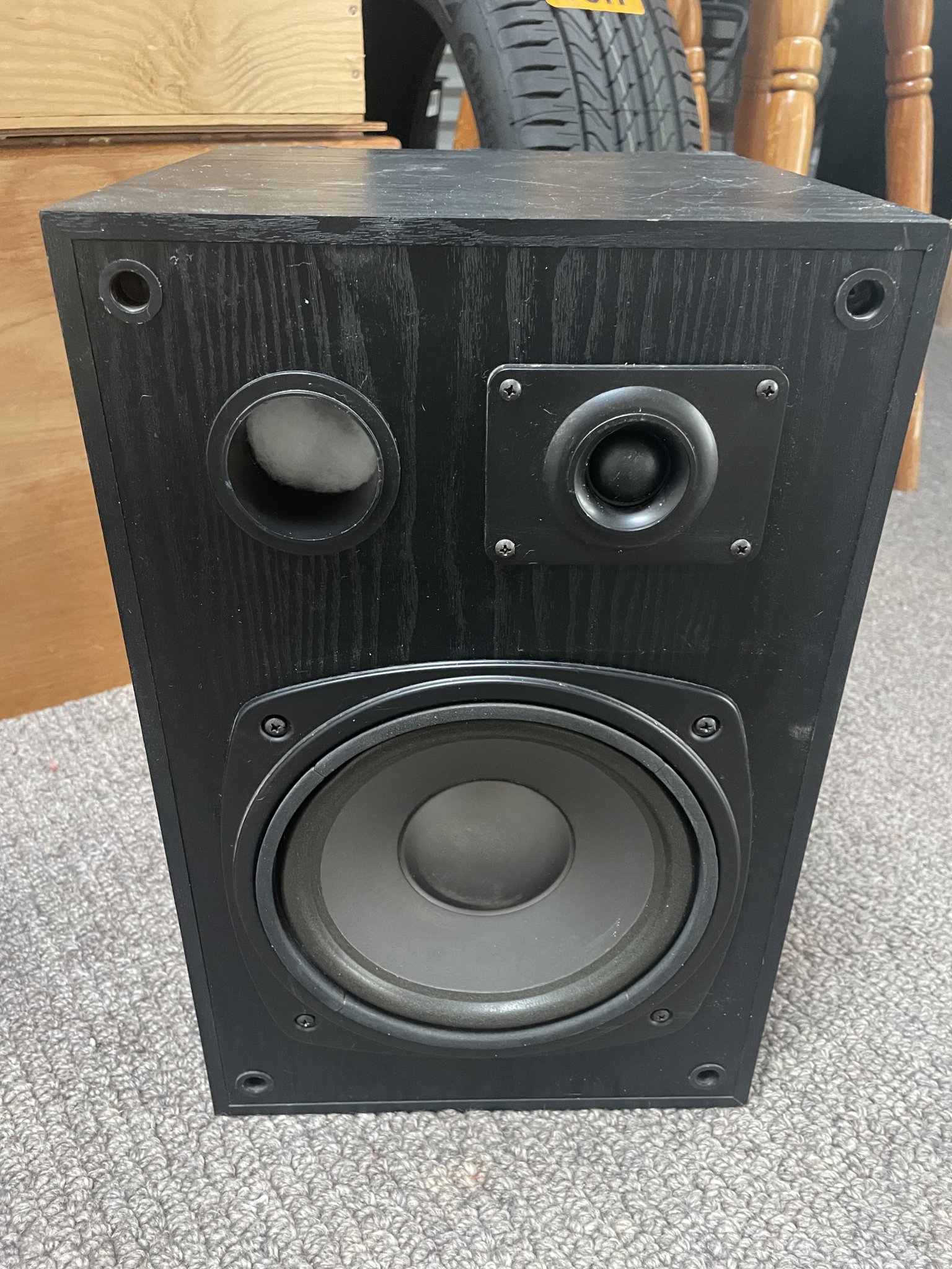

The reason I asked, I took a gamble on these speakers for not much money, labelled as scandinavian but clearly not. I’ll probably just use them for testing with faulty amps but as they currently only have a single 2.2uF cap in series with the tweeter I thought I’d do some experimenting with a crossover to see how much difference it makes.
I have quite a few audio grade caps (hence the question), but no inductors and no local supplier so I’ll order one online.
I’ll try a simple second order and can work out the values of the components, but interested in suggestions as the what frequency to target for the cutover.
The current 2.2uF equates to somewhere up around 13kHz depending what I assume for the R value, but typically a two way is between 3-6kHz isn’t it? I was thinking of aiming around 5kHz for this one.
Of course it’s all complete guesswork, I know nothing about the drivers, suitability of the enclosure etc but I’m not expecting too much from the end product. Just want an educated guess.

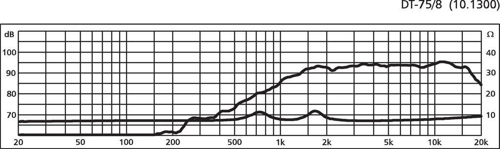

I would base the calculations on the nominal impedance rather than the DC resistance of the voice coil.
The similar Monacor DT75/8 dome tweeter has an impedance that varies little from its nominal 8 ohm value over its operating frequency range of 3,000 Hz to 20,000 Hz
Its crossover has to be no lower than 3,000 Hz with a second order (12 dB/octave) crossover.
4,000 Hz is a good compromise in your case.
