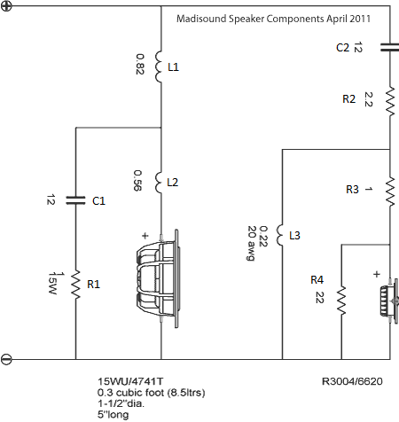

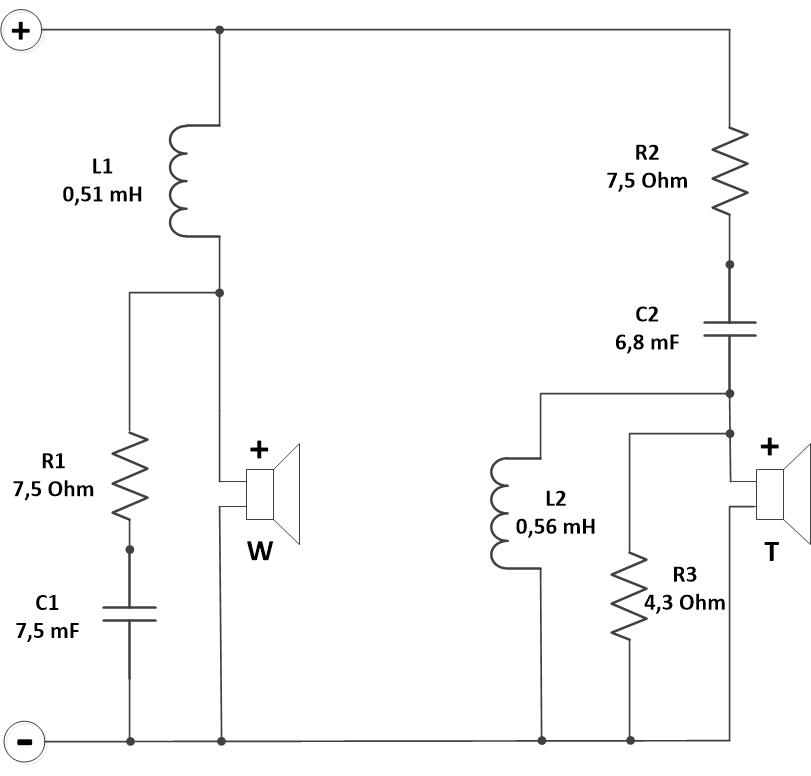

Hi to all. I am very new in DIY, but decided to make Scanspeak Lumine, as heard it at Youtube and was impressed by their clear sound. But as i already have 8-ohm tweeters (the ones from Sony ss-g55, 8 ohm, biocellulose), and decided to use 8-ohm version of SS 15WU8741T00, instead of 4-ohm 15WU4741T00 (mainly to avoid different impedance of tweeter and woofer). It seems that it will be something very different from the Lumine, but I hope that the woofer will give a good quality sound. Followed instructions in "Introduction to designing crossovers without measurement " thread, and made calculations, so I ended with the crossover shown. Can someone explain what is the role of R3 and L2 in the original Lumine crossover, and give advice on this crossover in general? Thanks in advance.

R3 and L2, along with the drivers form the second branch of the respective filters, increasing order to three. What you've drawn do not use further branching and are therefore just second order filters. You have also forgotten to invert one of the drivers to compensate for the 180* phase shift between them.

Well, try changing 22(R4) in the original circuit to a higher value around 40. It's more or less the same curve, only with 6 ohms (vs 8).

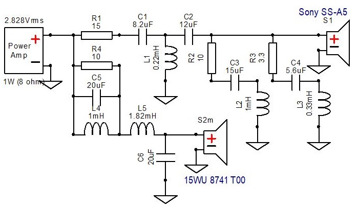

I use regular SPICE to verify filters and networks but you may want something else that simulates loudspeakers properly. Try VituixCAD maybe.
