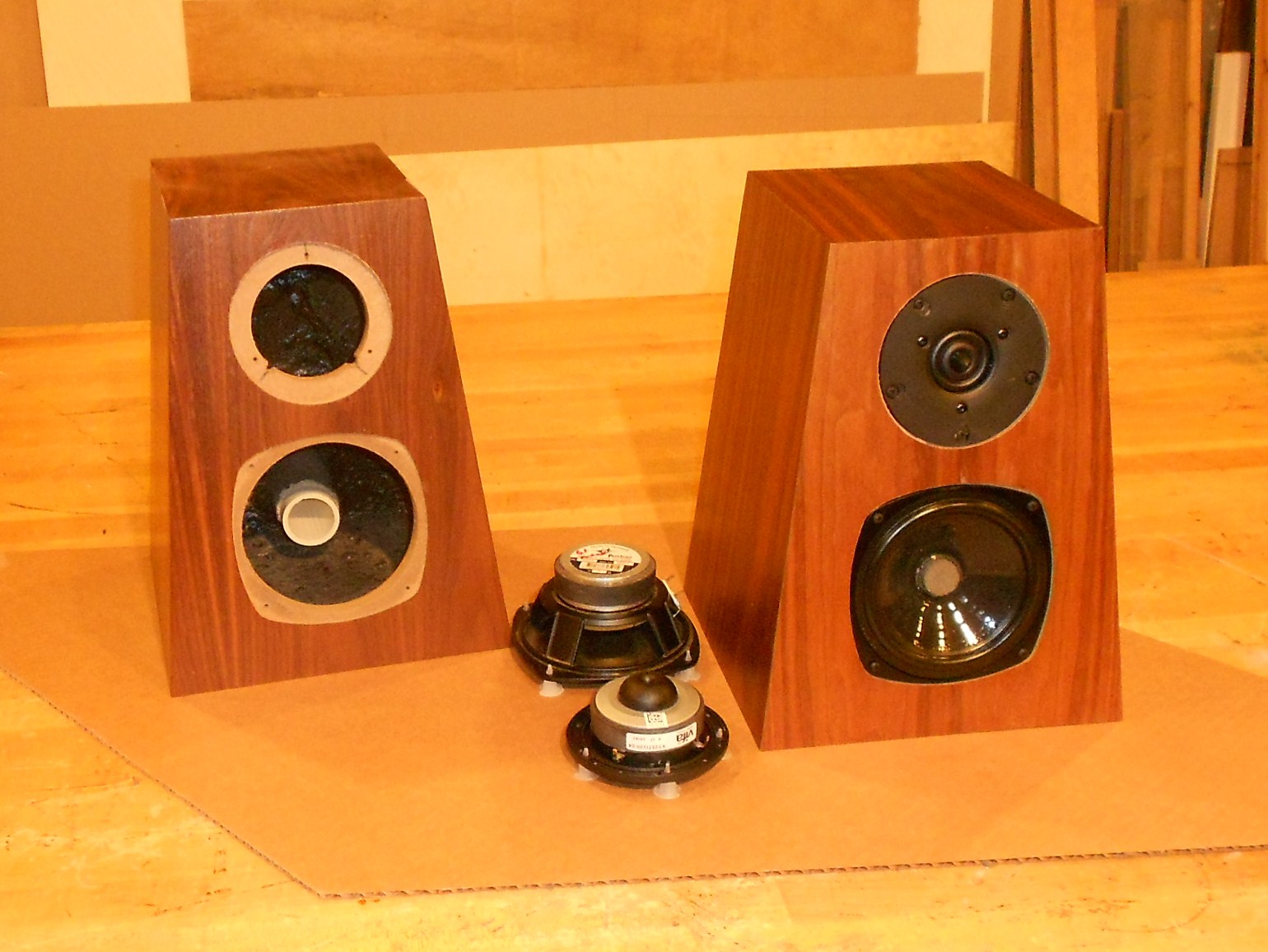

Here is a project that never got off the ground; although bought some Vifa ring tweeters recently and think this will work nicely with a proper crossover.
Woofer is Peerless 832591, 4ohm (old but never used and have a couple of backups).
Vifa ring XT25TG30-04 tweeter
Vifa XT25TG30-04 1" Dual Ring Radiator Tweeter 264-1016
The box is 1/3 cf and tuned as recommend.
We built several similar boxes with Morel MDT30s, 6db, .69mh coil, 3.3cap and L pad; 3.3 seems low, but it did crossover well at 1500hz-2000hz.
Woodworker here, could build crossover with design/plans.
Any ideas?
Any ideas?

The little woofers have great bass for 5.25". The dust cap were removed and foam plugs were glued on the pole (magic tricks).
The boxes were lined with layers of spay glue and sand - thick!

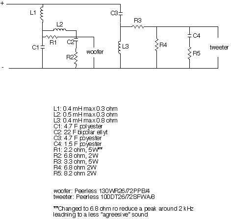

Love the tweeters! Using one in a center channel now. I pretty sure it would need a 12db roll off, that's what Madisound did with the HDS kit. (Pic)

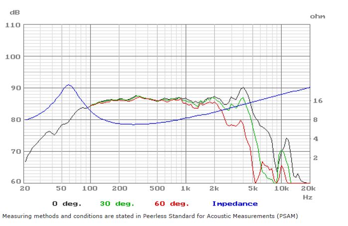

So far I have worked out this is a polycone with a highish inductance similar to the 8 ohm version known as a Peerless 832592. Seems to rolloff naturally around 4kHz with a bit of a peak there. Qts around 0.4 and VAS around 11 litres. Le of 8 ohm version is 1.1mH, which means this one could be 0.55mH to 1.1mH.
Best you can do is add a coil to the woofer, around voicecoil inductance in value, and wire and pad the tweeter out of phase on a second order, maybe 3.3uF or 4.7uF and 0.2mH. You'll need to do some work padding the Vifa tweeter itself too, since it's only 3 ohms Re. This gives you a good chance of some reasonable phase alignment, even if you get a lot of woofer cone breakup coming through.

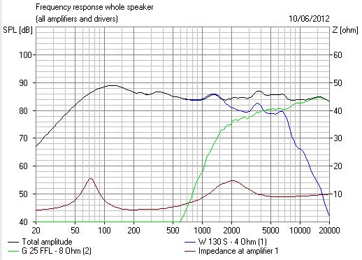

Might be a good place to start or sim from, from a swedish kit.
But then again not, doesn't look like it has much baffle step,
I don't like the 2.2R in series with the bass mid, that might
be there to boom up the bass due to the lack of BSC.
Here is the 8 ohm version :
http://www.parts-express.com/pdf/297-622.pdf
rgds, sreten.

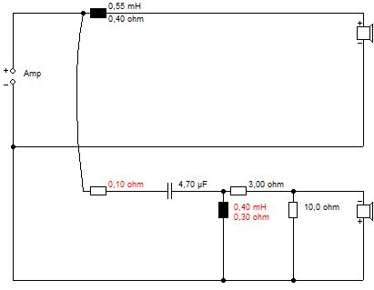

I'd GUESS looking at Thomas Akerlund's circuit there, that the 4 ohm peerless has Le of 0.55mH...
So this looks reasonable to me as a start:
The 0.1 ohm resistor is adjustable for tweeter level. The 0.55mH coil will mean there isn't much bafflestep correction, so these are best placed by a wall. Think that agrees with Jerome69's ideas too. Really can't say how bad the woofer peaks are going to sound, or exactly how to tame them. But this circuit is non-critical and has good phase alignment from 2kHz to 10kHz.

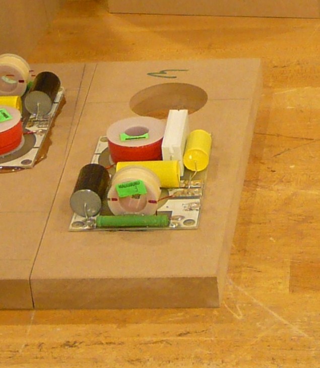

System 7 I think I have enough parts to build this.
I do have a question about the woofer, the coil is in series - what about the .4ohm resistor?
DCR...hummm??
I did find a pair of odd coils and made a pair of matching .56mh coils
Just don't ask how it works :-/
My chart came in handy 😀

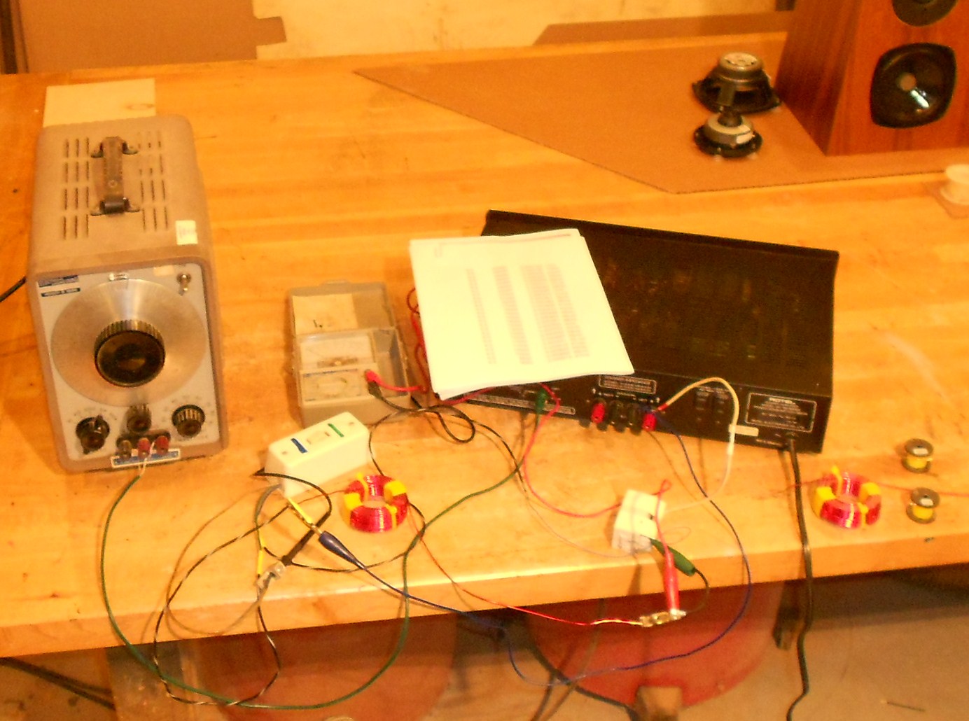

How to measure the coil with a generator...
I think I have most of the parts, may need to stop Radio Shack for resistors.
Don't know how to add the .40 resistor next to the coil (tweeter also).
My guess is that they are wired like a BSC (shunt the coil).
I have the coils and the caps (nice) and the 10ohm resistors.
Need the smaller resistors.
As you can see, it is more important to look clever at this forum, than to explain yourself clearly. 😉
None of the values in this circuit are actually critical. The coils/inductors have standard DC resistance (aka DCR to the initiated...) due to copper windings of several metres. Any air coil will be close to these (0.3 or 0.4 ohm) resistances. Ferrite coils will be better, but not usually used in tweeter positions.
The top woofer coil can be 0.4-0.7mH, the tweeter coil 0.4-0.7mH. The capacitor can be 3.3 or 4.7 uF non-polar or polycap. The 10 ohm can be 8.2 ohm. The 3 ohm anything between 2 and 4 ohm for test purposes. You are going to set tweeter level with the 0.1 ohm resistor later, which is a place marker, not a value.
Bit meaningless to talk about rolloff. Ultimately it's 24dB for the woofer. This is really a first order circuit with a bit of protection added to the tweeter by the 0.4mH coil at it's Fs resonance which is about 900Hz I'd guess.

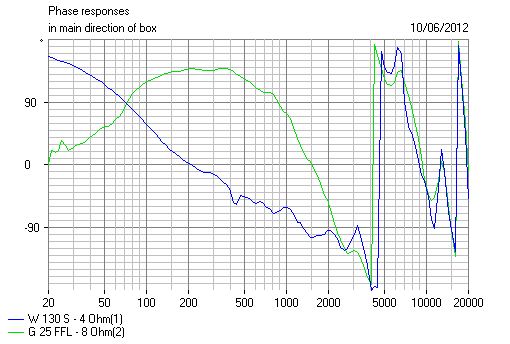

You can expect a response a bit like the below diagrams with a 3.3 attenuation resistor in place on the tweeter. But that has to be done by ear. It's all pure guesswork really, but helped by your near time alignment. 🙂
