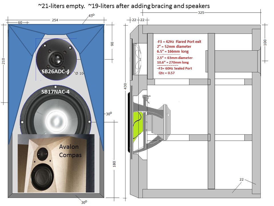

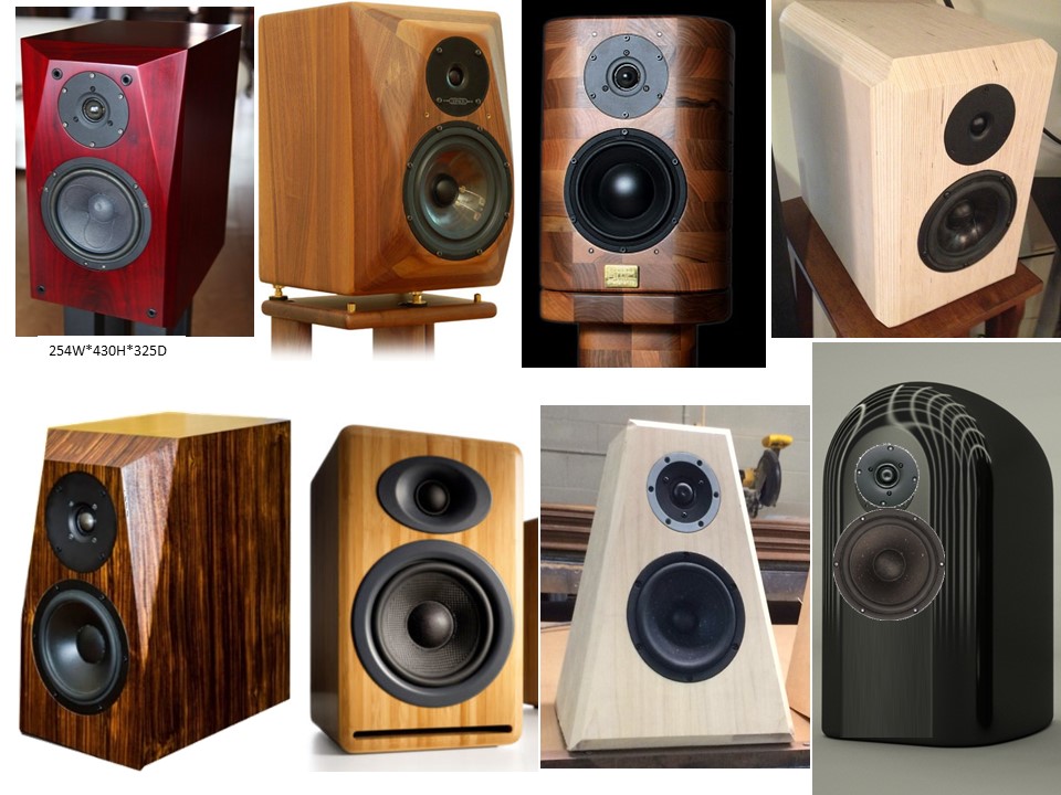

The SB17NBAC-4 does not start beaming from the 180-degree baffle-controlled polar directivity until above your 1.5kHz crossover, so a tweeter waveguide would create an abrupt change in polar directivity around the crossover.
With DSP time alignment, you could mount the 1.5kHz crossover tweeter for the closest center-to-center spacing on a flat baffle and get baffle-controlled smooth constant 180-degree directivity over the crossover, with just the normal SB26ADC tweeter beaming starting aroung 4kHz. Smooth controlled directivity. To reduce baffle edge distortion, construct a proven low distortion baffle with bevels or rounds. I think this is the best DSP supported design for a 1.5kHz crossover
TYPICAL: Controlled Directivity Waveguide tweeter
1) find a midrange with a smooth high frequency, and modest cone break-up artifacts
2) set crossover frequency to where the midrange beaming matches the waveguide directivity
3) design a crossover steep enough to attenuate midrange cone breakup
For the SB17NBAC-4 midrange, if you moved the crossover to 2.0 - 2.2kHz where some beaming narrows the polar pattern to match the polar pattern of the tweeter waveguide, you could maintain smooth controlled directivity. BUT you would require a steep crossover to attenuate SB17NBAC-4 cone breakup.
Buchardt Audio uses the SB17NBAC with a round waveguide with a 2,000Hz Crossover on model BA S400. The depth of the waveguide is set to match the tweeter-midrange physical offset with a passive xover.

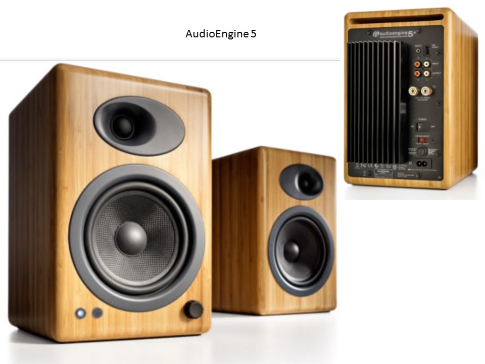

Audioengine builds monitors similar to your goals
Speakers — AudioengineAudioengine

Thanks for your reply Linesource.
If I understand correctly, the crossover point should be where both the woofer and the tweeter + WG drop at the same frequency, under the same angle. Should it be -6 dB at 60 degrees?
So of I were to crossover at 1,5 khz both the woofer and tweeter + WG should have their - 6 at this frequency. If so, this would be hard to achieve with a 6-7 inch woofer (haven't found one that suits these criteria). I would have to push the XO-frequency higher, or I would have to choose a bigger woofer, probably an 8 inch.
Please correct me if I am wrong.

Progress is being made.
This is the concept design of the box. Will let the front be CNC'd and the rest be done by a friend who is woodworker.
Dimensions (HxWxD): 34,5x19x33,5 cm. using 18 mm as sides and 36 mm as front.
