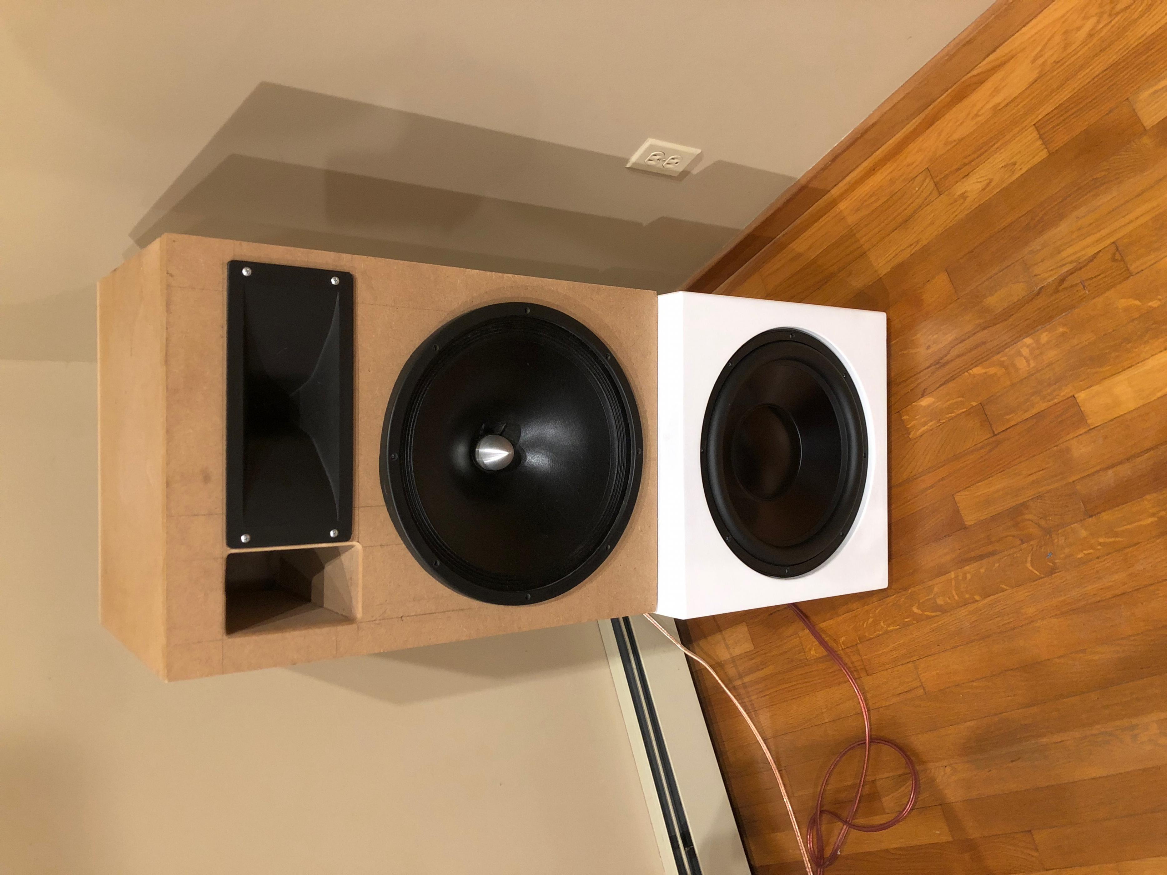

sorry guys, i'm a mechanical engineer... so probably a silly question.
Are 2 subs in parallel going to be the same sound volume as 1 sub? (assuming i don't touch the volume knob, obviously).
I have 1 mono amp (old HSU 500 watt thingy) and 2 identical sealed subwoofers (parts express 15 inch (RSS390HF-4). I plug 1 sub into the amp and all is well. I plug the second sub into the amp and the sound output seems to be identical. I would expect it to double... but again, mechanical engineer...

- the first sub's response has a huge peak at one frequency, and this peak overwhelms anything else you do. e.g. see the 45Hz peak in graph 2 on this page:

So you are perfectly qualified 🙂 , just need some focusing, Acoustics can be considered a subset of Mechanical Engineering.sorry guys, i'm a mechanical engineer... so probably a silly question.

Seems that some of those HSU amps can handle 2 ohms, so you might be good there for parallel operation. Also check the phase on the subs? Are they the same or out of phase? Depending on placement and bandwidth of sub, either option could be correct. Biggest effect would be to put them close to each other in a corner and wire them in parallel.
Also to add to JMFahey’s comments: an actual perceived doubling of loudness needs about 10 dB of extra sound pressure, so a second woofer will optimally only give you 6 dB.

Regarding the dB boost, my understanding is deifferent from some others here. It's a very hard factor to find clear info on, oddly, but what I believe is true is this:
Adding a second speaker onto THE SAME AMP adds only 3 dB. You get 6 dB if you add a second POWERED sub. (Or a second amp.)
3 dB will never sound twice as loud.
But there's another factor that has been overlooked: In your photo, you have a sub directly under the top speaker. Therefore, I assume the other sub is under the other speaker, i.e. spaced 6-10 feet apart in a smallish room. (You see where this is going....)
It's incredibly likely that you are now dealing with somewhat severe room nodes / comb filtering. So perhaps the bass frequencies that matter most to you (70 - 80 Hz, most likely) are getting nulled to some extent, thus negating the gain derived from the second sub in the first place.
Try grouping the subs in the middle, or wherever you can do it aesthetically, then move that groups around a little until you find a sweet spot. You might be very surprised at the result.
(You also will no longer be vibrating your HF driver, which is a very good thing.)

I'm sorry, but this is incorrect. If you use the same amp, and add a second woofer to the first; you either gain/lose nothing by wiring in series, or wire in parallel and gain 3dB in voltage sensitivity from halving the impedance, and doubling the cone area yields +3dB as well to yield +6dB in voltage sensitivity. If you are basing your answer on wattage, then you gain 3dB in power efficiency.
These are very different aspects of design, but since drivers are voltage drive based, then voltage sensitivity should be the norm, and yield +6dB in parallel; barring any cancellation or room nodes.
