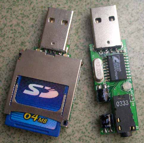

djd4n,this is my friends project.USB+headamp pocket.
wish that have some helps😉
yours digi
ok...now the question comes......what drivers will windows use to run the device?
is it the WMD ones.......its cause im into making music on my computer and id like to know how the program....cubase would interact with this thing.......it would be cool to have as a small headphone out when im moving around with my laptop...
...or or or....u:bigeyes: :bigeyes: :bigeyes: i could use it with my pc spectrum analyzer software as an isolated input into the laptop....so i can see the response of a filter...etc... on a spectrum analyzer on my laptop...holy crap...where do i get me one of these...
drivers.. for sure it uses the standard MME. I think also the WDM, that are backward compatilble with MME. About ASIO, I made some tests with the 2 freeware ASIO drivers out there.. but don't remember if they work.. anyway I'm quite sure that sooner or later an ASIO driver supporting standard USB audio devices will be available (if isn't already).
