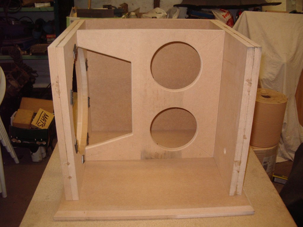

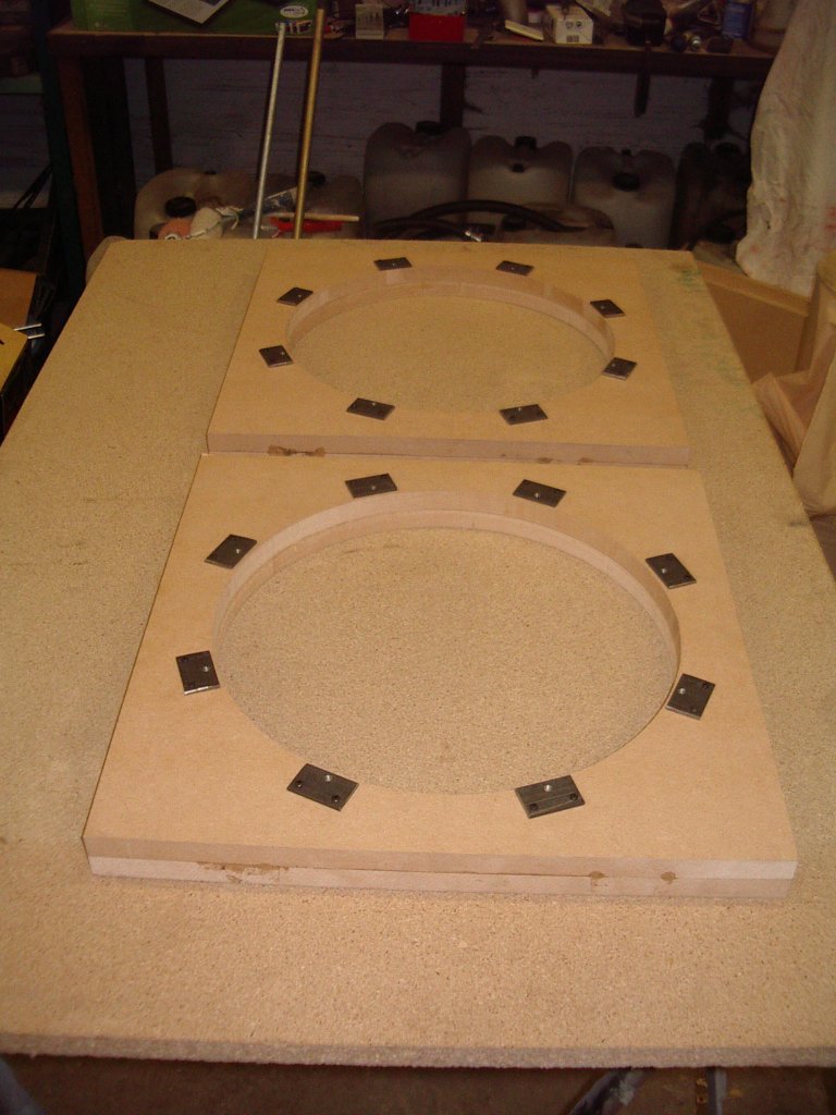

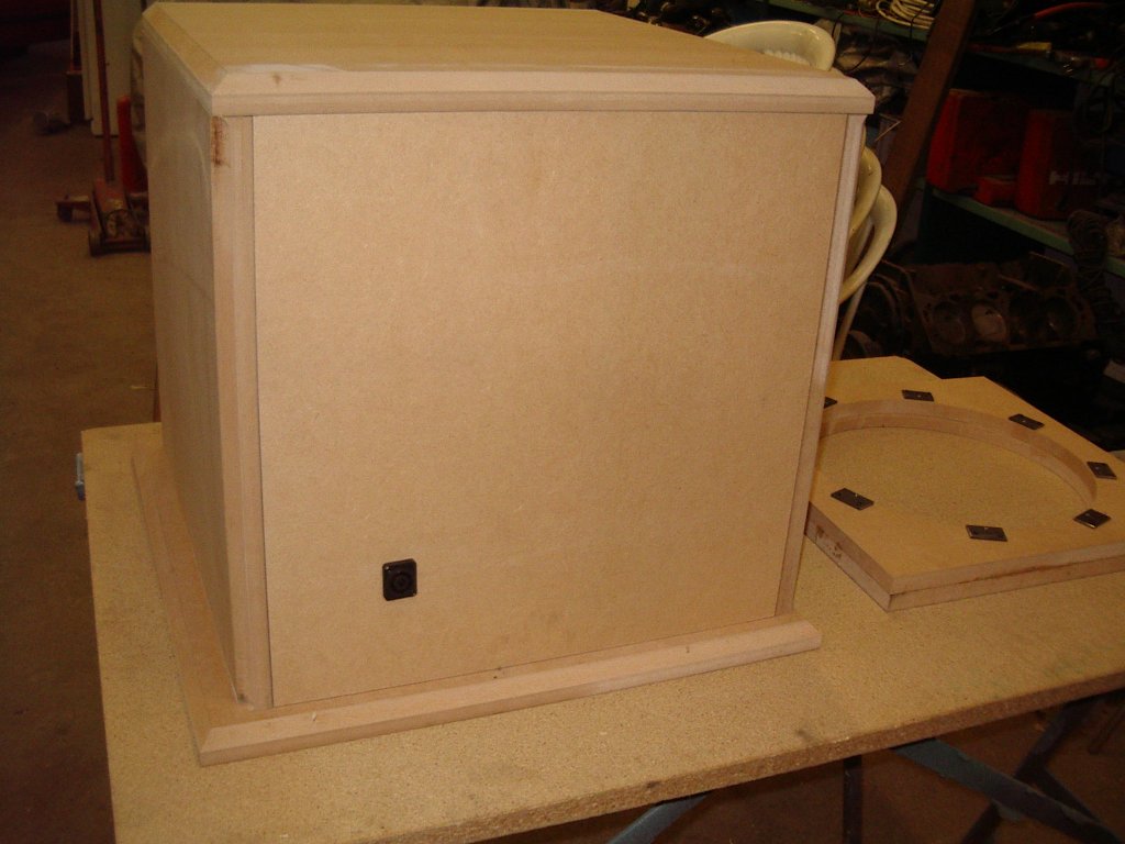

I bought 4 nice 15" sub elements for some years ago, but with too much work i haven´t had time to build the cabinets. BUT for some time ago i started to get the wood and the other parts for them.
I bought 4 Jbl W1500h drivers ( from the Array 1500 subs ) to my projects. 2 will fit my new 4 way TADS ( thread are coming soon) and 2 became new subs.
The cabinets are closed 80 liters. Material is 25mm mdf (1" mdf). A good friend cutted the parts on his work and i just had to make the holes and the glueing. All internal wood is not showing in these pictures. They pictures are still in my camera.
At this moment the subs are at a friends place to get some paint, NEXTEL´s "black beuty". A nice color with gloss 0 ( zero )

Interesting speaker. Looks like it uses the basket from the mobile audio WGTi series, but with a traditional motor. What are the specs on it and T/S parameters?
like the jbl drivers 15"*4 wow big for fun. der drv seems be difficult to know ts parameter. if u finish please post the pics i want to see the color u paint. hope that will beautiful color...wait ..wait is the best time to see in the feature.🙂
Those look pretty rugged matsj, please keep us up as you move along with this project. Why do you call them pigs?
What is Nextel zero gloss?
I also have a pair of the W1500's and I love them. Should I get one back out of an enclosure I will run them accross LMS, I haven't seen T/S parameters on them anywhere either.
