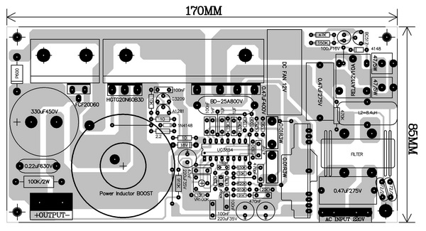

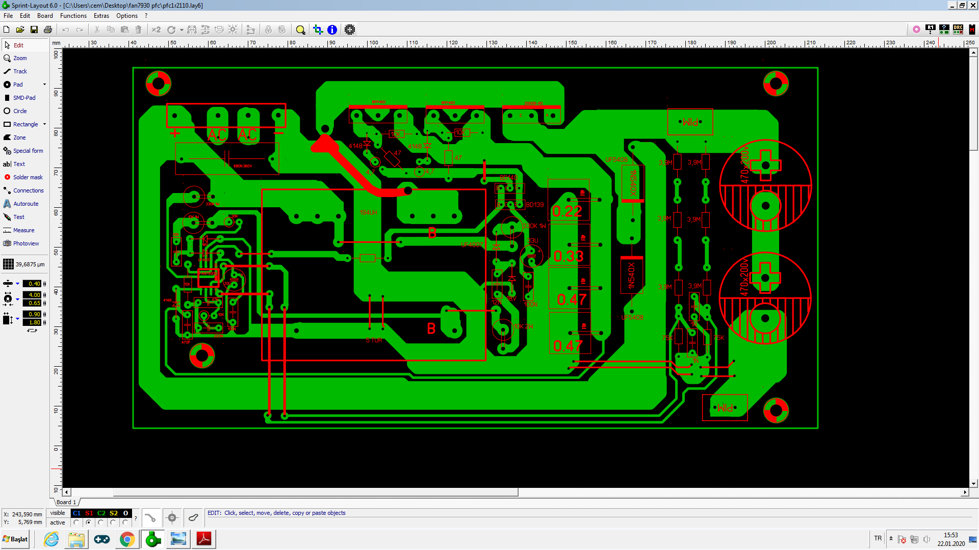

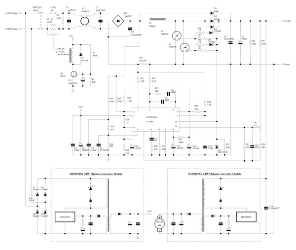

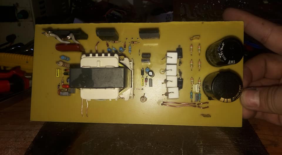

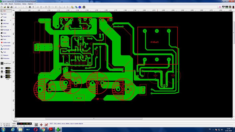

2 KW PFC REQUEST
Ncp1653-Ncp1653a 2kw pfc- 4kw pfc is not working. It does not produce pwm. The design is wrong..
I also made fan7930b pfc circuit. Current control is very precise. 380volt output directly crashes when it can be loaded. It does not produce pwm.
Is there a running 2kw pfc circuit? I will combine with self oscillator smps. If you have a suggestion, I want to make scheme, pcb, layout.

In fact, to scale it up you will need a bulkier inductor, capacitor(s), MOSFET's and its drivers, and lowwer current sense resistor, but the logic is the same.
in my opinion, I would use integrated MOSFET's drivers like MIC44xx devices in place of those complementary pairs, they have less delay, lower output impedance (Some of them have 6A peak capability) and internal protections (Undervoltage, etc.).
fan7950b runs at 186khz ..
I played with Fb resistors I bought Dc380 volts. However, when I plug it in and out at some intervals, the current sensitivity increases and the pwm turns off, some dc310 volts go directly. Faulty operation. I need strong work like 2 kw
