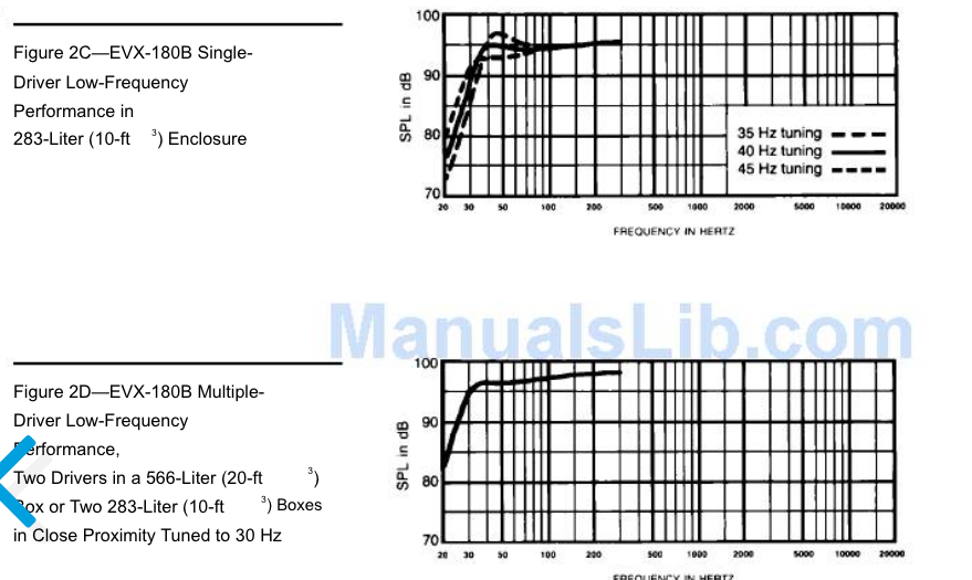

It's not so much the volume as it is being able to clean and clearly hear and feel all that was recorded. Sometimes speakers need assistance at certain frequencies. In this instance, I would like a subwoofer (or two), powered by a separate amplifier, to handle anything below 50-60 Hz. Doesn't have to be loud, just clean.
Below 50-60hz subs operate in pistonic mode where xmax alone determines how much spl can be generated, and that means these drivers will be power limited to a fraction of their thermal rating. But two 18's in a typical home listening environment should be able to produce lowend you can feel even with only a couple hundred watts so this is worth a shot IMO.
Two separate subs should produce better results too, in smaller rooms cancellation nodes are more prevalent and having the ability to put drivers in different spots will break up those nodes into smaller areas thus smoothing out coverage better.
There are certainly other 18" that have more excursion and power handling that work in smaller boxes than the EVX-180B, but they are plenty clean, and don't sound bad pushed past Xmax.
Two each in 10 cubic foot tuned to 30 Hz at 200 watts (each) should hit 124 dB, about 10 dB more than I'd ever use at home..
That said, since you have three, and "the more the merrier" as far as room placement, (and displacement) might as well use them all!
