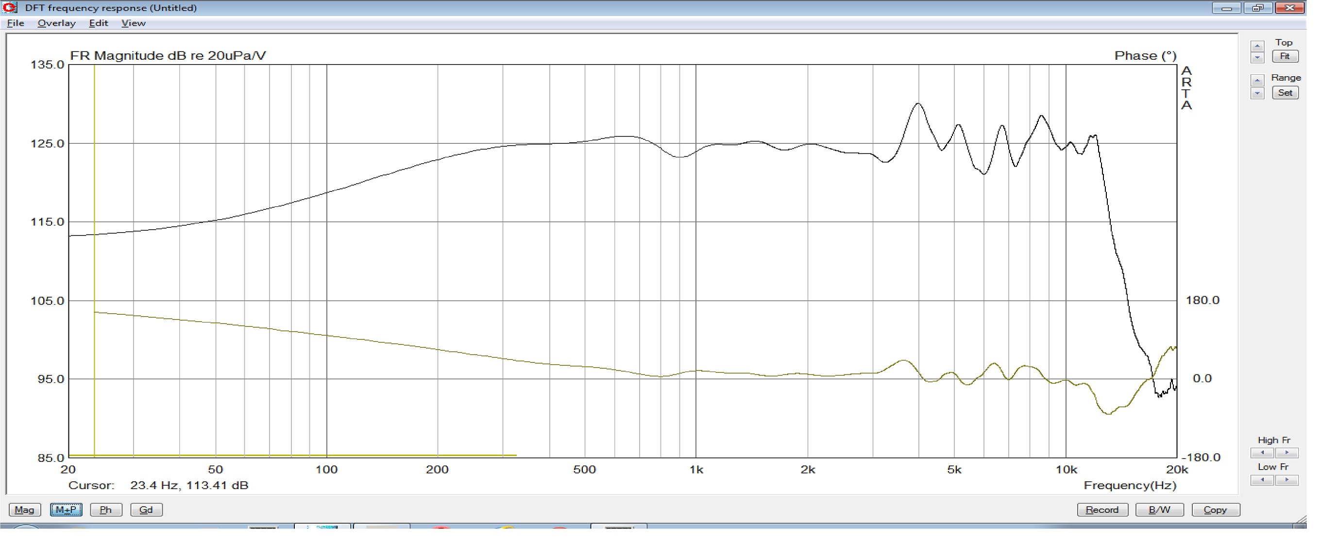

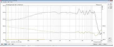

This post has measurements of your midrange dome

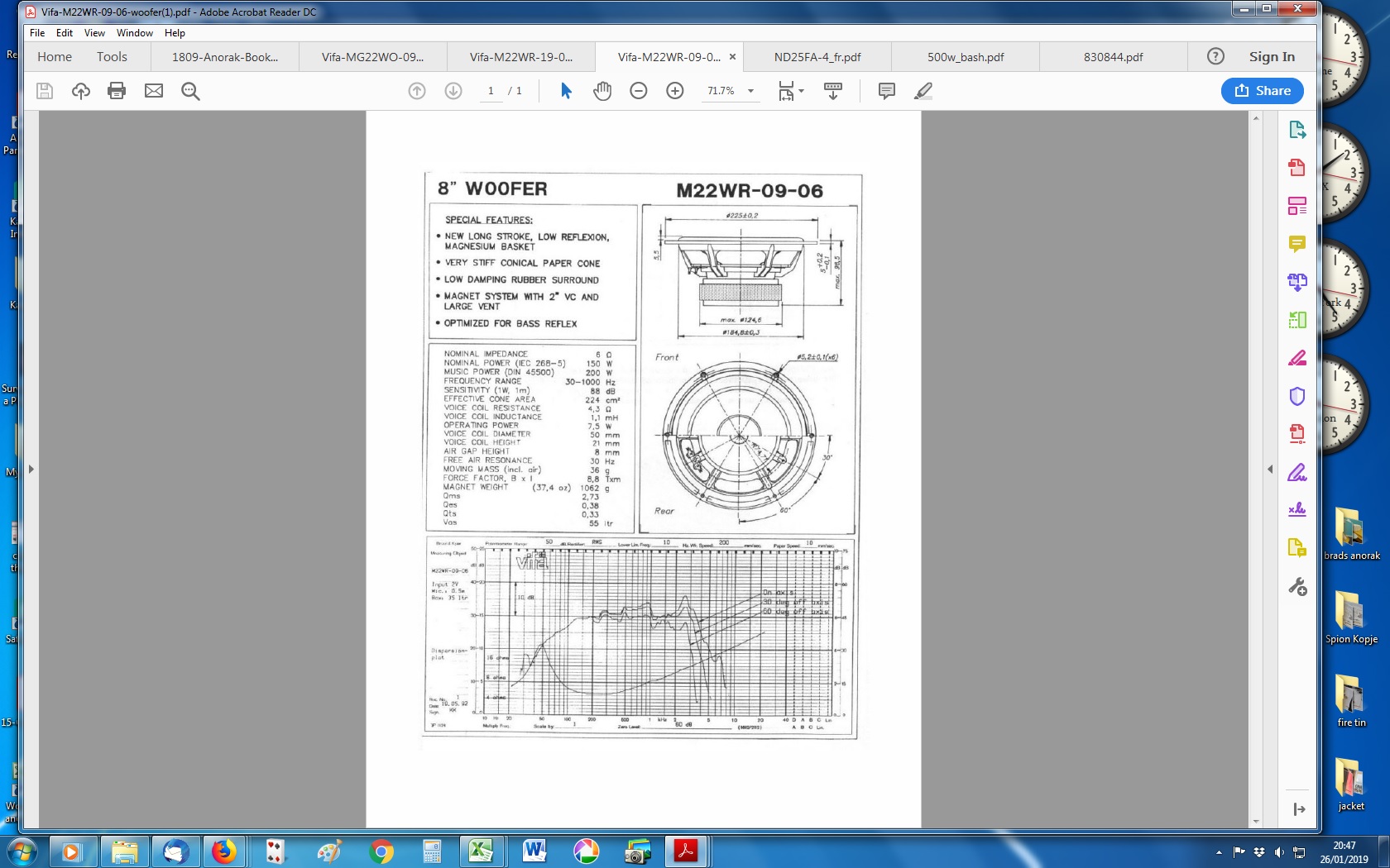

Vifa M22WR-09-06 - good woofer and it can work up to 1 kHz, SPL= 88 dB.
Jaycar dome midrange - has a resonance of 370 Hz, and it is undesirable to filter below 740 Hz. Best on 1 kHz, 2nd order. Spl midrange = 89 dB and waveguide not needed.
Hmm To me the woofer sounds pretty ragged above 500Hz
With what is in effect a closed box resonance of 375Hz I was hoping to cross much lower and was hoping a workaround using a resonance trap filter might work
Very good base, but Vifa-22 must either be measured by oneself, or by believing the manufacturer’s measurements.
