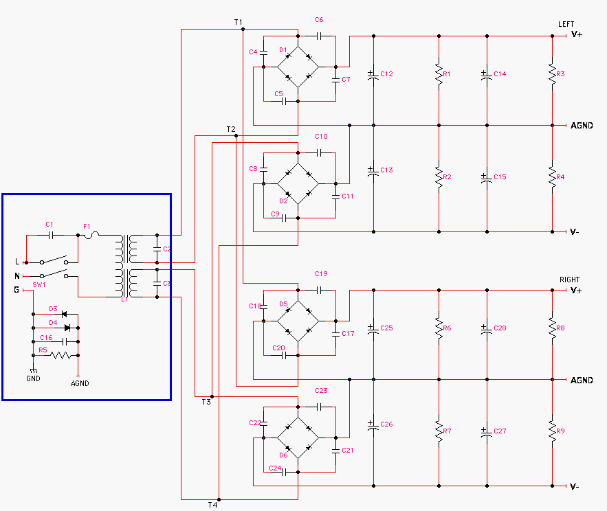

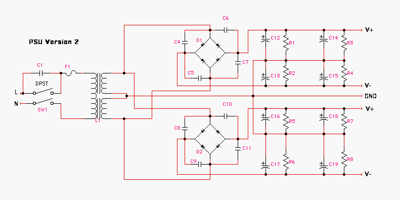

After reviewing documents found in this site, ESP (sound.westhost.com) and others, I have come up with a couple of versions. I need input in terms of:
(1) if there are any real differences between the two (other than the doubling of capacitance in version 2)
(2) if yes to above question, which one is better suited for:
(a) a stereo amplifier sharing the power supply, and
(b) a mono amplifier with its own power supply
The images (PSU Version 1, PSU Version 2) are attached below in separate replies.

Sorry we're not quick enough, really you ought to have used those two days to try and come up with the answers yourself though.
1. Yes, big differences. #2 doesn't double capacitance, it creates two more rails for a second amplifier, it is simply paralleled center tap based supplies.
2. #1, and there's been alot written about it, tnt audio, zero-distortion.com both, along with the mention of it countless times on the forums.

I am a little surprised no one has responded. Version one will work fine with a minimum of line noise but not the best channel separation. Version 2 will give the best channel separation but has a lot of ripple current in the grounds and this probably will be put right on top of the supply voltages so will create audible artifacts, not recommended and no easy fix.

My recommendation would be to use a single transformer, but separate rectifier and capacitor system for each amp. This gains you the better regulation and smaller size and lower cost of one bigger transformer, but minimised crosstalk to levels below worth bothering about.
As for rectifier and capacitor designs, I prefer to use the dual rectifier approach. This requires separate secondary windings. So you will need a total of 4 bridge rectifiers for a 2 channel system.
I prefer this way because it gives you better quality ground and loads the transformer better so you can get that little bit more out of it.
On those images you put up, the first one has too many snubbing caps used IMO. The one on the AC side makes the most difference.

the big drawback of having a stereo amp. with 2 transformers is the weight it will have and the size of the cabinet in comparison with a 1 transformer setup. The advantage of having a bit more power out of it is marginal. Did a lot of testing with different ways of making PSU's for stereo amps. and it just is a choice of either having a heavy and big stereo amp. versus a smaller 1 with a tiny bit less power. And the difference in quality, well that's personal and for me not enough/marginal. For me soundstage is far more important than absolute power. And the size/power of the transformer is not so important as with an A/B amp. Class D is soooo efficient.
Thanks richie00boy, classd4sure and Bert for your input. I have attached an updated version which follows the design advocated by richie00boy. Also, I have included the circuit for isolating supply ground from audio ground (ref: adire audio) which I plan to use (for single ended input setup).
When I have to move to step 3 (mono amp setup for each channel), I would replicate the blue box contents and rewire T1 - T4 (see attached image) as in version 1 to each of the blue boxes (i.e., two rectifier bridges per channel)
Richie00boy, I assume you're talking about the snubbing capacitors C4 - C11 (both in version 1 and the attached image) and C17 - C24 (in the attached image). I don't plan on putting them on initially. I plan to add them to see if there is any measurable or audible (mostly the latter) difference and remove them if none is found.
Classd4sure or Bert, so a single transformer does provide good channel separation (soundstaging) if the bridge circuit is done correctly? Do I correctly understand what you're saying?
If so, I think I have my final design and I can proceed to the next steps. This helps me get started!!

That looks good in principle. I would move C2 and C3 to be as close to the bridge though as it's only there where they will do any good. You know my thoughts on the individual diode caps.
It is unecessary to include two sets of bleeders, one resistor across each rail will suffice. Although personally I do not like bleeders as they just waste power and capacity, and are another thing to fail. The amp will drain the caps down perfectly well, and during testing when the PSU might be powered with no load all you need to do is bleed them manually by a resistor or light bulb.
All that's missing is a cap across the neutral switch. I would use Y-rated caps for these positions to ensure they fail safe (open) should the worst occur. I use 2.2nF or 4.7nF.
I assume you have an effective soft-start system for the transformer?

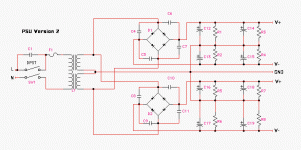

the schematic you've drawn here does not allow you to connect the grounds together. Each supply should have their separate windings. So you'll need a transformer with 4 separate windings like this. Otherwise problems. If you want to use 2 bridges per amp. use 2 transformers so you'll have 4 windings.
I also do not prefer caps. across the rectifier diodes or bleeders.
Re: I like bleeders
Chris, here you'll need bleeders for the sake of protecting the caps. This situation does not apply to a stereo amp. There are no free running caps.
Oh, I like bleeders too for series-connected caps. Like the app note says they are a wise choice. But in audio power supplies where series caps are not used in the vast majority of cases, they are simply a waste of energy and potential for hazard.
A split rail audio PSU is not akin to connecting caps in series, especially the twin bridge approach like what has been advocated in this thread.
Because the amps load them? Not good enough to warrant not using them I think. There's really nothing wrong with using bleeders and obviously they have their purpose. Although, I didn't bother with them in my supply either, I wouldn't go say they're not a good thing.
