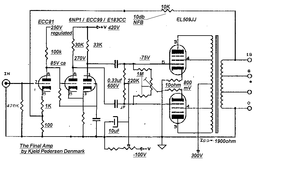

Heyboer is capable of winding excellent transformers, but we don’t know what specs these were designed to. $112 per pair? Go for it then, but find out the specs. Build something like kodabmx’s amps, or this one (if UL) that a diy member published a couple of years ago, title the “Final Amp”; can’t find the thread now:
That one will have 40 Hz response, and will only be designed for 150 mA or so of DC bias (50-75mA, x 2 pair - typical for bass amp using common tubes). Might be good enough for your app. At $112 per pair instead of each it does look attractive, even if you only get 60-80 watts at 20 Hz. High end may or may not go all the way to 15 or 20k. I guess the only way to know is buy and try.

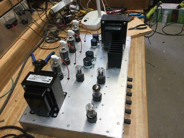

Speaking of the Hammond 1650T 120W 1900Ω. Planned a six tube 6BG6G amp. Previously had made six tube (6BG6G) amps with Altec 1569A, which worked great. It turned out that it needed eight with the Hammond 1650T. Sounded excellent.
6BG6 only has the current capability of the 6L6, because of the 900 mA heater. Not surprised you need a bunch of them. I’m driving a 1650T with four 26DQ5 (off-voltage heaters are much cheaper) and it makes 137 watts with the screen down at 125V. Two would almost do it - probably would if I pushed the screens to rating. Those impedances are about right for the big sweep tubes, and the little ones are cheap enough to parallel a bunch of anyway. Driving 1650W’s with six 6550 and a lot more B+. Four would do it - but only if I ran the screen up at 400V. Rather buy six $40 tubes instead of four over and over again - and it does give noticeably better damping factor. Ended up with iron fist bass and VERY clean clipping that sounds like a Crown Macrotech. The “little“ DQ5 bass amp sounds “tubey-er”, but most of that is the intentional current starving in the preamp section.
Interesting looking driver section on your amp. The heat sink is for SS regulation?? I use a Maida regulator for the screens and (6SN7) driver section. I am very fond of the sound of circa 70s-80s Soviet version of 6BG6G, and have >100 of them, acquired for a reasonable price decades ago. Very clean and neutral sounding, not tubey. US versions sound tubier.
The driver section isnt that unusual - just 12SN7 LTP PI and 12SL7’s for gain stages. Bought a few dozen NOS from Stan for $5 pop before he passed. I wanted to keep the topology pretty normal, other than using sweeps for finals. One experiment at a time. The only “unusual“ feature in the front end is parametric sweepable midrange using a gyrator. I did have one spare triode so I used it there. I did want to stay all octal for that build - it’s point to point and they’re just easier. Yes, the heat sink is for voltage regs - 125 for screen (from a lower tap on the main B+ to reduce dissipation) and 325 for the front end. Just stacks of zener diodes filtered by a cap and source followers.
