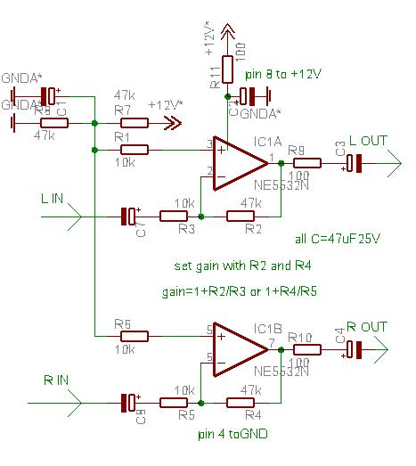

1V to 5V input signal
Why do you need such a high output voltage? ...and why can't you just use a decent opamp with a gain of 3 or 4 or so to accomplish what you want to do?
Or am I not understanding what you are doing?
Why do I ask so many questions? 😉

DJ,
I'm not clear with what you are asking.
I think most CDP has an output level of 2V RMS (peak).
Amplifiers have more variations in it's sensitivity, so pre-amp must be designed
such that the pre-amp output (when the volume knob turn to maximum) will not drive
the amplifier to clipping.
Because pre-amp stays in the middle between the CDP and the amplifier,
what you need to do is simply design the correct amount of gain in your
pre-amp.
Depends on the circuit type used, gain in op-amps usually (if not always)
is a function of (voltage) feedback resistor. Lowering the resistor value
will increase the voltage feedback and increase the gain.
NE5532 is a dual op-amp. In the ESP website (Rod Elliot's) there is a project
for a very good pre-amp that (if I'm not mistaken) uses OPA2134. OPA2134
is also a dual op-amp. I think that the project allows you to choose your
preferred gain.
If you need the formula to calculate gain in various op-amp circuits,
Let me know and I will dig my computer...
