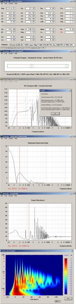

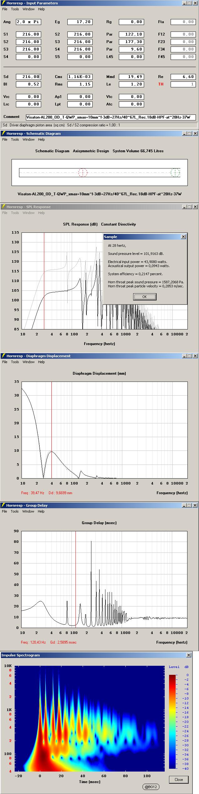

Very nice Bjorno!
I use Hornresp a little, but im no expert. Can you tell me why the flare profile is set on 'Parabolic' ?
I guess it wouldnt make a difference since S1 and S2 etc are the same area anyway. So basically a TL?
But at the same time, it looks a little like a tapped horn.... Im a little confused. lol even like a Tabac for Sub-bass 😀
It's a TQWP(T) or Tapped Quarter Wave Pipe (Tube).
Straight flare= TQWP.
Negative flare = Tapped-Tapered QWT.
Positive flare = TH.
