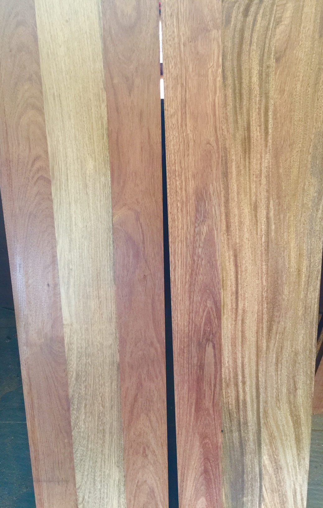

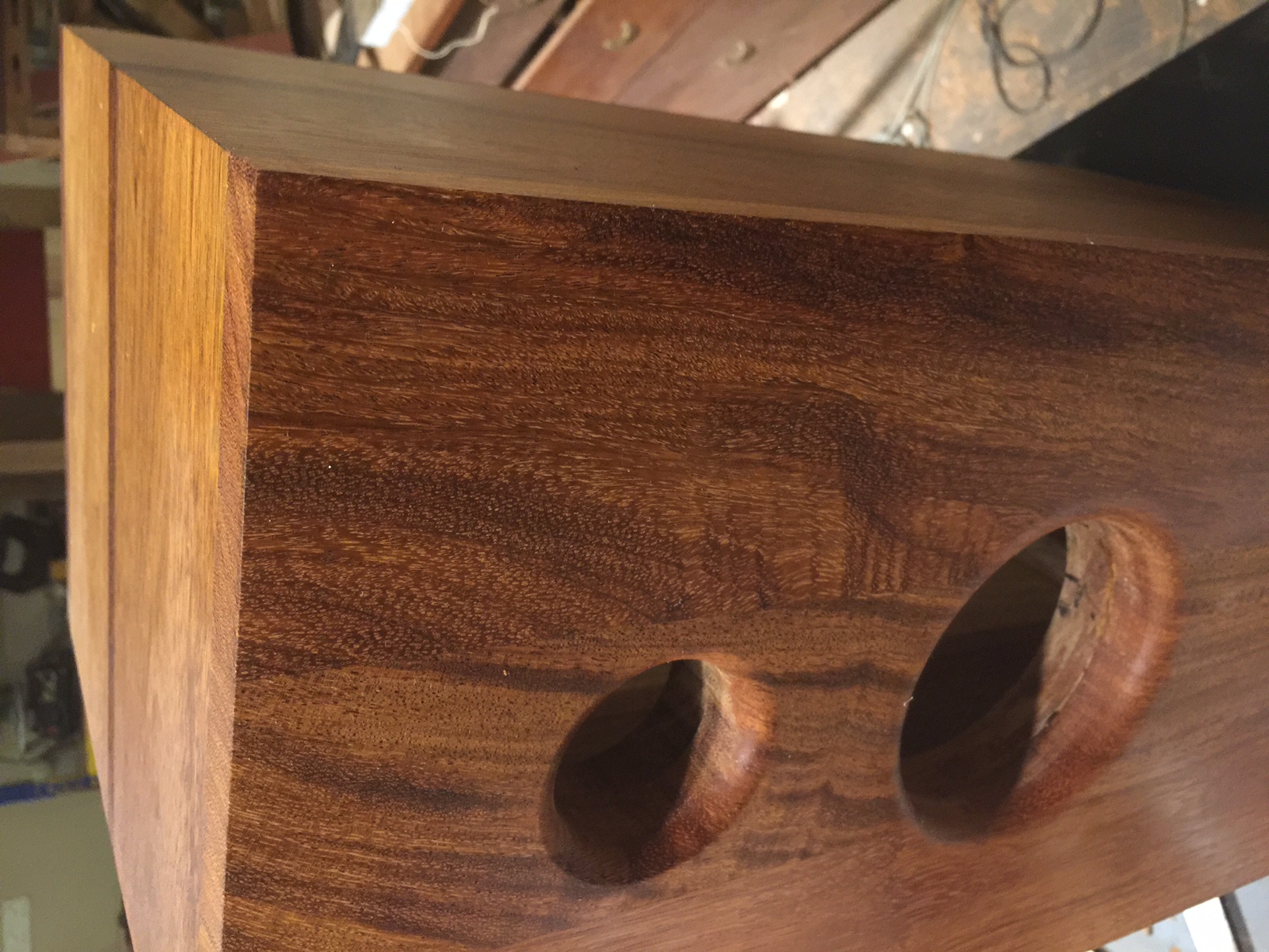

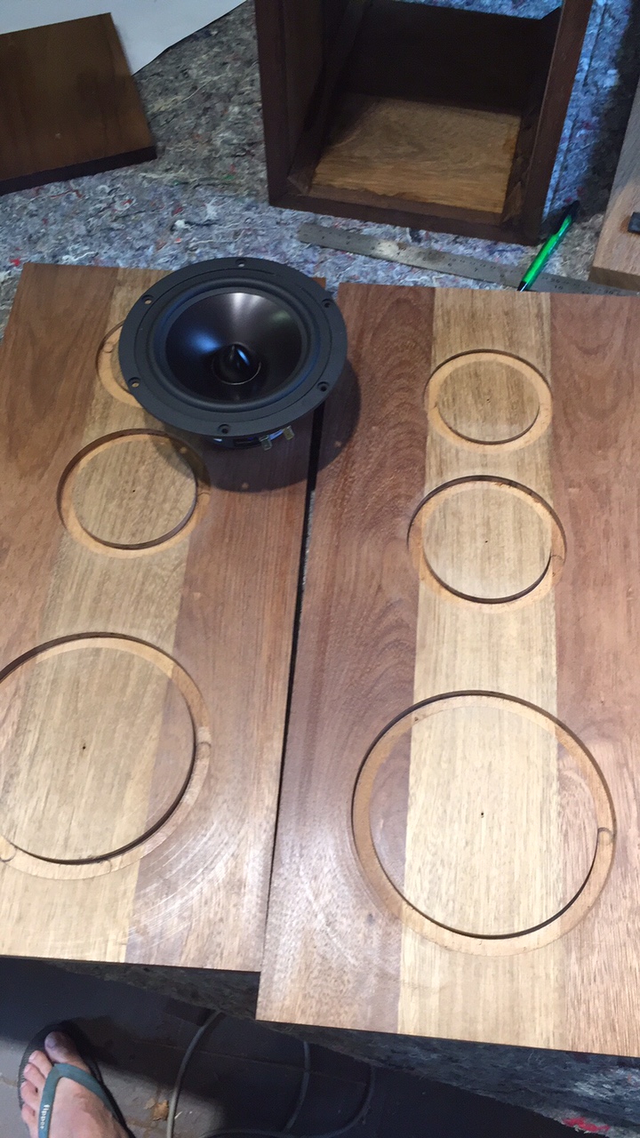

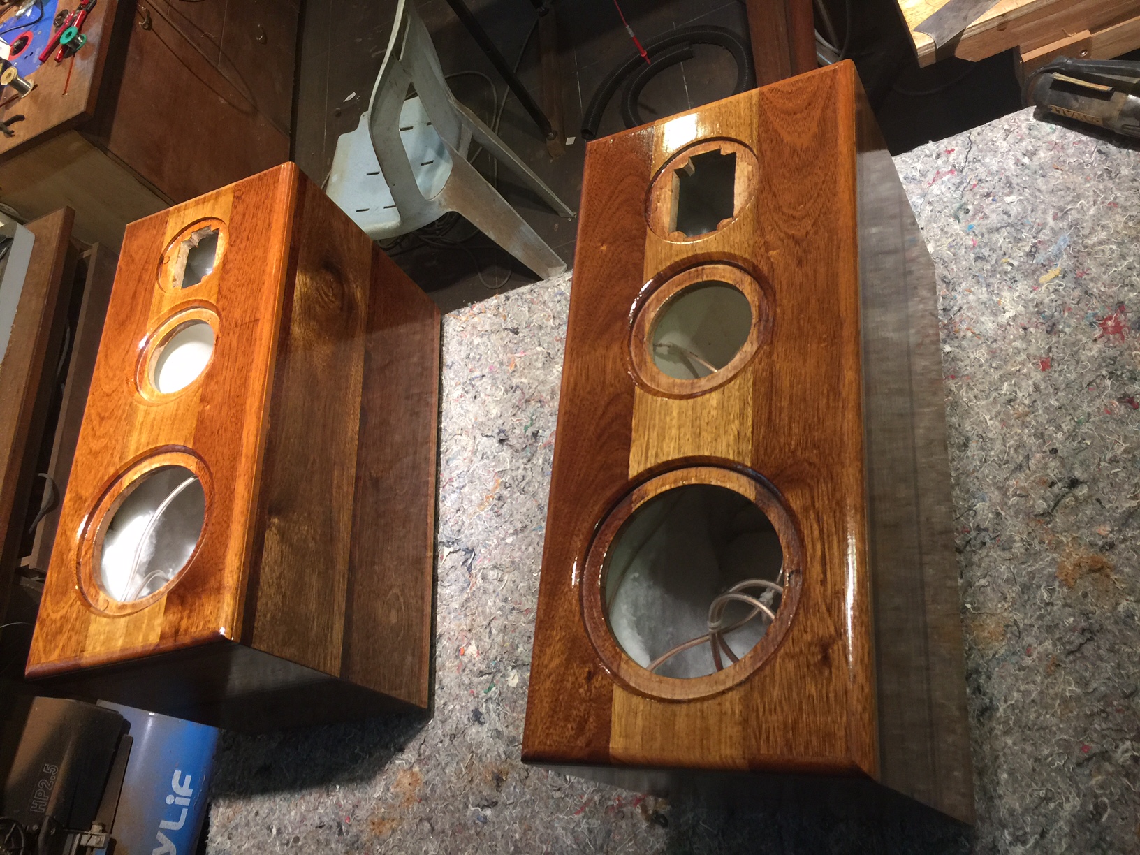

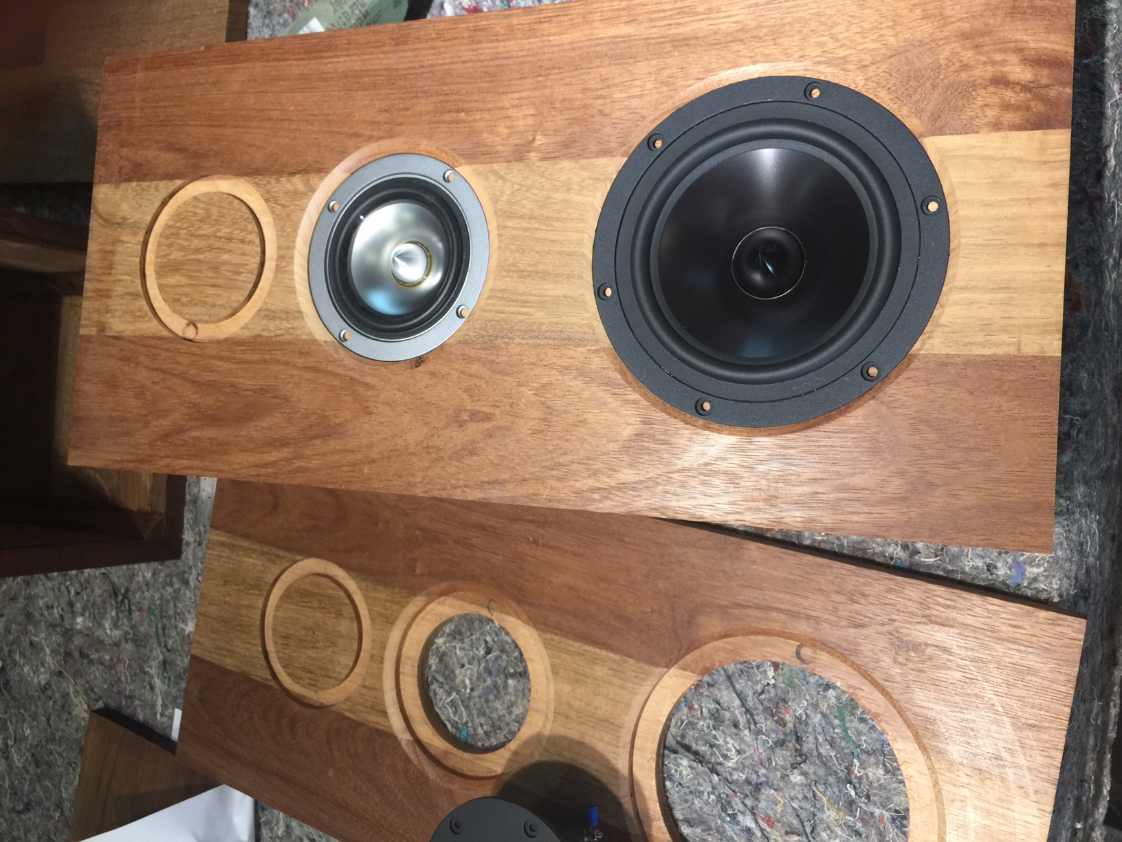

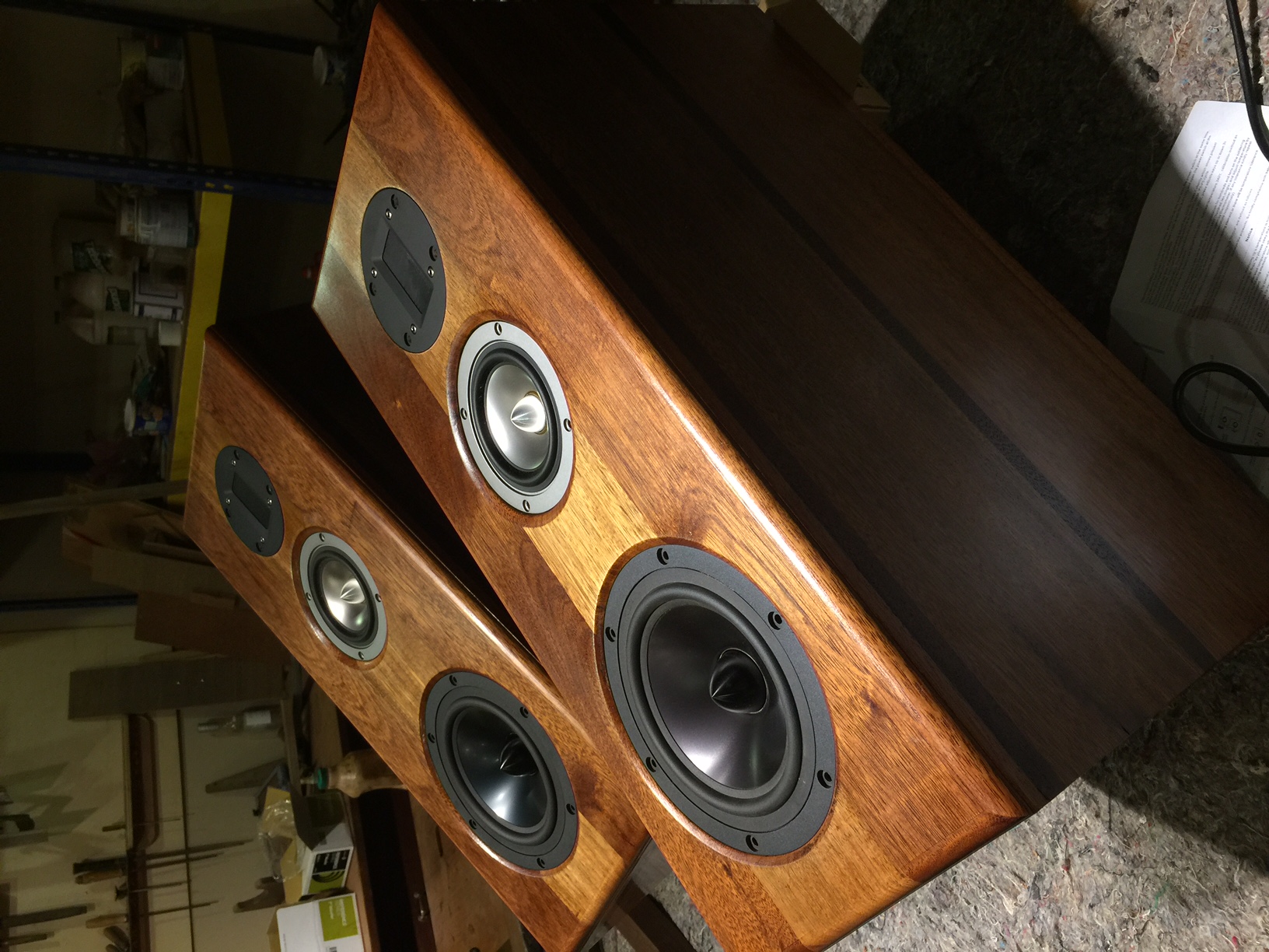

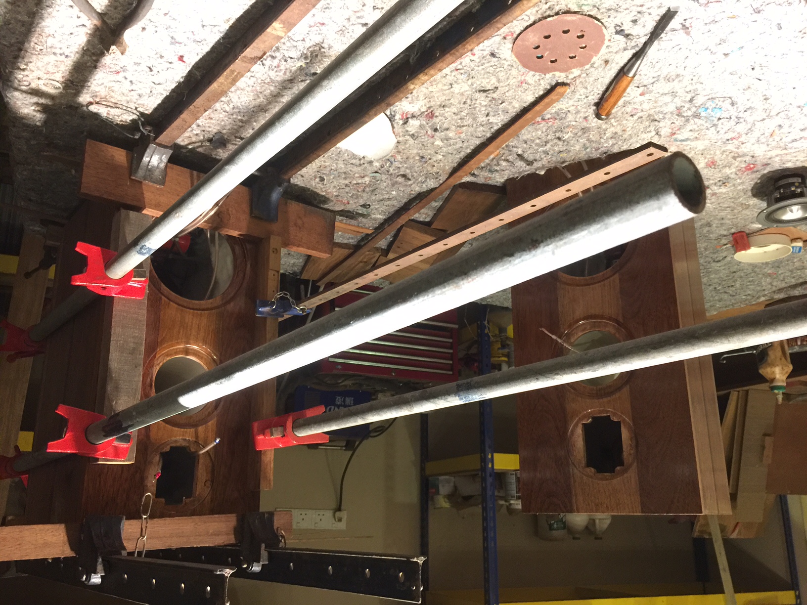

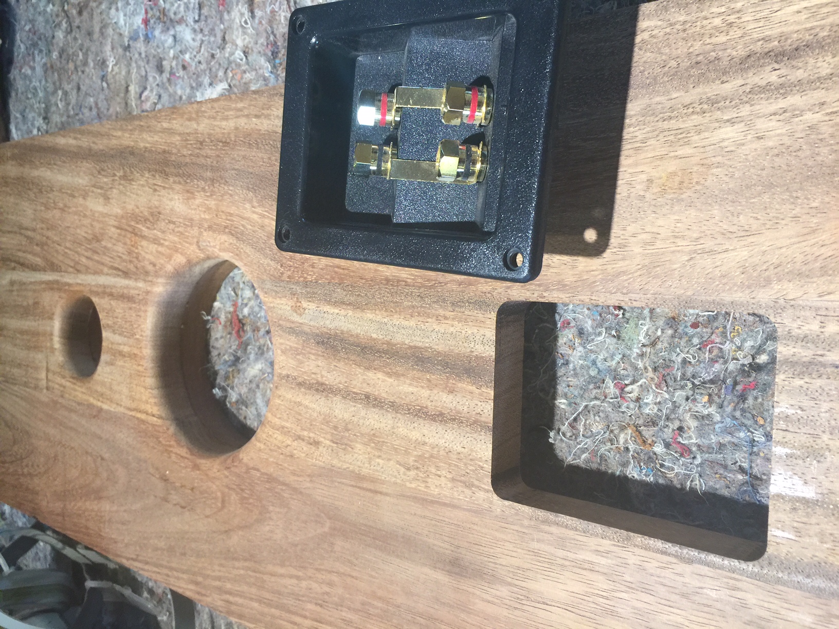

After picking up woodworking 5 years ago, I decided to build a set of speakers. Went with a hardwood build instead of Mdf with veneer, as I just prefer real wood over mdf. Veneer is also pretty difficult to get hold of here in malaysia.
Some pics showing the build. I did tweak the design a little, and adjusted the port for the slight difference in volume.
Missing from the pics is the flare I added on the port which was routed on to the interior support for the pvc port.
Sorry about the incorrect orientation of the pics. Looked ok on my pc

I noticed you used PVC for the mid tunnel. Is it 5" ID? When Curt and I designed the Statements series, we weren't able to find a cost effective supplier for 5" PVC, hence the square MDF mid tunnel.
Anyway, very nice work. I hope they sound as good as you'd hoped.

It sounds fantastic. I prefer it over my 20yr old mission 753F. I'm driving them bi-amped with an audiolap 8000c and two 8000p.
The mid tunnel is 110mm, about 4.5". It's not as thick as I would have liked, but I have added baffle to that surface too. I can't detect any unwanted reverberations/vibrations in the tunnel.
Thanks for the great design work.
