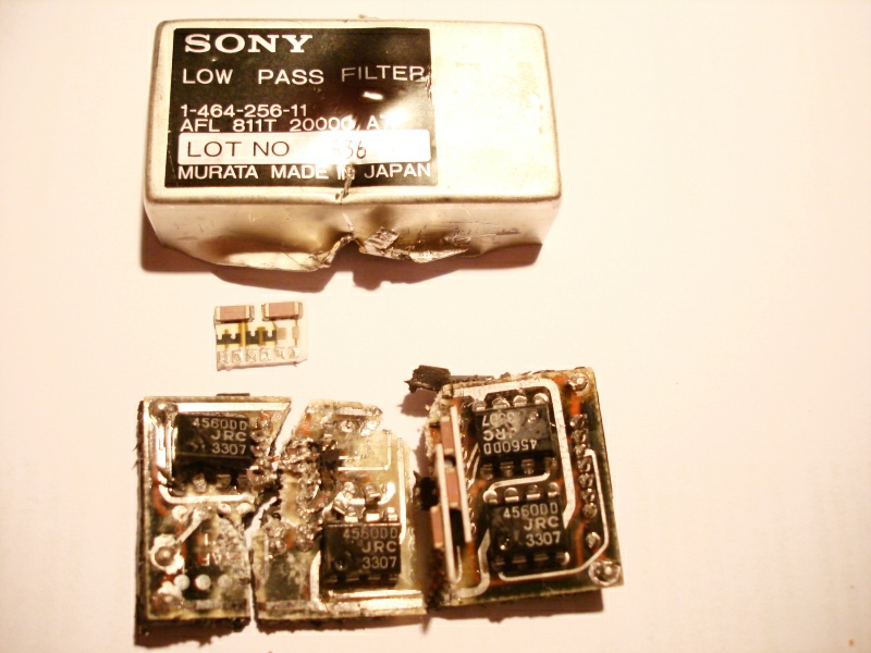

this! Third, passive Low Pass Filter (in those CDPs silver cans - see enclosed photo) also consists of op-amp and RC smd - five to six in quantity! Last

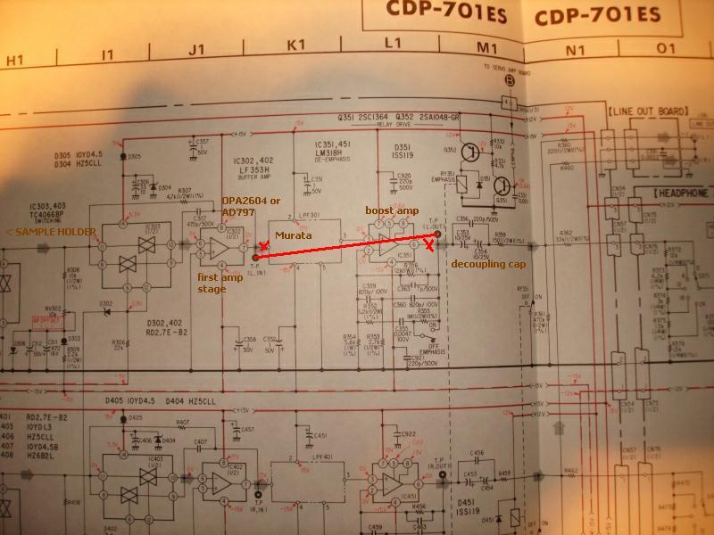

As you can see from the factory drawing I just simply skipped two last stages: LPF and buffer and changed the first buffer/sample holder to top notch AD797
amp, which here works exactly as I/V converter and voltage amp. It's output is directly connected via decoupling cap already used in those CDs before chinch
sockets - it is totally enough to extra bypass it with some good mini 50V polypropylene or bipolar 10uF capacitor.
And that is all! Few people asked about the sonic artifacts, which could appear due to the lack of low pass filter, but I have not heard any of them. This
direct mod I've applied in few such CDPs, playing them with more then few amplifiers and always with great sonic results.

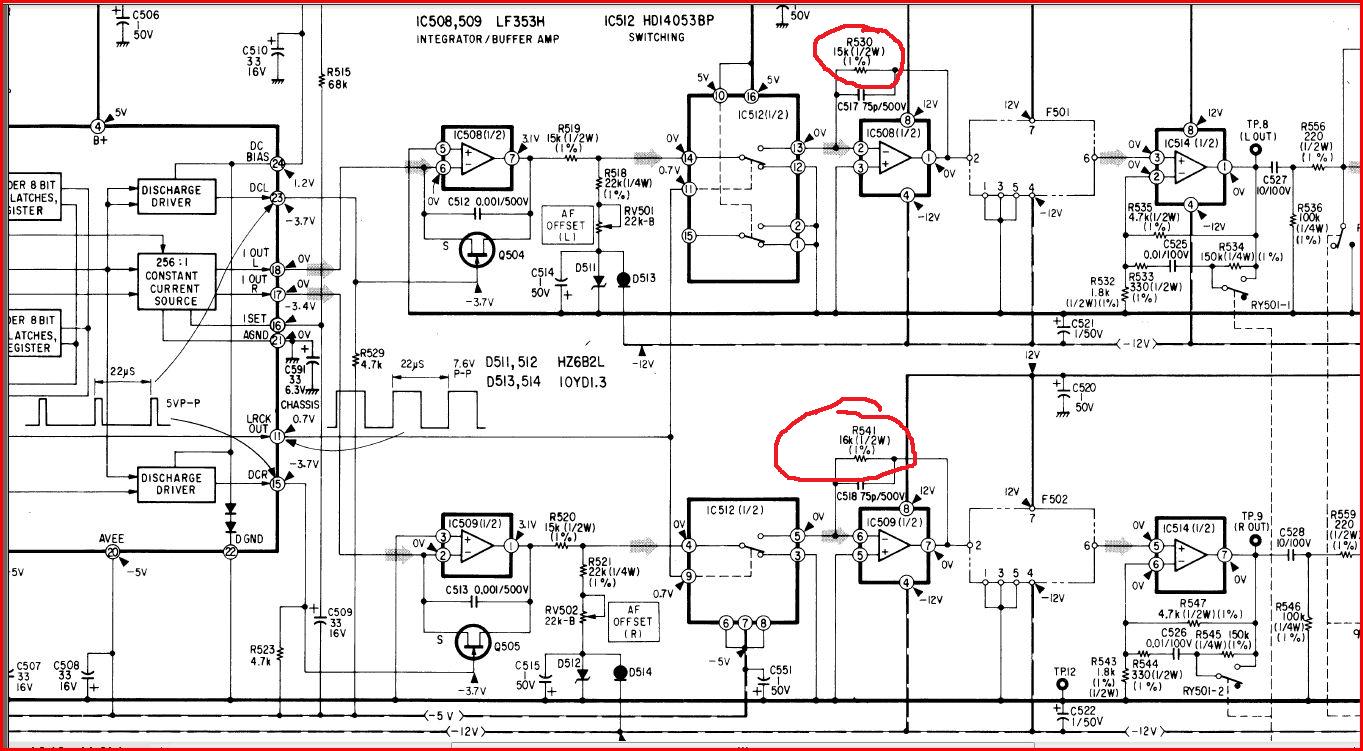

Have you noticed the CDP101 has different gains in the left and right analogue stages 🙂
Look at the feedback networks on the NE5532's one has 16K and the other a 15K. It's not a misprint... it's what is fitted.

I just looked at that Adrian Kingston site you mentioned because I know some years ago that I did mention the 15/16K detail as a suggestion to a site... and I think it could have been that one. I was just searching for curiosity to see if it had been mentioned before and it hadn't (that I could see).
I also remember asking about it on a 3 day course at Sony UK in the early days of CD and they thought it probably a misprint even though I assured them it wasn't.
I would love to test one today and really see what the real effect of that "gain change" between channels really did.
The DAC was time shared of course. Didn't it have "two modes" of operation depending on the sample being decoded... some vague recollection. Small and large samples were processed differently. It explained it one of the service manual supplements I think.

Mooly I have juast checked the top CDP-701 diagram and both channels have the same values in whole analog stage. So this CDP-101's issue is strange. Hm...
I just had another look at the circuit.
Maybe I'm missing something here. I always imagined the L and R outputs from the DAC would be identical (apart from the channel difference).
The resistor change does two things. It must alter the "time delay" between channels as the time constants of 75pf + R are obviously different for 15K and 16K.
That's one thing it does.
The other is that the signal gain is different between the two channels in the analogue domain. The difference is small, around 0.5db.
An effect of one channel being "ahead" of the other is that in theory the image will appear shifted to the side that "arrives" first... that's an effect of the way we hear.
So what is going on with this. Is the idea to slightly increase the gain on the "delayed" channel such that it counters this image shift by making it slightly louder ?
If we were to measure the output accurately on a 0db test disc are the L and R channels identical in amplitude or not ?
If they were identical then it implies that the samples coming from the DAC are different for L and R or the same "value" and that some "fiddle factor" is applied to shift the data value slightly.
