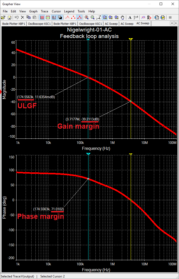

Nigel, I have quickly simulated your front-end (as I don't see your OPS at the picture). Feedback loop response analysis shows very low ULGF (175KHz) and very low loop gain at 20KHz (around 18db). 1000pF around VAS is huge capacitance. It kills performance. Stability margins are OK, but distortion above a few KHz is not OK. Did you try to see what 20KHz sine wave looks like at the output or measure THD at 20 KHz? Even 100pF would be a lot...
Loop gain curve starts at huge 70db at 20Hz (not shown at the picture) and immediately goes down at around 6db/octave which is ok if descending starts at 10-20KHz, not at 40Hz.

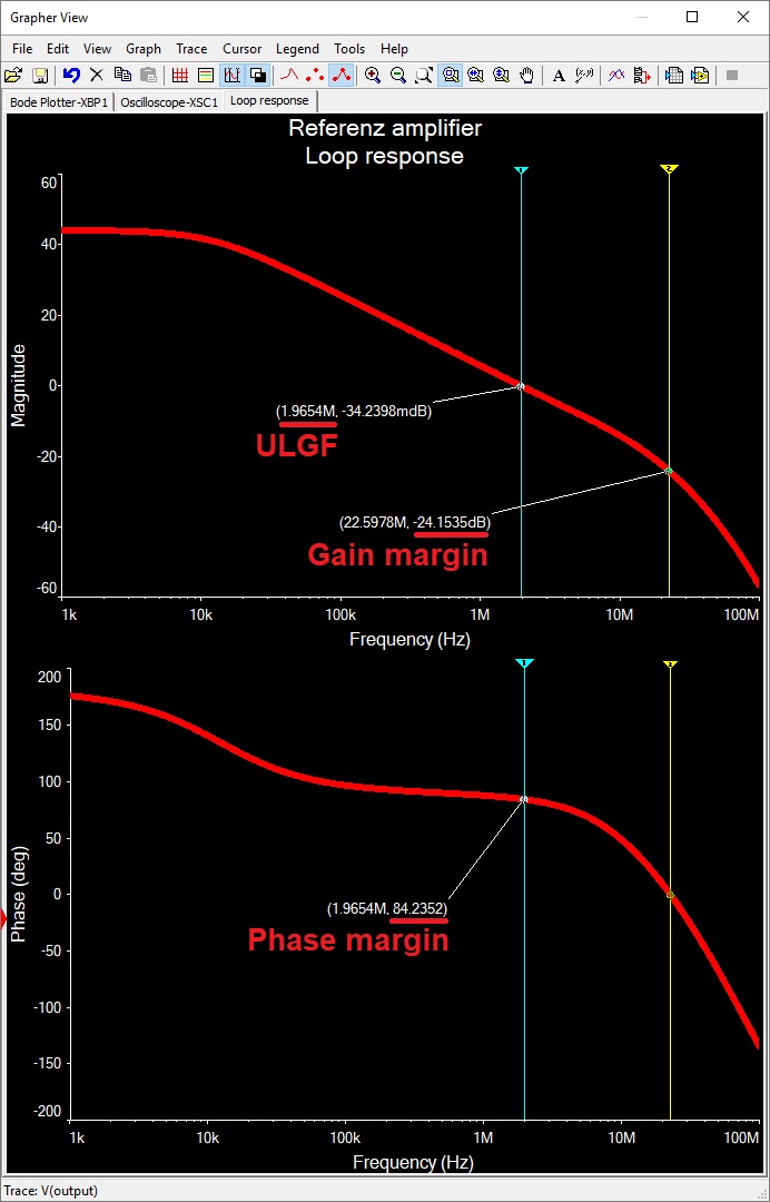

Just as an example, the second picture is the same kind of analyses of a decent amplifier. Loop gain is almost horizontal throughout 20Hz-20KHz (-2db) at the level of 42-40db. Low distortion throughout the whole audio range in combination with good stability margins. ULGF is 1.96MHz (1.5-2MHz is a good range).
Just something to think about 😉

I checked on the scope and it goes up to about 20KHz before starting to fall off with 1000pf VAS capacitor.
