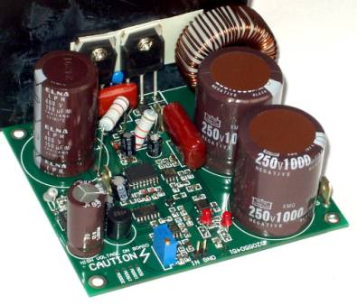

witali said:1kW? none... coil wire is slim...
Yes, it is slim. A fan cooling is needful in system design. The temperature is 45¡æ with fan cooling. Circumstance is 20¡æ.
BWRX said:1kW with only two output devices... Any chance you'll tell us what they are?
How about FQA24N50?

It was designed for 8ohms only. The current limits output power to 4ohms.

Output device are not optimized for that kind of power..And slow too! 200ns in switch off...Need lot of dead time! And worst..15.4A a 100 celcius....SAO are not to tight to support impedance variation of speaker? Try to move this with SGS STW45NM50...It will be lot more appropriate for power rating you claim! And easier to drive! The IR2110 in the picture did not comme too hot at this voltage? Except if switching frequency is near 150Khz...What frequency? What kind of level shifter did you use between the comparator and mosfet drivers? Why the third big cap on top of mosfet driver? Not to much info request I wish...

fredos said:Output device are not optimized for that kind of power..And slow too! 200ns in switch off...Need lot of dead time! And worst..15.4A a 100 celcius....SAO are not to tight to support impedance variation of speaker? Try to move this with SGS STW45NM50...It will be lot more appropriate for power rating you claim! And easier to drive! The IR2110 in the picture did not comme too hot at this voltage? Except if switching frequency is near 150Khz...What frequency? What kind of level shifter did you use between the comparator and mosfet drivers? Why the third big cap on top of mosfet driver? Not to much info request I wish...
Fredos
On and off time is about 90ns.
STW45NM50 looks better.
The driver is about 45¡æ with fan cooling.
Switching frequency is 360kHz.
No level shift.
One cap is for supply. Two cap is for output when supplyed by 300VDC.
