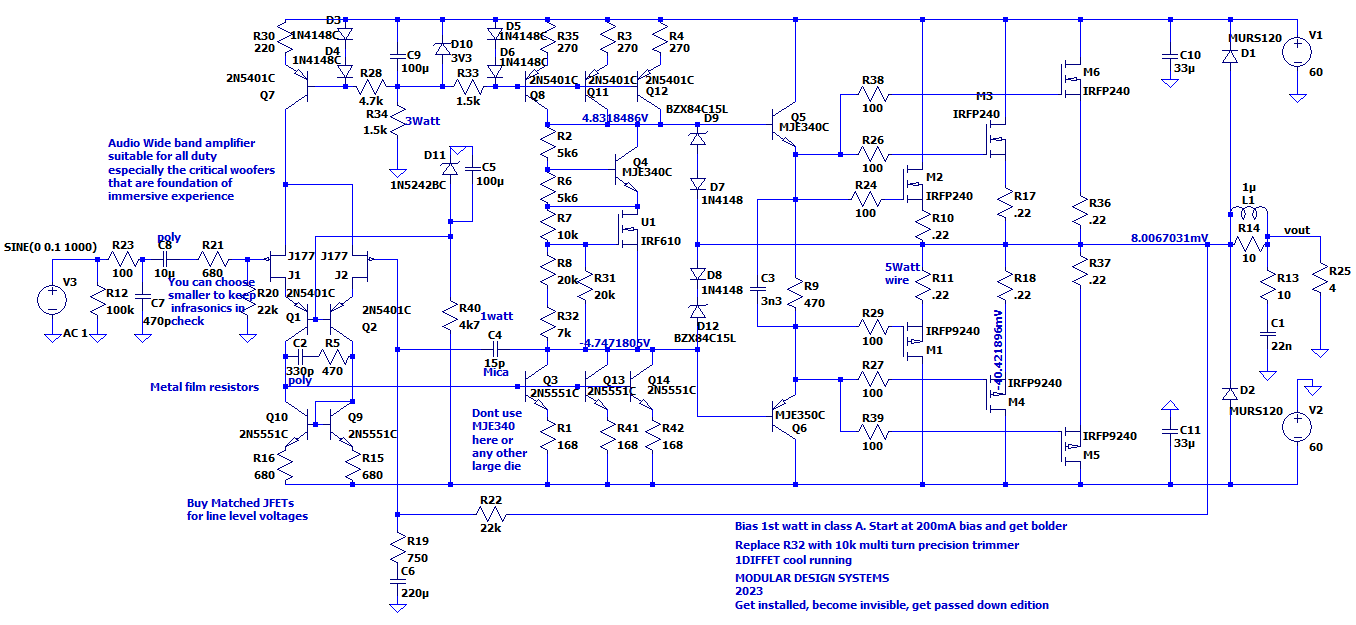

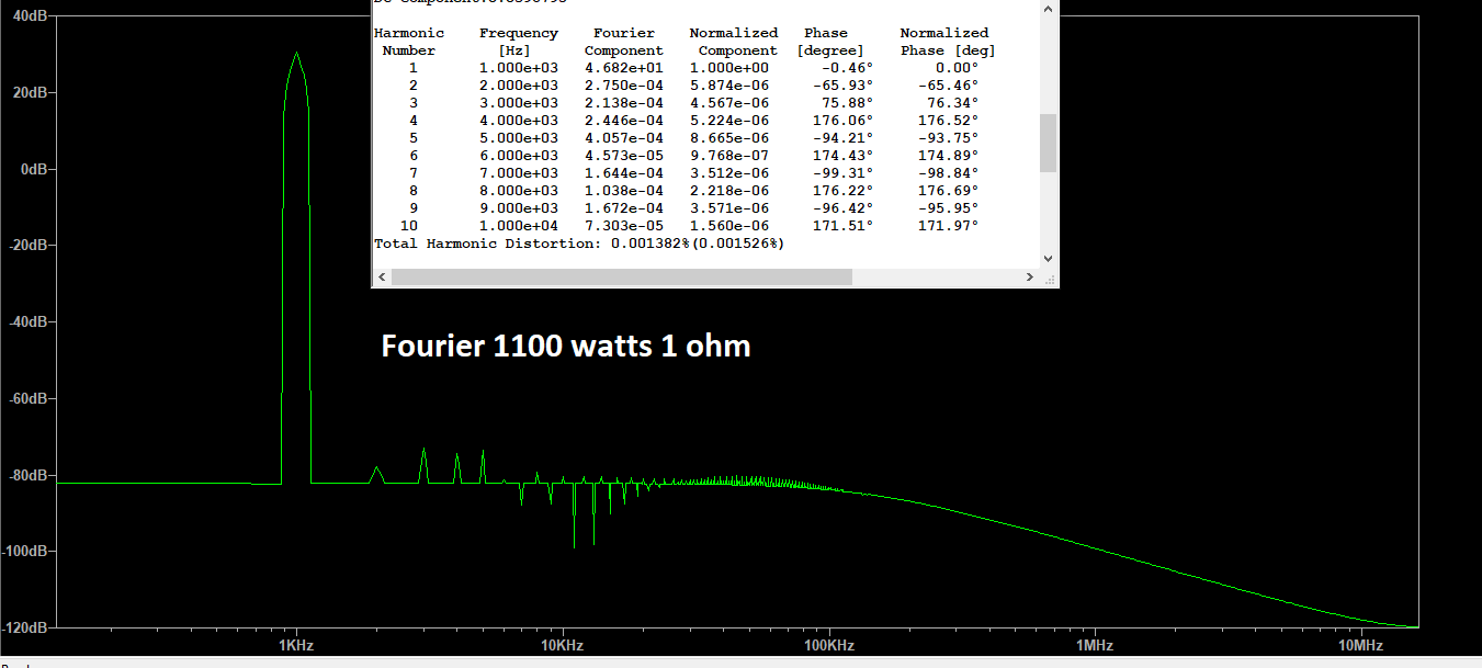

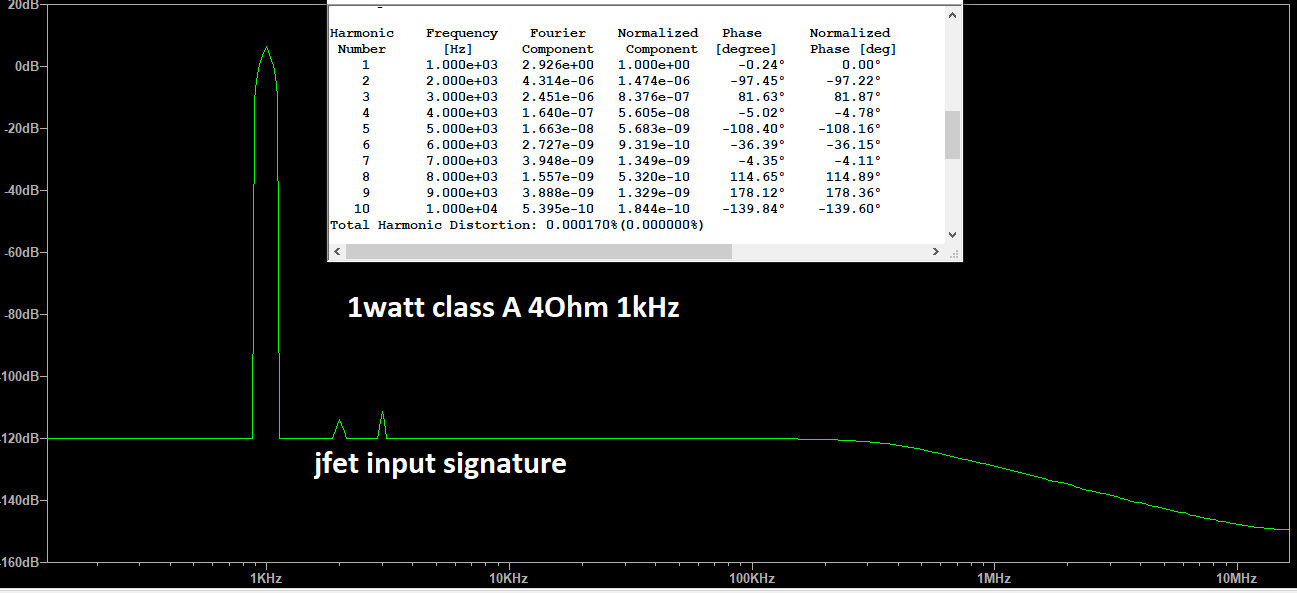

You can sleep easy knowing you aint missing out on any and the grass on your patch is the richest green.68dB of class AB sweetness
Hype aside like all things in life also for audiophiles there's no one size fits all all the time solution but this is a good reference amplifier and achieves low thd in a sober manner. The room, speaker, amplifier and music interact in complex ways and the ear and brain decide what it wants to hear. The brain is a great dsp if a certain threshold is met

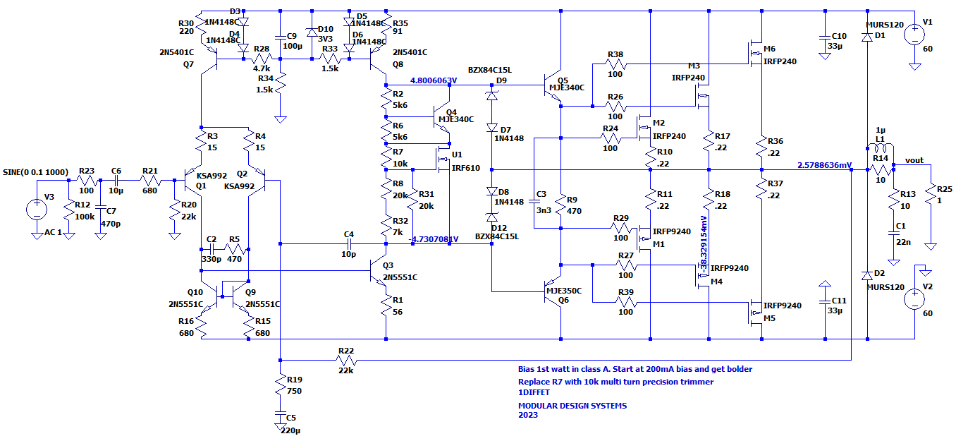

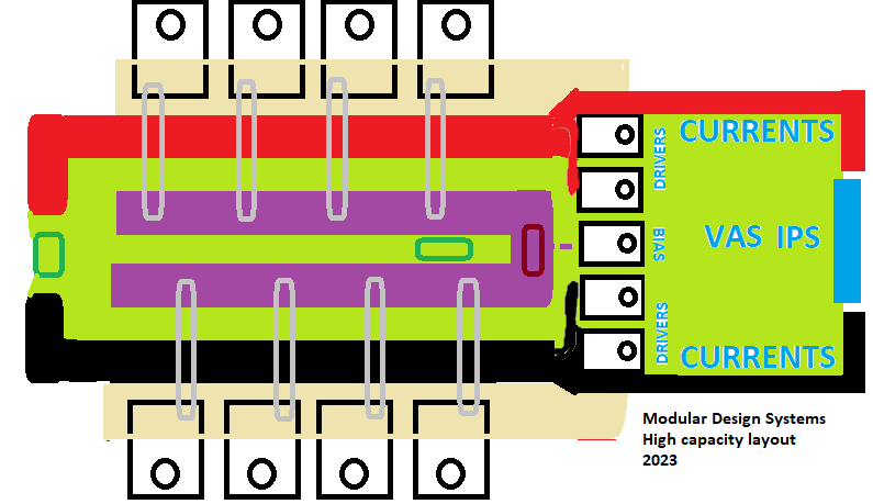

You can also play with this wonderful design with an nicely small PCB design https://www.diyaudio.com/community/threads/2diffet-amplifier.239753/post-7174549
- 1DIFFET amplifier for whatever speaker
