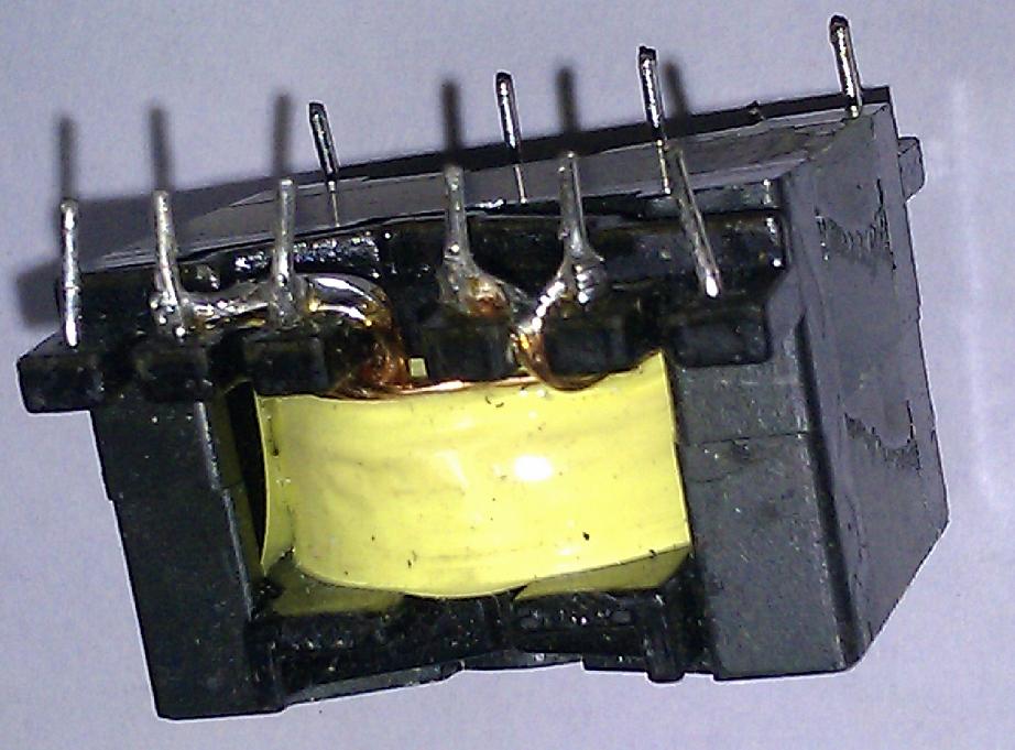

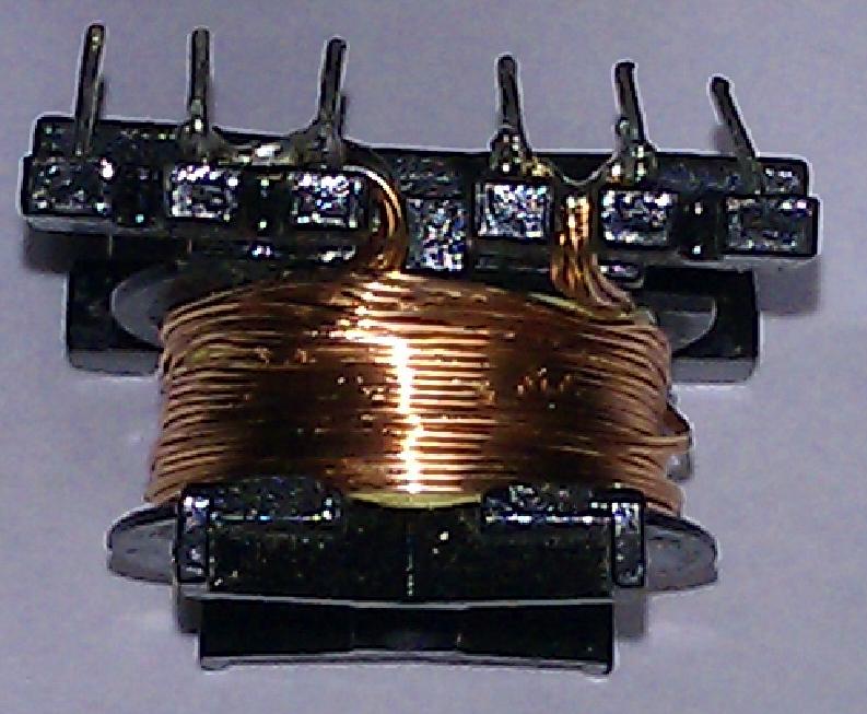

3. Things are changing when we talk about after-market adapters, or even adapters which come with brand new no-name-no-brand computers made by my surrounding neighbours. I got scared when i opened the first adapter, and I keep getting scared when I open each new adapater. If couple of years ago their safety was poor, then bad, now is terrible to none. I attach some pictures of a transformer from a notebook adapter bought as a travel spare from my computer. it eventually ended up chopped, and bought another one which cost me about 12 times more and even if I was 99.99% was original I wanted to see with my own eyes what is inside before I dare to use it, although it voids it's warranty.
What we see in the picture, there is no trully isolation barrier tape between primary and secondary and the primary and secondary wires are touching eachother. The only reason why this transformer hasn't killed anyone yet is because the wire insulation still exist. but imagine what happens after 1-2-3 years of thermal cycling, 20-80-20-80.....20-80*C and so on.
This is how most of the brick laptop adapters transformers sold for a burger on fleabey looks like inside. I advise all of you to open one and check. Although the plastic case is ultrasound welded (even screws or glue are expensive nowadays) is easy to open, put it on a hard surface on its side and hit the opposite side gently with a hammer on the line where both covers join. You might also be surprised if you'll find inside next to the tiny, half empty pcb board, one or two special components, connected to nothing, long and thin, wrapped into scotch tape and made of cement, or in best case iron scrap. it's only purpose is to convince the uninitiated buyer that the product is genuine, since it weights the same as the original one. If you're power supply is really deent made, you didn't lost anything by opening the case, (whell the power supply might not work if the opening process is not done properly) but at most you know the risk grade before putting your life in danger. Internet is full of discussions related to this issues, too bad that i can't access most of the pages with relevant content. I wonder why....
One reason why most of the SMPS which I desing and produce are using LLC topology is that beside efficiency and low noise this topology allows highest isolation to be achieved between primary and secondary, safety being a priority especially for DIY. with a split bobin transformer where clearance/creapage is at least 5mm and is visible, not hidden under layers of tape where moisture, impurities, and all sort of conductive elements can create a disastrous bridge.
