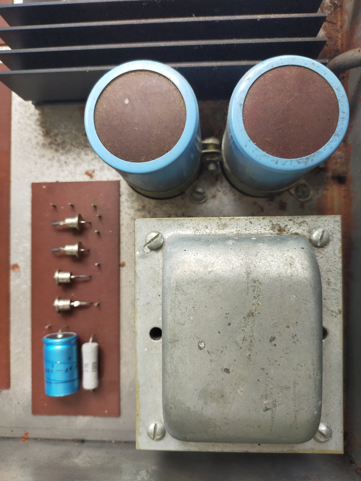

Hi, Im looking for assistance to problem-solve a 1972 80 watt PA power amp made by Jansen in New Zealand (we have 240 volts mains power)
Im running it with a matching 2x12 cabinet to play bass guitar through
The amp makes a lot of loud scratching and popping noise when powering up for about 30 seconds, and also when powering down
When it calms down after powering up it runs ok, but I get an intermittent low volume drop after a few minutes of playing. Occasionally the volume increases again after a strong signal but it is intermittent and unpredictable
Checked the internal amp for any obvious problems and found a burnt resistor. Replaced it, but the problem remains
The PA amp has obviously not been used for a long length of time

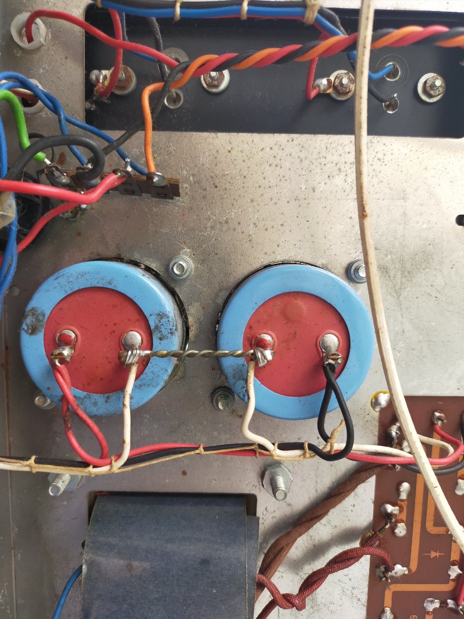

I wonder if the two power transistors (RCA 40636) and large caps ((3000 mfd) in the power section need replacing. How can I test these or trace the volume drop issue?
Any advice welcome : )

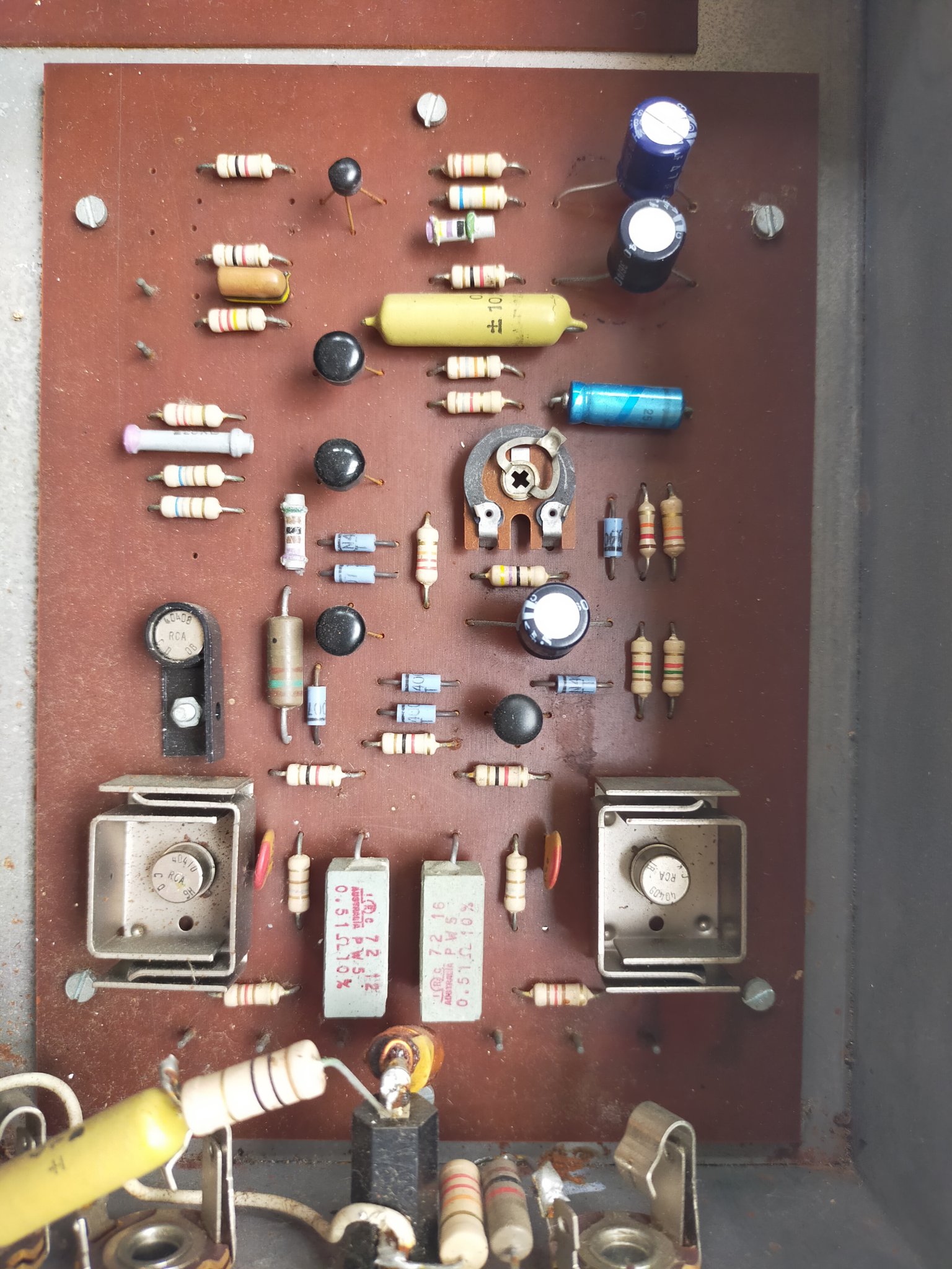

Those are valid candidates if this amp is not powered on for a long time. Post a picture of them to keep you rolling.
Thanks for all the advice from everyone, very helpful : )

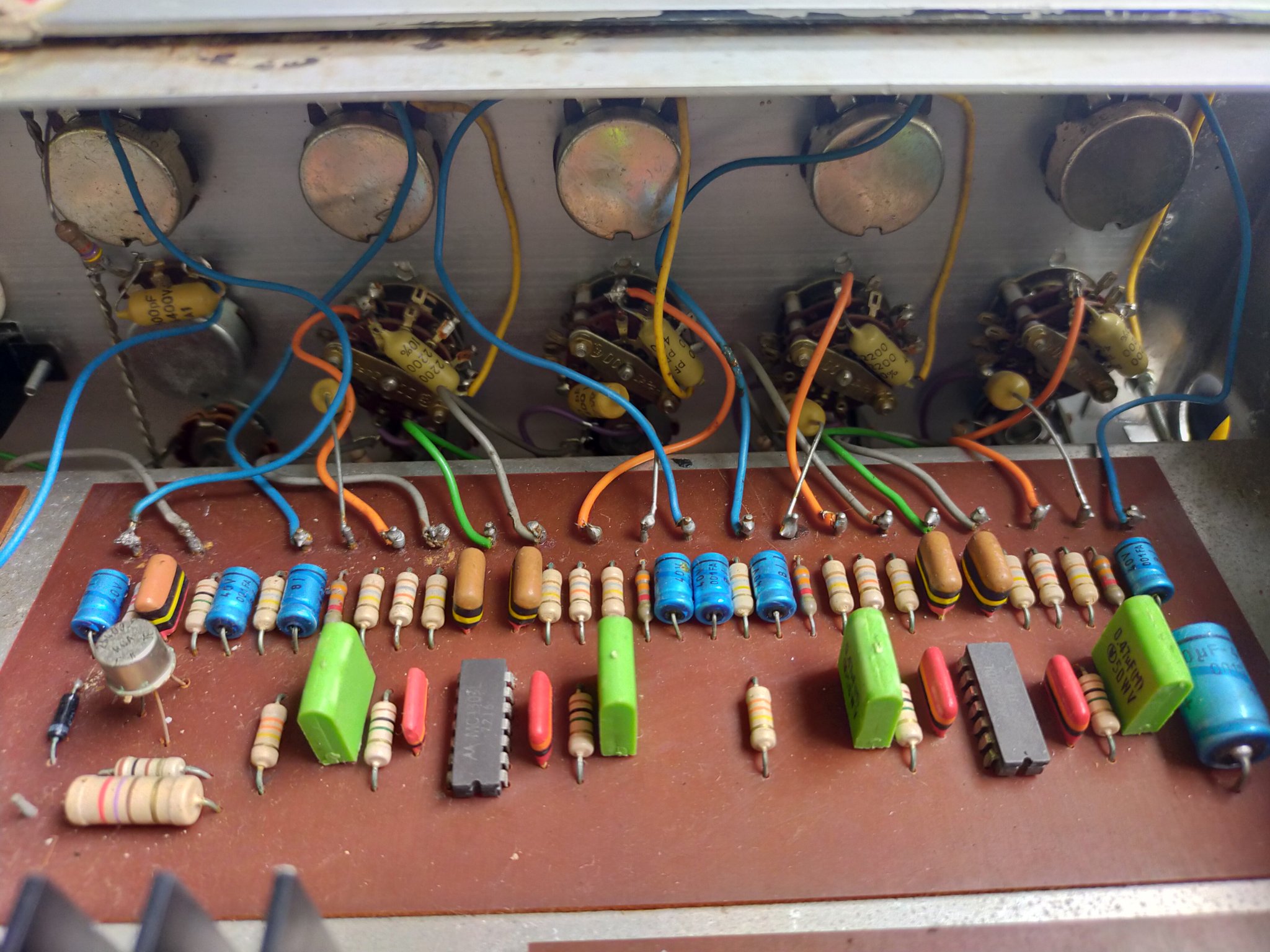

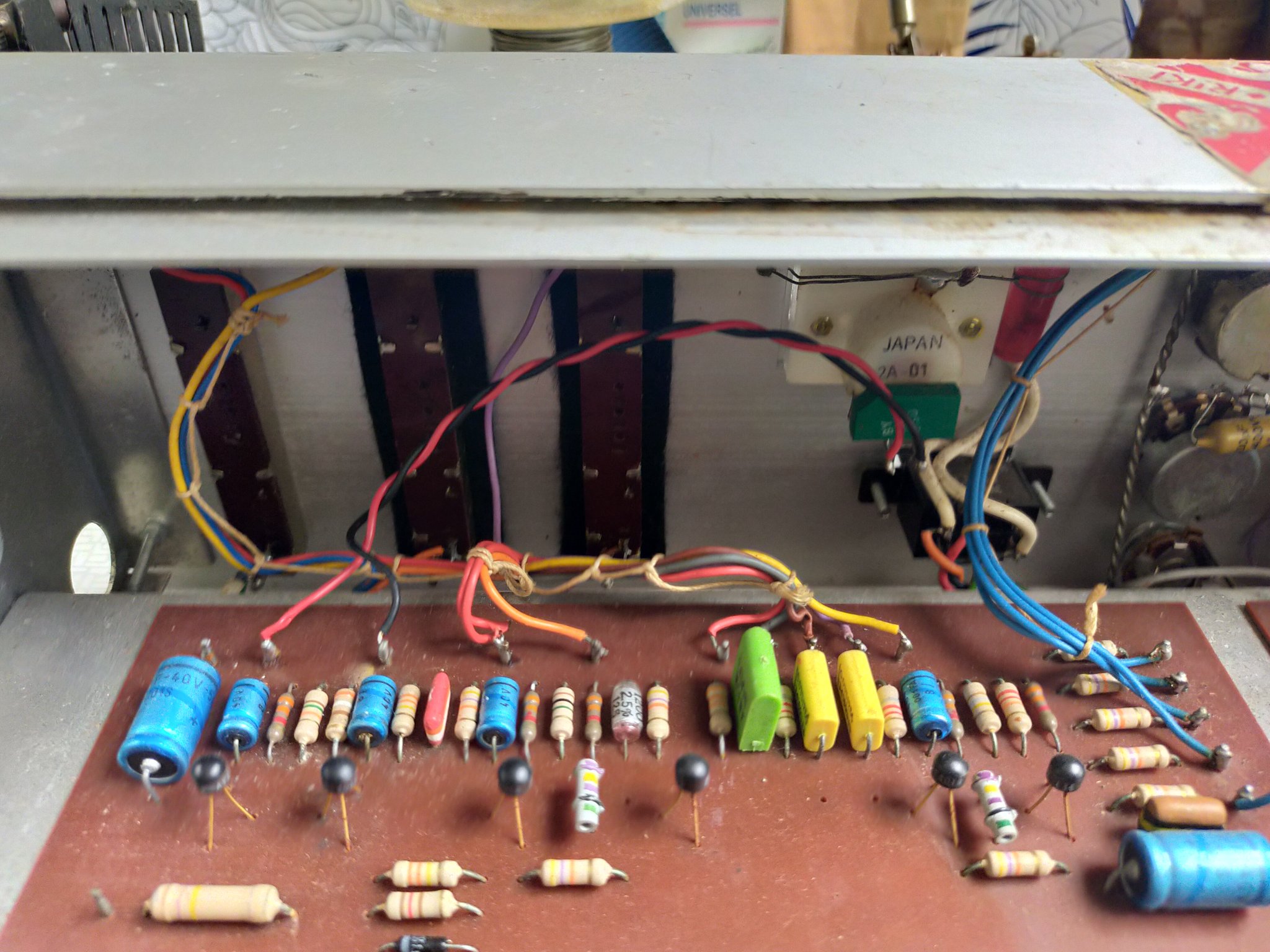

Here are a few photos of the different sections

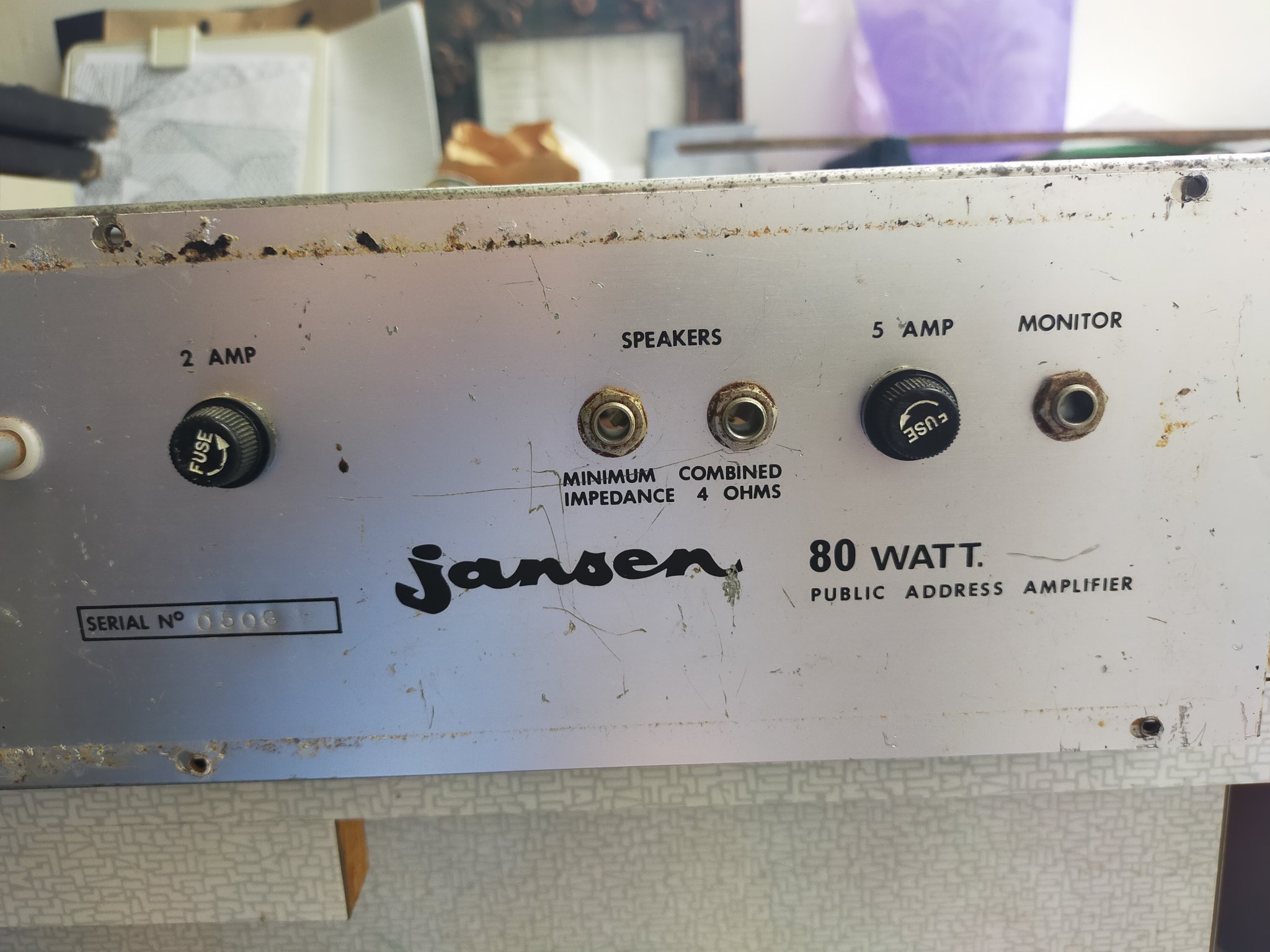

OMG, that is a really old one.
Instead of searching I would re-solder every joint.
Spray contacts, switches potentiometers with deoxide or 'WD40.
Check all elelectrolytics of SMALL size.
Small electrolytics are apparently from Phillips, these are quite reliable on the long term, not saying that they cant fail
after 50 years, but given the pics there s as much possibilities, if not more, than the problem comes from the potentiometers
or the switches, anyway the photos raise some nostalgy of another era.
Reactions: waimana

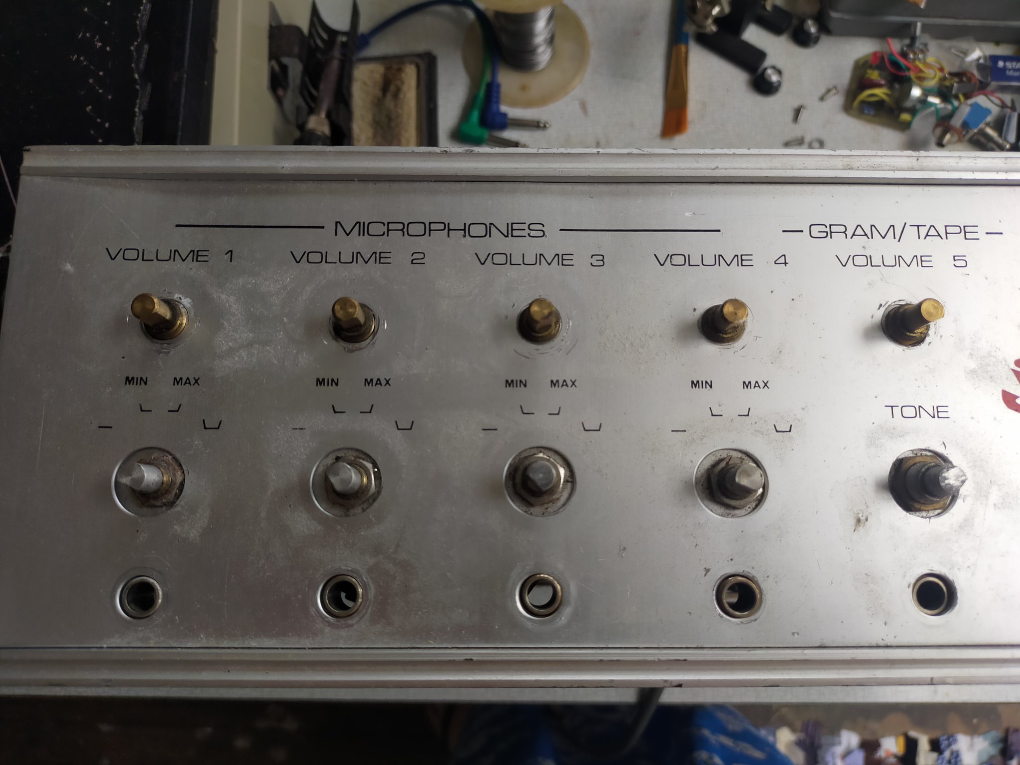

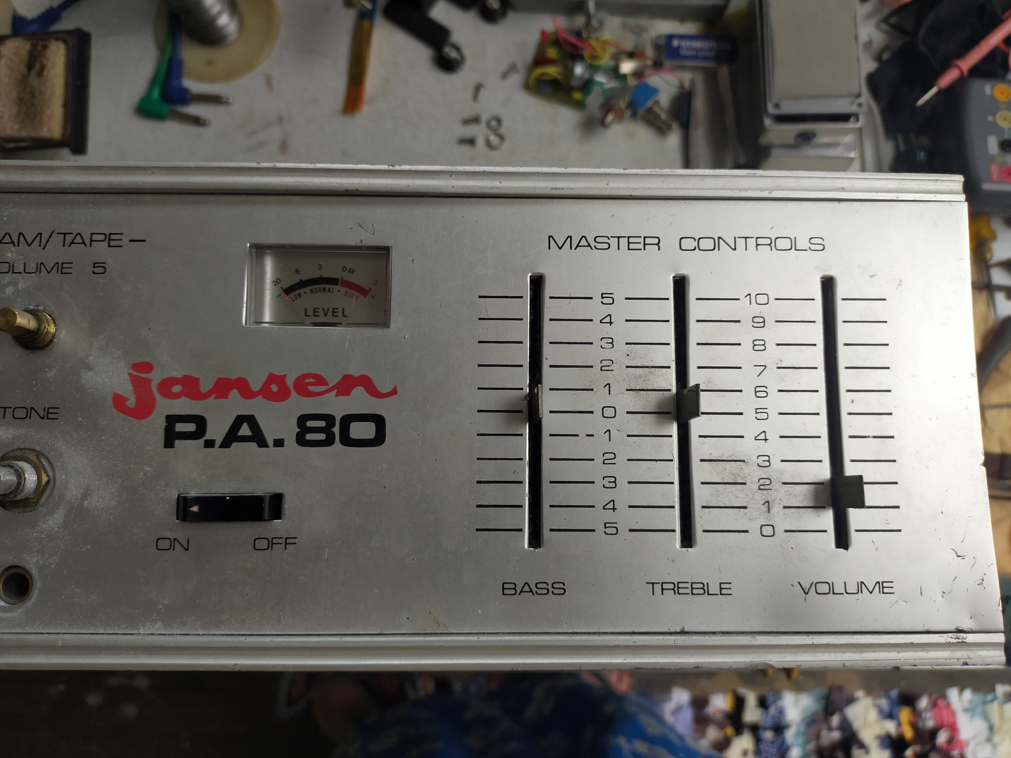

Tap all components and joints as suggested before, clean whatever was suggested, but your pictures add special suspects: those slider pots are open on the front, and tracks are fully exposed to dust, oxígeno and ambient humidity. Be specially careful cleaning them and you might have to replace a few.
I would be surprised if they do not crackle or have dead spots.

Will take sliders and pots out for cleaning as they are very scratchy

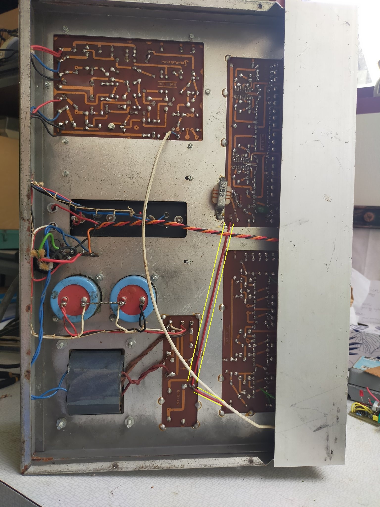

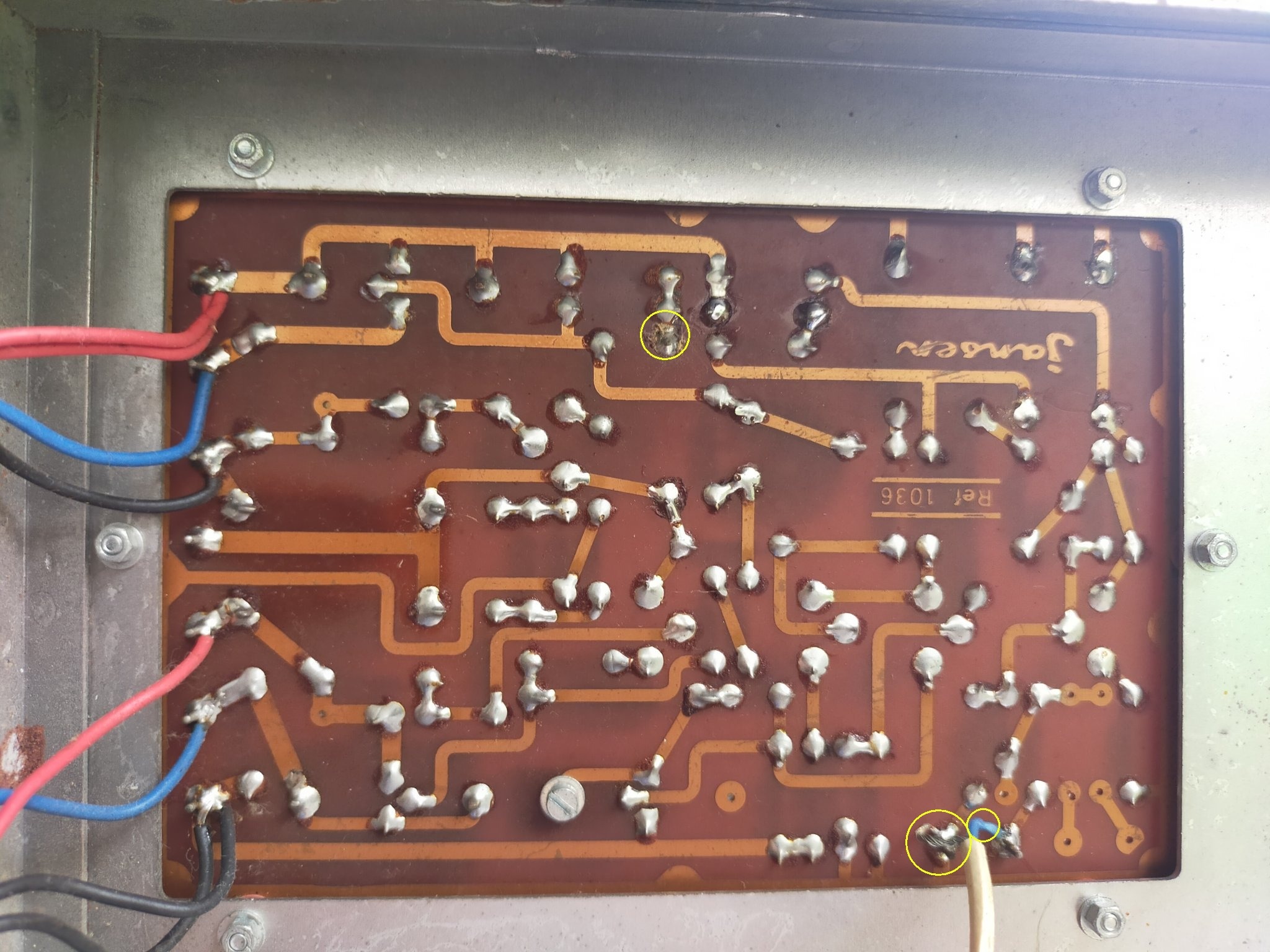

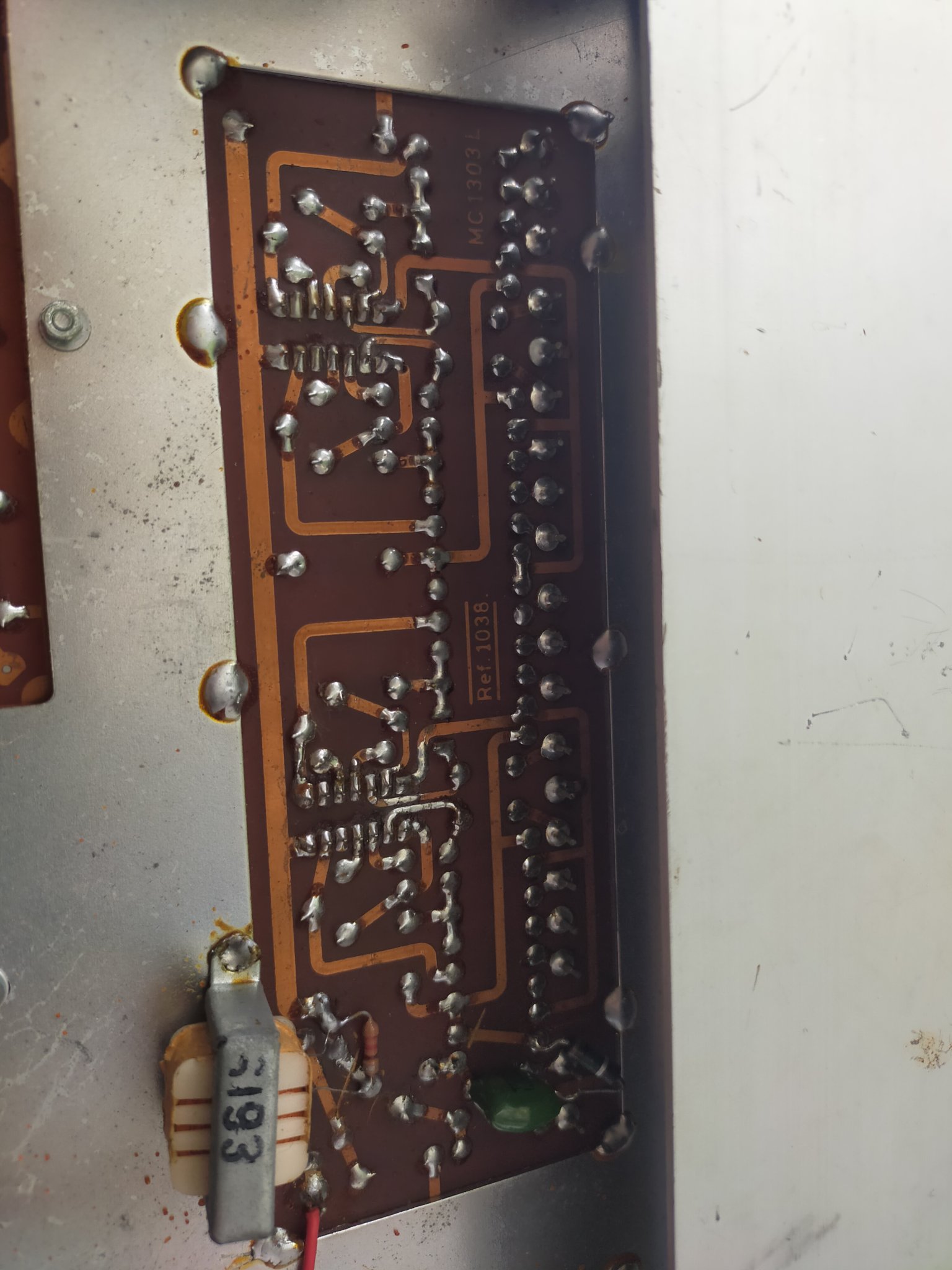

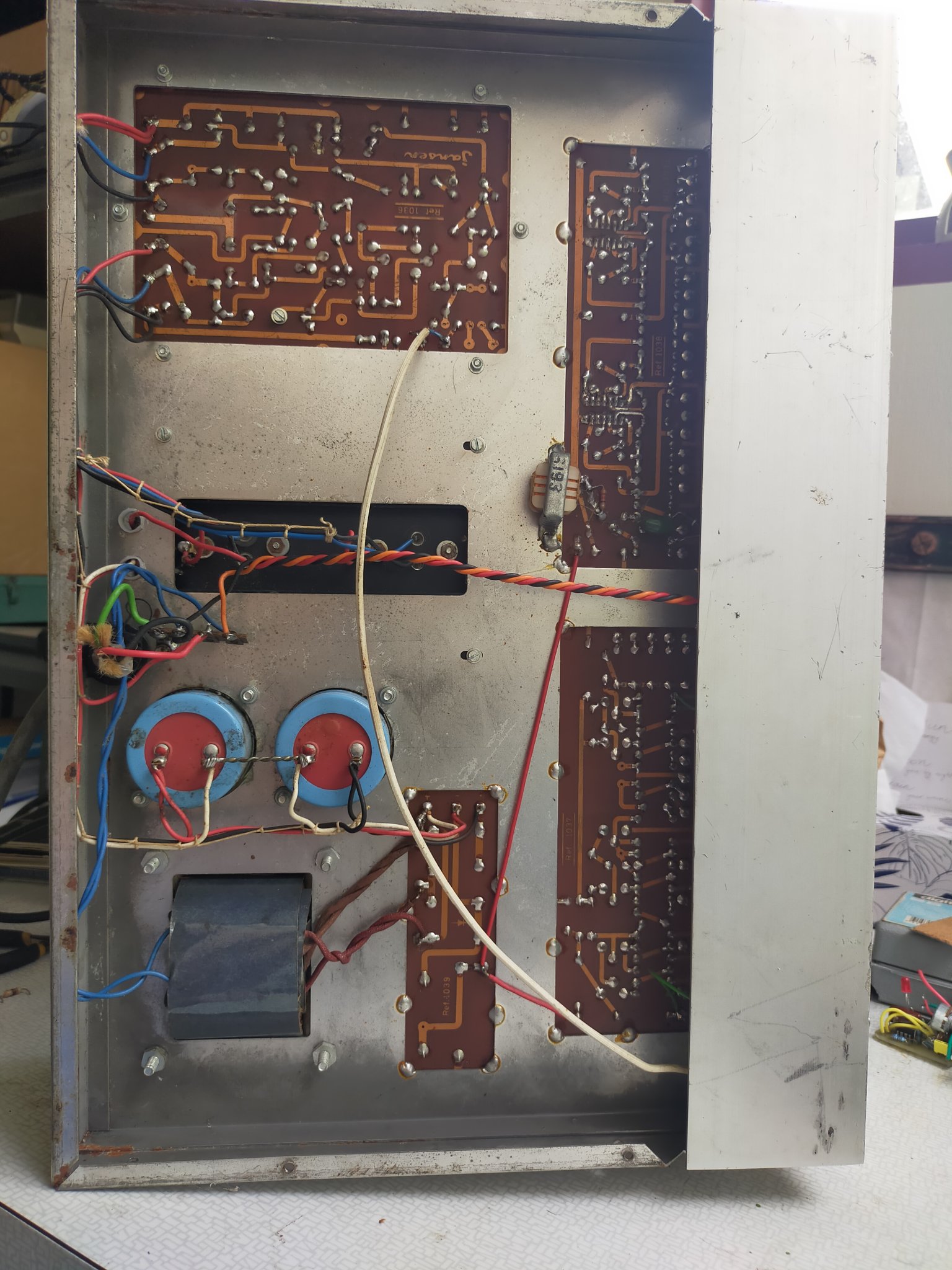

Here are some pics of the underside of the circuit boards:
Reactions: JMFahey

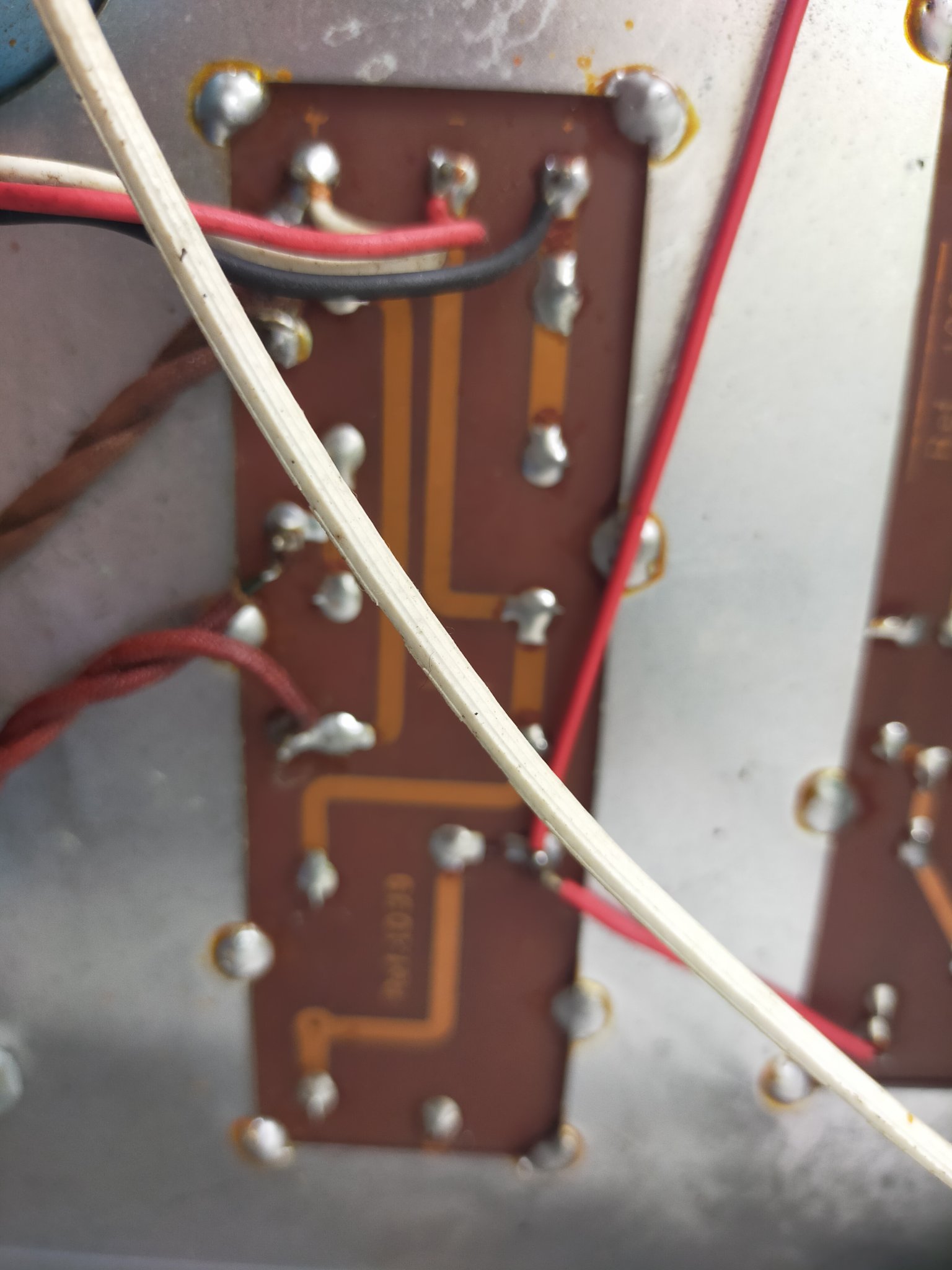

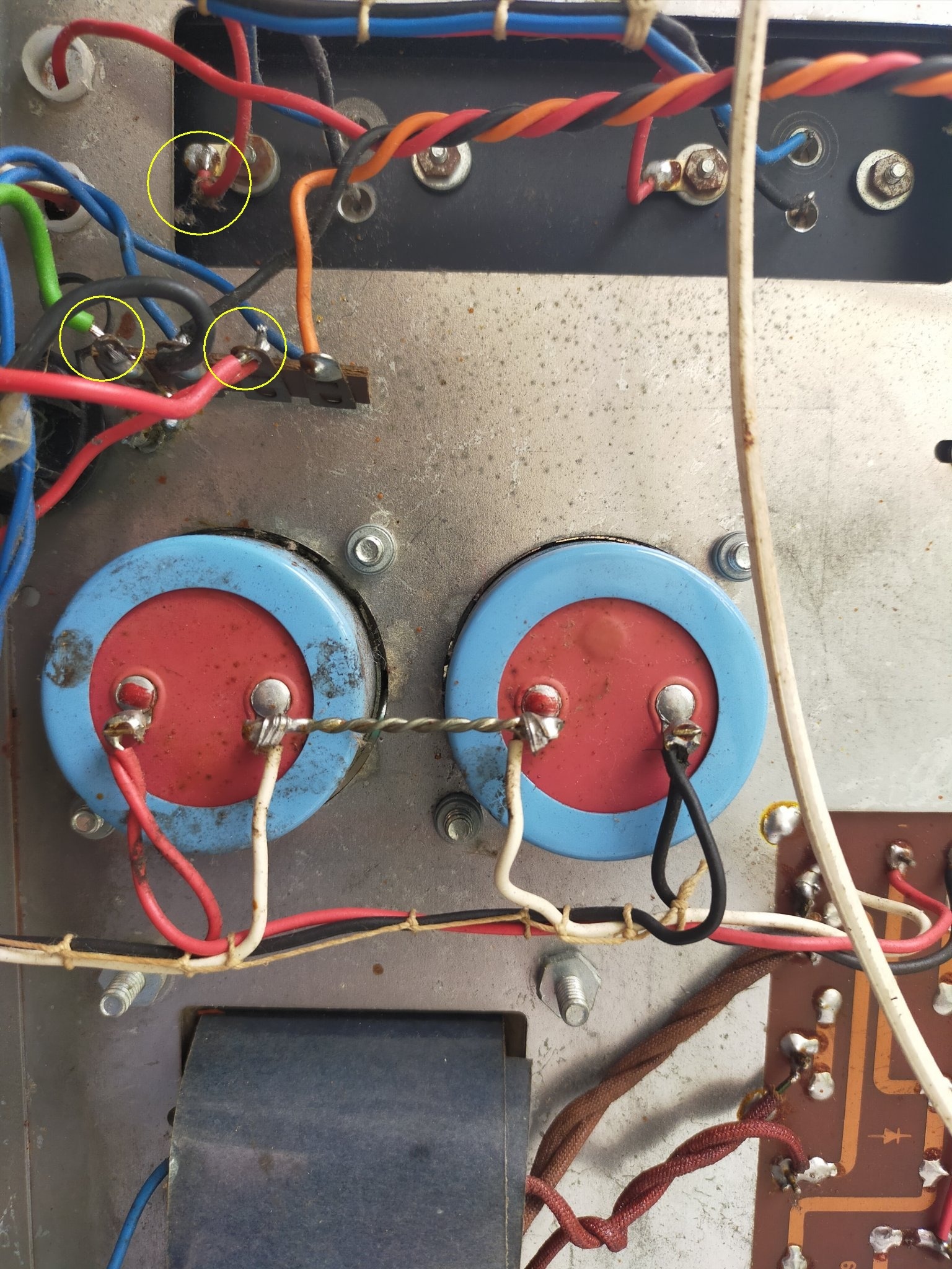

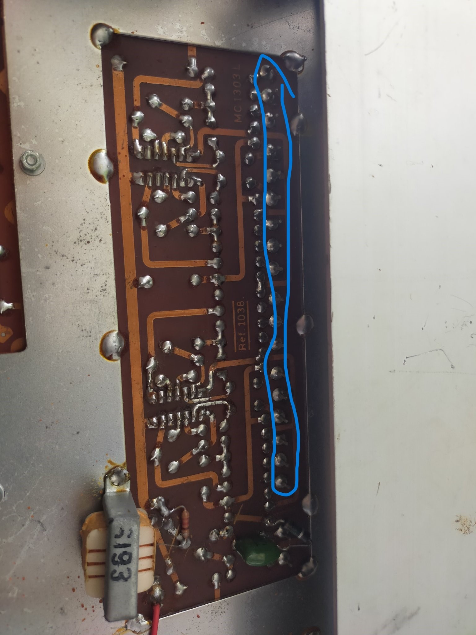

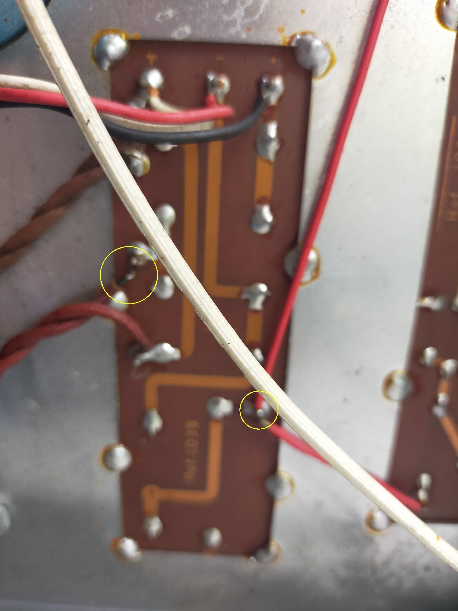

Just some joints to check.
Replace these stretched wires (yellow parallel lines).

Thanks everybody for all your advice, incredibly helpful and much appreciated 🙂
Intriguingly, after powering the amp off and on frequently as part of the problem-solving, both the volume problem and scratch/pop sounds have now disappeared. The amp seems a lot more stable powering up and off, and during use - is this a common occurrence in 70s SS amps after years of non-use?
The next presenting issue is the general noise floor - the background static is very noticeable, so any suggestions people have for improving the static noise floor would be great 🙂
