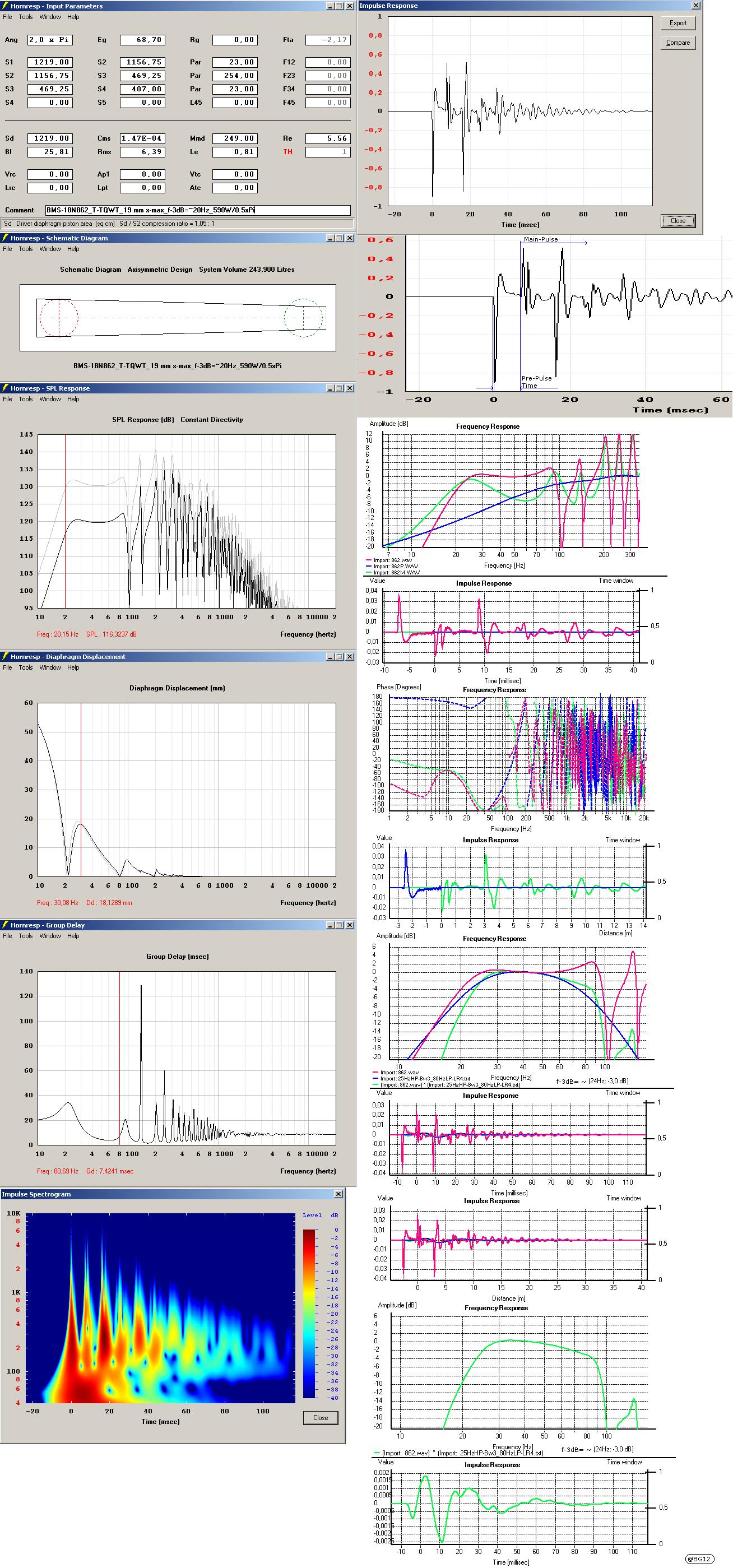

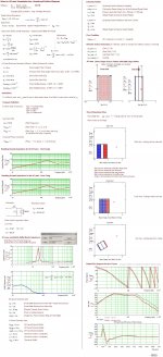

FYI,
Don't rule out low Qts low fs drivers(high BL),i.e. Drivers with a low Qes/ high Qms that have a mass roll-off = 2Fs/Qes at or above~160 as they are easily converted into high Qts by adding an appropriate series resistance.
This approach is especially useful when its possible to parallel more than two drivers making the series Qts altering resistance staying at a very low value,this when including a series inductance with a similar loss resistance.
Have a look at the submitted example picture where two (H-Frame) Ripole with 2xSd /front area = 2/1 slots are stacked vertically(stacking horizontally would even work better).
b🙂
PS: The in post# 2 suggested Pyle driver in Car action, Note the wiggling excursion..😱 It's a Duck driver!:

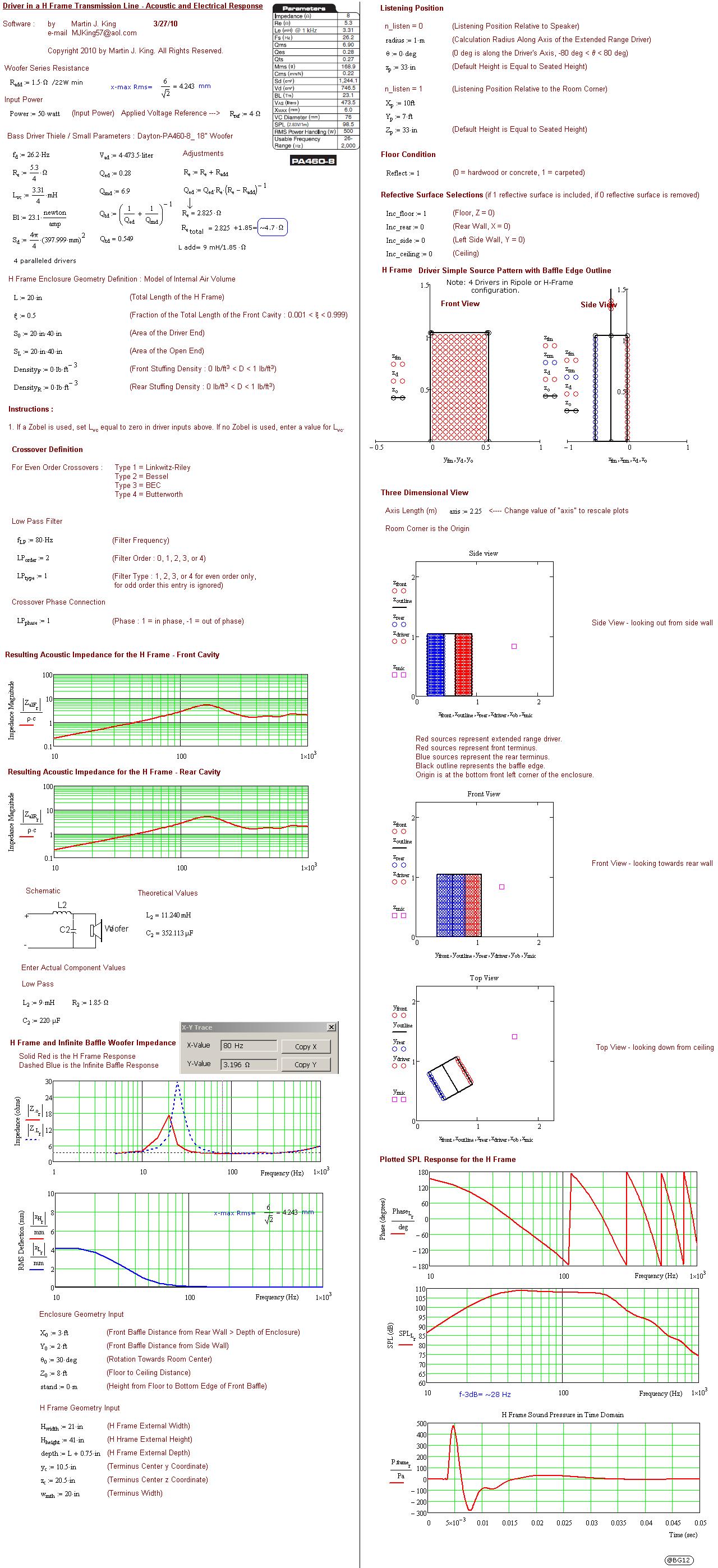

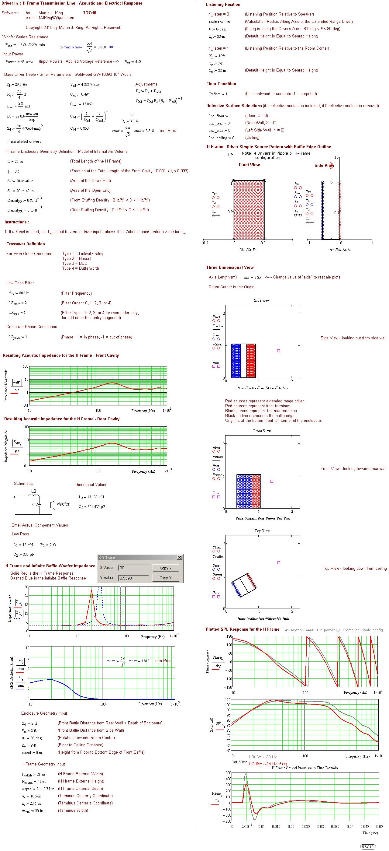

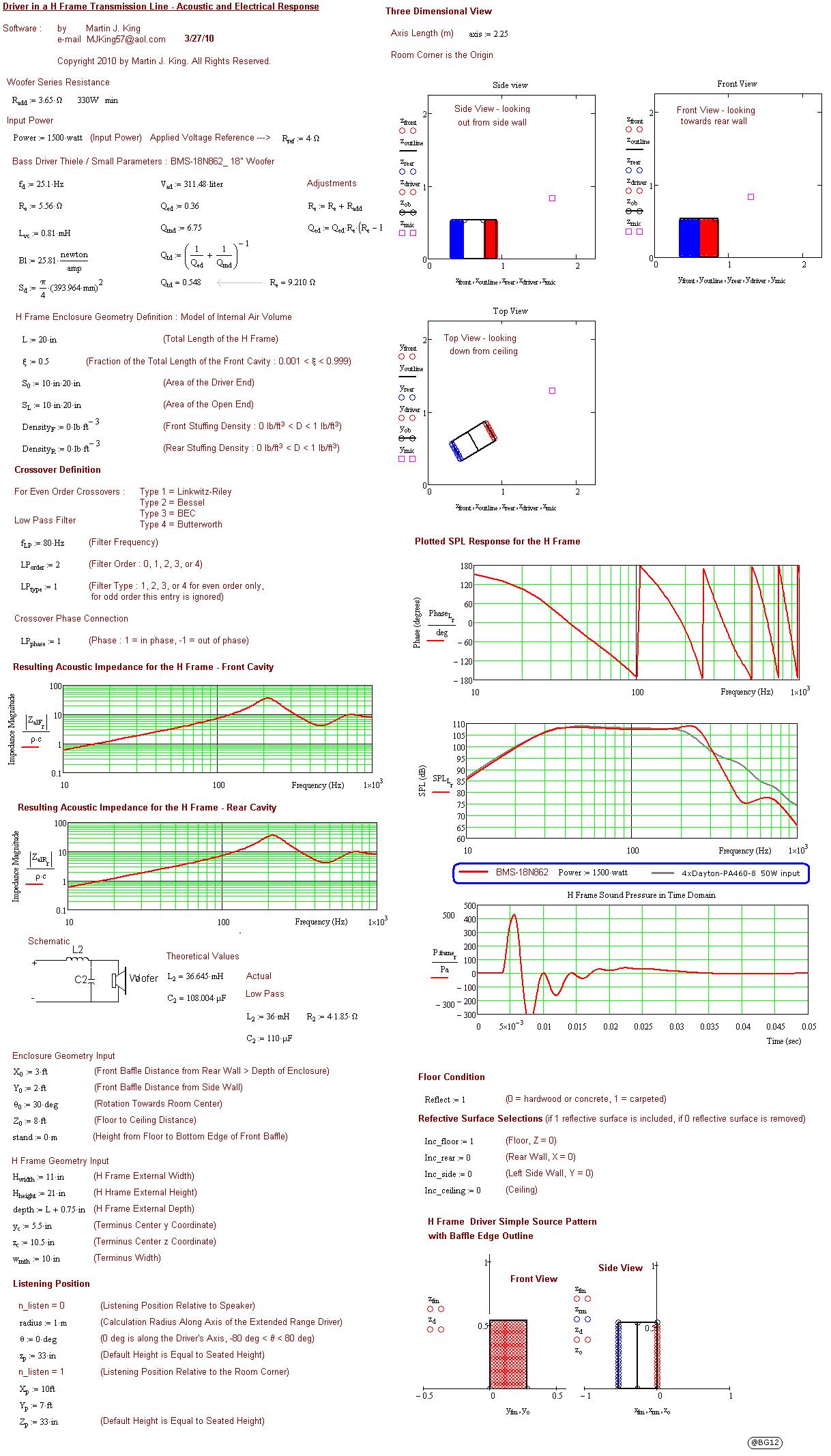

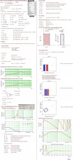

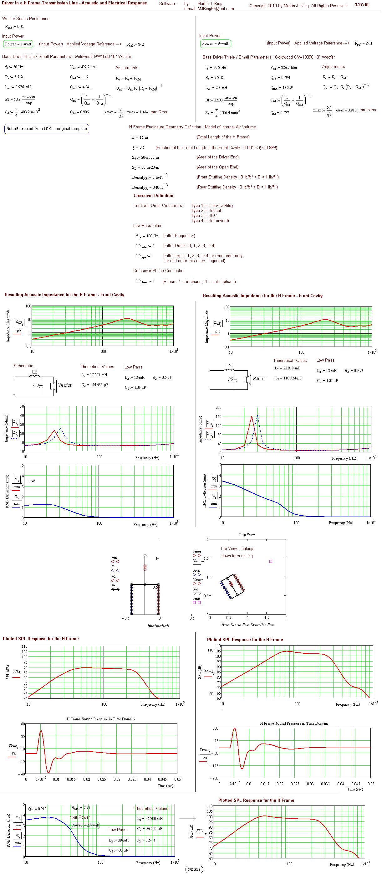

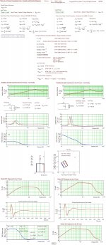

FYI, A couple of simulations you might be interested to study.
b🙂
b🙂
