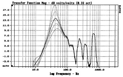

If you can get the in box driver resonance to match the design target
for the ABR (by adding cone mass very probably) then it will work.
Open circuit the Q of the ABR will be Qm, closed circuit Qe comes
into it, so you would be able to tune the ABR's effect see :
Sonus Faber Extrema loudspeaker | Stereophile.com
Fig.3 Sonus Faber Extrema, nearfield ABR response, 1/3-octave
smoothed, showing effect of LF Contour control (2dB/vertical div.).
rgds, sreten.
