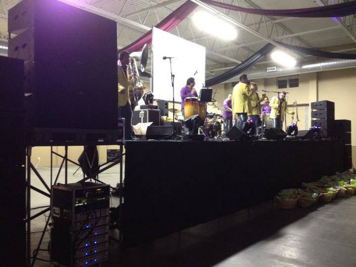

I play in a band music and sometimes I rent the sound systemfor insight and outside shows and I have face amps t2000let's say that I want to bill the best sound system for 5000 people,I'm selling all my sound system so I can have a brand new but I want to have the best I have a box truck to move them so it is no problem to move them,so on,you opinion guys what is the best box for those speakers?*
It's still Keystone in that case.

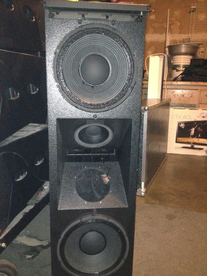

this is a picture of my sound system those are from company here and United States call TV I which is I don't like it and want to build different boxes but different story first I want to build the subs,I bend use before jbl subs they are good for close range any idea different boxes and where I can get those plans I'm new at this?😕
Hi javiert,
If size and weight are not a problem and you want to 'steer' the bass (directivity) max possible and with highest sensitivity/output figures, you can Google for "super bass horn - startec".
