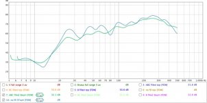

17 foot pipe sub 12-230 Hz ±5dB

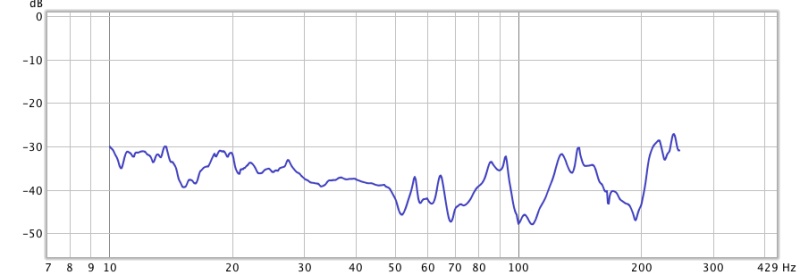

The sub has two parts, a base holding a 15-inch, 1965 Stephens 150W, and a 17x17x72-inch box mostly ¼ inch plywood weighing about 45 lbs, containing three tubes (with two abrupt bends) with sound exiting from the top.

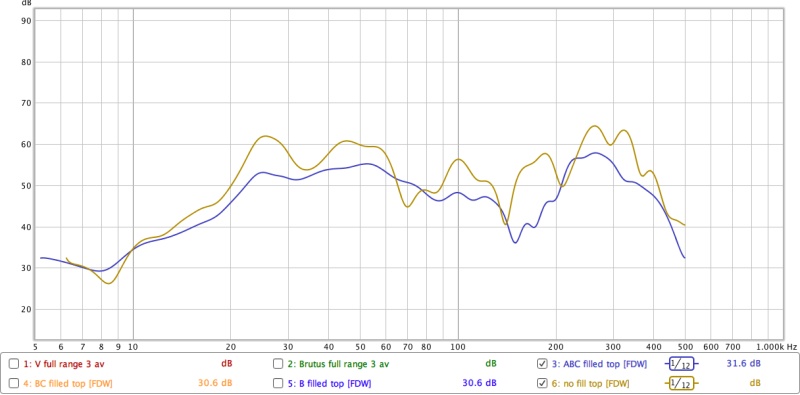

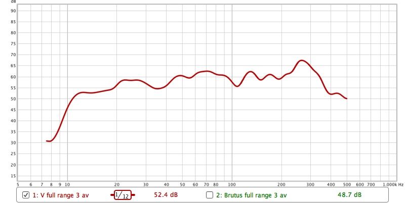

The first pix shows an average of 3 mic positions near my chair. No EQ or crossover filter. Can't say for sure if bottom bass is as it should measure, but that's 12-230 Hz ±5dB (which I ordinarily cross over around 130 Hz). Nice.

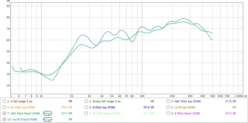

The second and third pix shows near field sound outputs at the driver and at top exit. In each, you see the very lightly absorbent versus final stuffed (roughly the familiar .5 lb per cu foot). You can see the weird pipe effects. Something's cooking at multiples of 8.5 Hz.

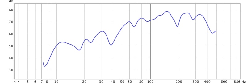

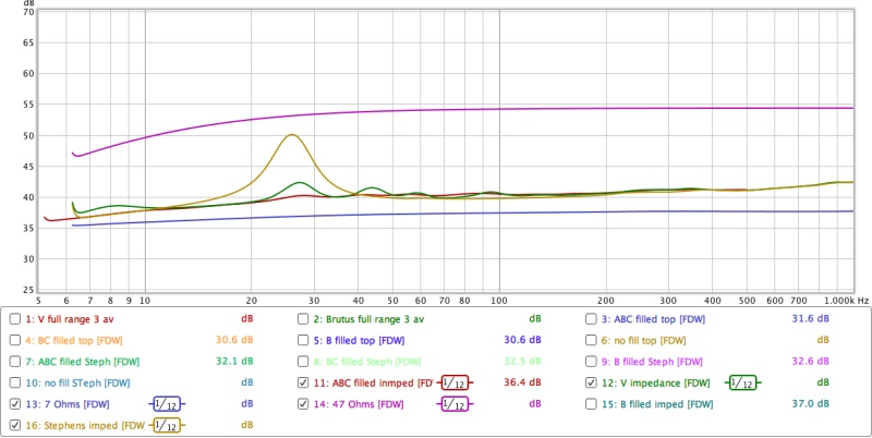

The fourth pix has five impedance curves. The top and bottom are 47- and 7-Ohm resistors to benchmark the curves. The big bump at 26 Hz is the free-air driver. The smaller bump is in the lightly stuffed. The all-but-flat final curve near the middle is the stuffed pipe.

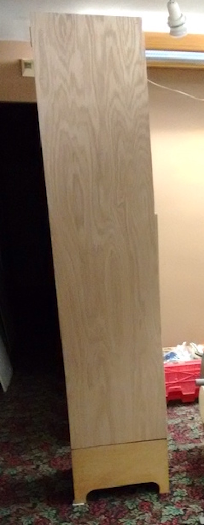

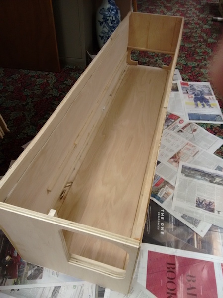

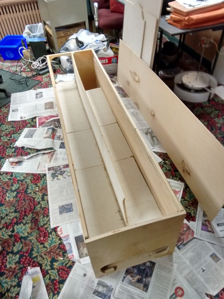

Some construction pix. You can see the exit port at the near end in the first pix and reversed in second pix. Yes, mostly ¼-inch plywood but with some strengthenings. The interior partitions are celotex which is a light-weight cellulose board with acoustic properties.

Using REW for measurement? Let's see what the THD looks like at 2.83V... 🙂
Thanks freddi and Brian Steele.
Mic placed near field sort of midway between the ends. About 90dBC at mic but ranges from 80 to 96 in the near field... long pipes are different. 2.8 volts.
BTW, I never work with REW calibrated since there are so many control points in the measurement path that touching any (like to keep the mic from overloading the mic pre-amp) destroys the calibration. So please ignore those axis numbers on mic charts.
The distortion results, presented in normalized-to-fundamental format, are pretty reasonable for a sub, esp. the low bass where you generally see worse than 10% figures (AKA -20dB) and unusual to see any that play anywhere as low. Must be that ¼-inch plywood construction or maybe I should firmly attach the pipe structure to the base... just sitting on it now.

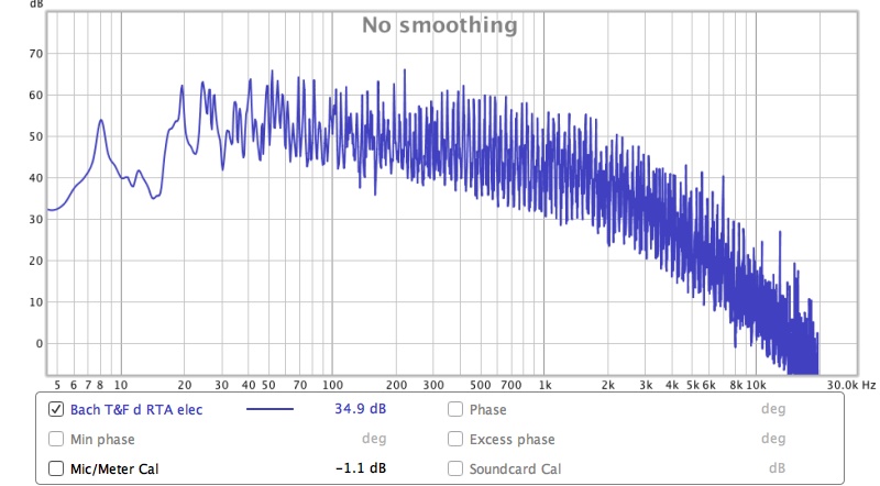

*ironically, electric RTA of this piece has very big peak at 40 Hz but some little rumbles at 12 and 18 Hz. Another good bass recording is Bach's old T&F in d, Murray/Organ Blaster, has substantial content below 30 Hz even below 20 Hz (see picture... you can see the individual pipes, eh). Anybody ever do an RTA of Dark Side of the Moon?

Four pieces, 18 x 72 inches or so. I used quarter-inch mahagonny-faced plywood. Make a base as in the picture. You need to divide the interior into three pipes of equal cross-section area. I used celotex a cellulose board with some sound absorbent qualities as the interior dividers.... and the odd piece of plywood for strength.
Fill the pipes with lots of pillow stuffing, medium-fluffy. I used rolls of fibreglass window screening formed into 6 foot long stretches with multiple pockets to hold the stuffing in place.
The key design goals were (a) a long labyrinth with (b) the driver and the exit door as far apart as possible and (c) with both benefiting from sitting in corners of the room (in my case, floor and ceiling).
