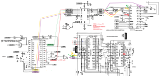

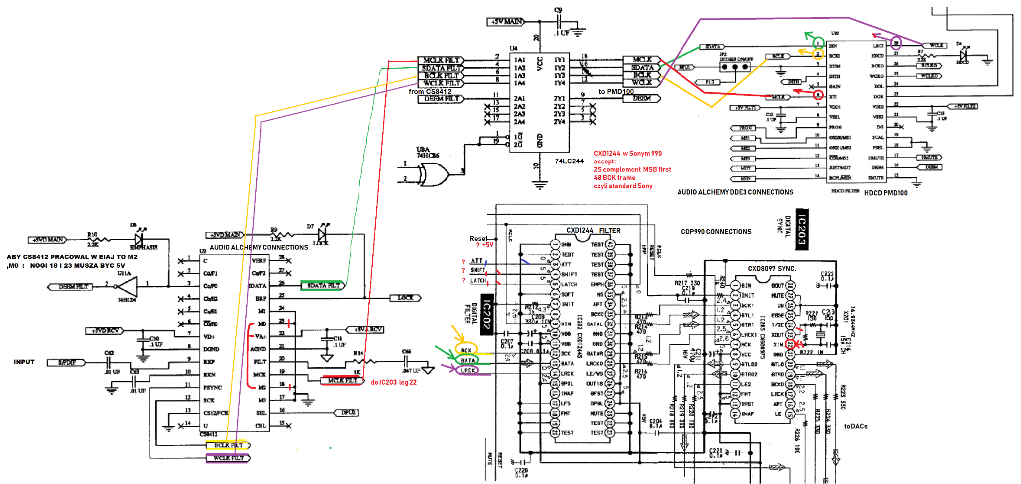

16x oversampling CS8412 at Sony ELAJ to CXD1244 to sync used inside CDP990
Case looks very simple but so far my small knowleage is not enought to make digital input to cdp 990 i use and connect CS8412 installed inside audio alchemy dde3 by remove pmc100 filter and wire to cxd1244 inside sony cdp990 how on picture. sony is made with tubes output with 16x oversampling and played that kills mark levinson current player so i need to add just some inputs but none of masterclock output from cs8412 conections variations what i try work . even not a noise. maybe i shoud config legs 1 to 9 to let cdx1244 work in stand alone mode? would you advice me pls. last config is that 16mhz clock is connected to cxd2500 and i play cd disc to let output transistors be unmute and filter be on but i can hear silence only. Would someone advice me pls.

Thank you very mutch for replay..but i have to ask again.If i change M0 ... M3 config for Sony Eiaj.. will it resolve problem or cs8412 is not compatible with 384 48fs?
Also I was try audio alchemy dde 3.0 regular original inputs and i removed PMD100 and still signal from there but were i should connect master clock signal? Is pmd100 input compatible with cdx1244 if pmd100 specs says output is left justed 2s compatible.
The Sony format has 48 bit L/R frames and the CS8412 does not. The CXD1244 also needs MCLK at 384Fs and the CS8412 will only do 256Fs. The two are not compatible without work. It would be best to start with something else but whatever you do there will be a need for work in the form of glue logic of some kind.
They are not compatible.
