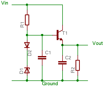

How clean does the regulated voltage have to be? Why does everyone always overlook the very simple but effective emitter follower with a zener reference? To get the 16V output you can put a regular diode in series with a 16V zener to get about 16.5-16.7V at the base of the NPN transistor. Alternatively, you could use the base-emitter junction of another transistor of the same type that is used as the pass element as the diode in series with the zener to get a more closely matched voltage.

Hi Panicos,
I recieved the circuit diagram,pictures and i'm very thankful to you.I have some queries about the circuit diagram,please clarify.
1.Can i use my transformer 12-0-12 for this power supply?
2.what is the output voltage of this circuit?
3.will you please suggest fixed value resistors instead of variable resistors to get 16volts at the output?
Please clarify.

Sunny, 1)Yes you can use your transformer,just use the two 12V wires to get 24V to the AC input of the board, 2)for the 16vdc you want R2 should be around 2K9. R1 is almost standard at 240R. 3)Output of this circuit depends on the chosen R2 value and the transformer used.By following the formula you can easily calculate R2 and therefore DC output. Vout=(1+R2/R1). Make sure that your transformer can deliever 3A. If you'll follow the circuit I sent you,provide enough space for the rectifier to be used,as the space on my board is for W02 rectifier which is rather small.If you need any further I'm here.
HelloPanicos,
I have calculated the value of R2 as per the formula and the R2 value is 3.6K and still i have some questions ,please clarify.
1.What should be the wattage of R1 ?Can i use 5% tolerence resistor?
2.Please suggest one fixed standard value resistor for R2 and its wattage and tolorence.
Waiting for your reply.

sunny,your calculation of 3K6 for R2 is correct.The same current that flows through R1 also flows through R2.So for the 16vdc you require,R2 should be 3K6,and R1 240R.You could use 5% tolerance but I'd prefer 1%metal film types,0.6 to 0.8W should be ok.Cheers.
