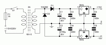

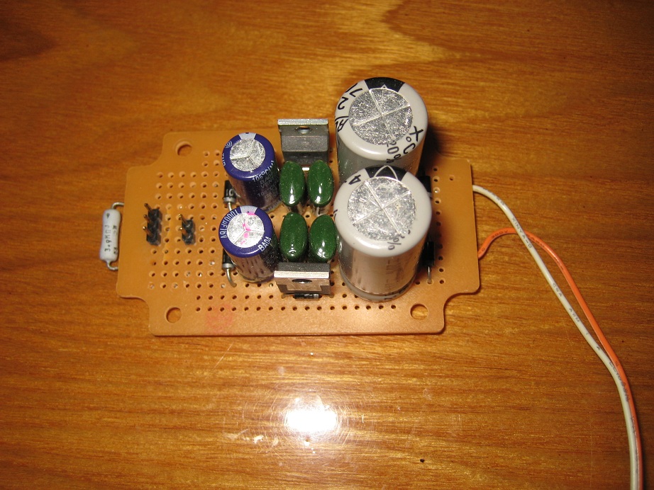

Could someone please send me a link to schematics? I recently put together a supply with LM317, LM337 for +/- 15VDC but I want to make similar but fixed supply with 7815 and 7915. I only require about 1 ampere. My transformer is not center tapped. It has been working ok with my adustablle regulators.
Voltage Doubler
without center tapped trafo you will need to use voltage doubler configuration.
schematic attached.
You should be able to use 1/2 wave rectifiers for this rather than a bridge,
thus having two voltages referenced to ground.
At any rate, 38 volts is more than enough for even a full wave bridge, no need for a doubler.
