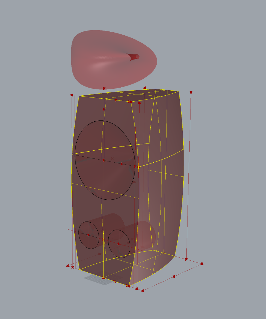

The utlimate plan is to build one 2way for me with WAF approved cabinet 🙂, so CNC curvy and slim to crate the illusion of less volume, and for a friend without a WAF a lascala bassbin with the extra BR under it (not referred in the thread).
Im looking for efficiency as I want to be able to power it with low watts too. 'hifi' quality as much as possible. My listening is not high SPL, usually 70 to 85? Also I always wanted to do a classic 15in+horn 🙂 mainly with a 2226h.

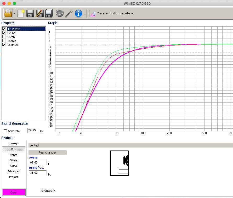

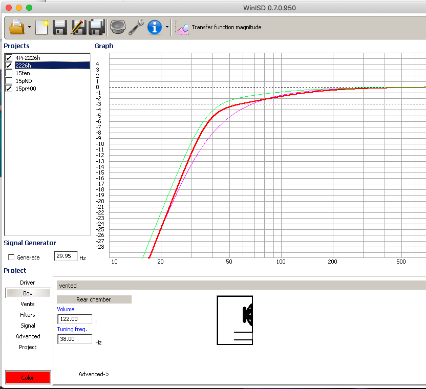

for the 2226h I started with the recommendation below to test in WinISD and I recreated 4Pi in CAD so I can measure the volume and compare with the published response graphs. (cab in the sims is C4/SC4)
GM said:
For max efficiency Vs size, BW, the pioneer's reflex alignment Vas/1.44 tuned to Fs. Using published Vas, Fs, HR predicts a mean eff. from 40-200 Hz of 98.23 dB/m/2pi/89 Hz and only dropping to 97 dB with 4 ohms output impedance.
GM
So questions:

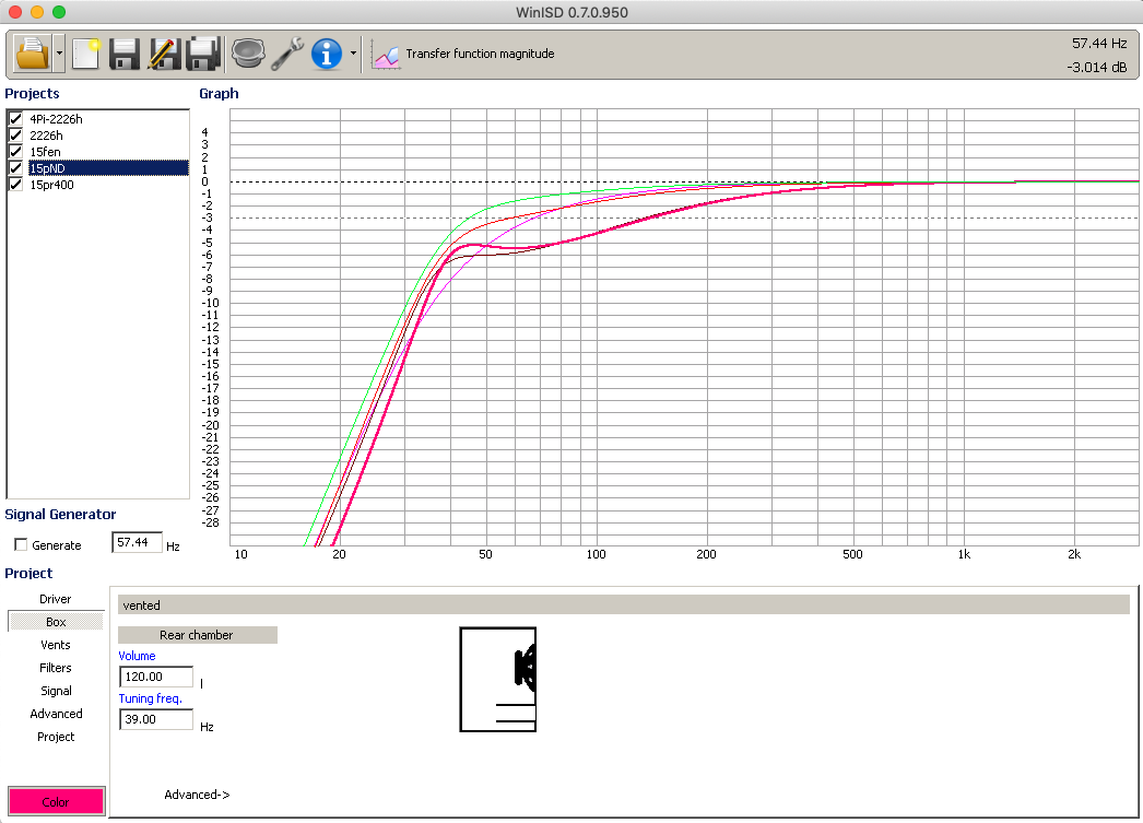

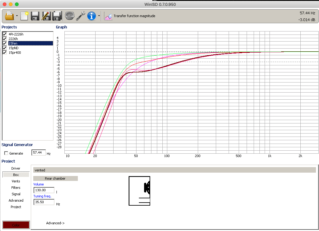

1) How does this look? I compared it to other LF drivers I see in builds here and Im not sure about the low end, I now 2226h is not a low end driver per se but its one of the popular choices for low end.
Images attached. I manipulated volume and tuning a bit on the other drives to see what I get for comparison. all around 120-135L I believe but I think Beymas need more.
2) What should I expect when seeing simulations like these? (for all I found workable BR sizes and vent speeds etc)
3) Do you consider the other options (Beyma etc) to be better for sound quality as its newer tech etc? Any other pointers? (the simulated models are 15P80feN/ND)

PS: I attached a cad or the design I thinking (internal volume without braces etc.. very draft and propably not the correct volume with the above but close to 130L clean internal) The horn is just a placeholder! Random model. I have access to super workshop/CNC so sides will be full CNC probably.
Get the 2226 datasheet from JBL (first search response) and you'll find they tune to 40Hz in 140L net.
If you're going active then you can do 6th order ported in about 40L. I've used this alignment in my home and PA units and it's excellent. Will post more if you're interested next week.
I've owned lots of 2225/6 units and they're great.
1) I'd love to know more when you have time. Im not currently fixed to the 2226h if there are other alternatives.
2) The design I aim is something like the images I had in my first post, if possible. WAF approval is needed and a 6th order box is out of the question!! 🙂
3) Im aiming for a passive system. no active XO etc.
4) the 2226h simulations are with 38hz tuning similar to the 4Pi.

Reviewing "Beyma designs from 2008/2009" there is a 15p80nd + CP755ti that looks good.
Anyone with experience from 15P80s? or maybe comparison?

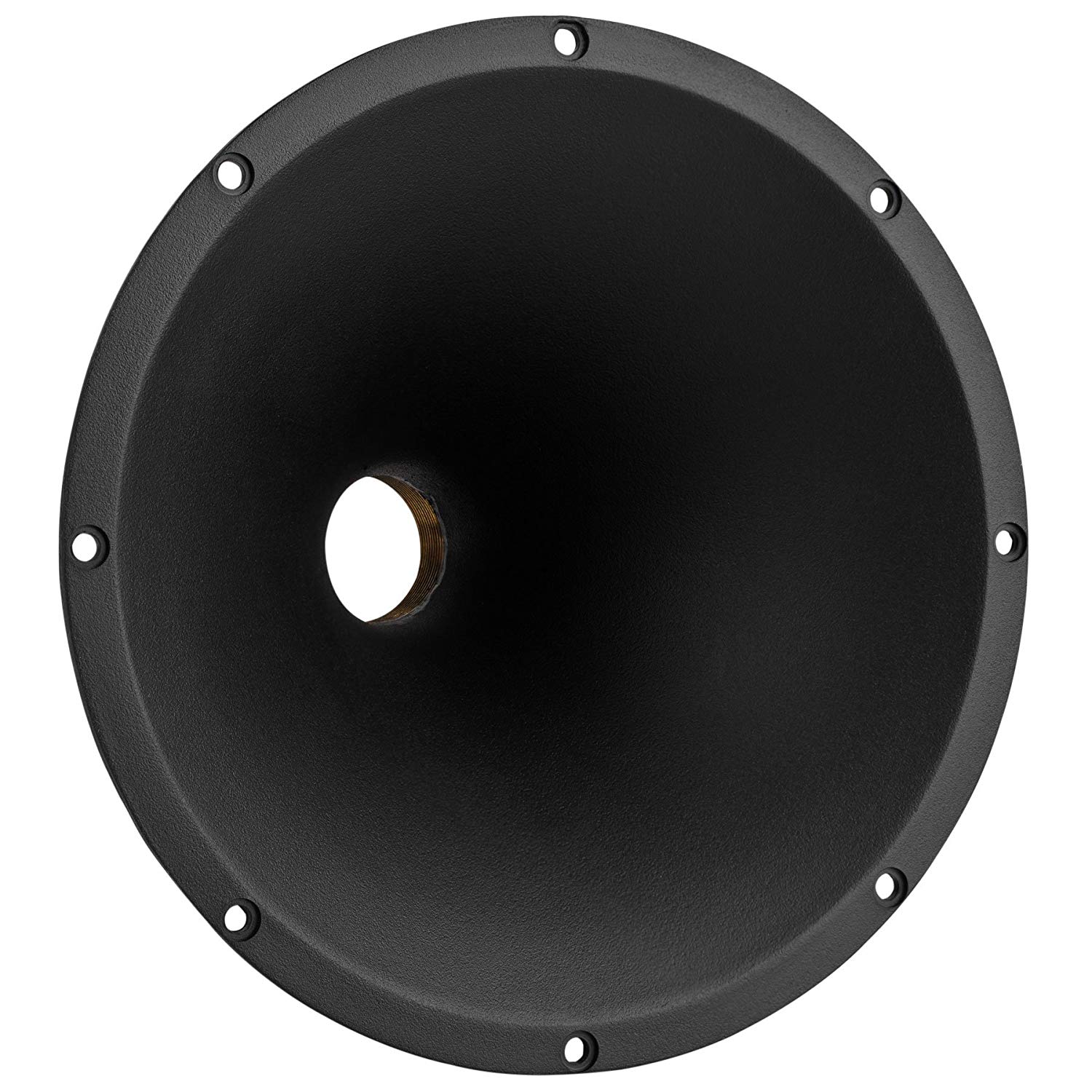

Regular would I guess be round, 45 degrees and at least the same size as the woofer. That way, its behaviour is similar at all frequencies and matches the woofer at one frequency. The horn is capable of reaching down to that frequency.
Other horns might work reasonably, some will not be as successful.
Got it! Thanks.
I could probably CNC a round one to test. Even though they tend to be thick and bulky for construction reasons.
I need to model something in 3d and see.
Of the shelf one I read good things about RCF 950 for example.
Some also mention the 18sound XT1464. In fairness, the result is probably not that bad. I mean, the first waveguide I bought was the Dayton 8" pictured. It was a flimsy screw in type, but it sounded very good. Once I became accustomed to the sound and made measurements I found that it wasn't performing low enough or matching well with the woofer. So I began to make my own.

There are some nice looking RCF 1.4in horns that seem to have a good angle.
Ive seen recommendations for them in another post.
Maybe a FaitalPro 1.4in + a horn like this crossed @1k with a 2226h? or Bayma 15p80nd?
The more you choose a narrow angle, the more its size becomes a limitation. You will end up with narrow highs and wide upper mids. For this reason a short vertical will overtake a wider horizontal and flip the pattern.
I'm not suggesting you use something like the Dayton I showed above, but understand, that it makes best use of the space it takes up and It doesn't try to start holding a directivity that it can't finish. Instead it hands off continuously within its limits.
