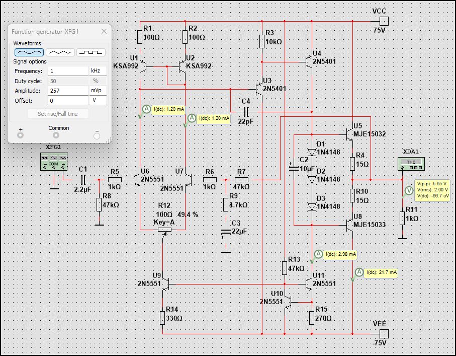

This discrete opamp can work in 150V or +/-75V.
The output works in Class A biased 20mA.
The distortion is very low.
The transistors used can all be found at Mouser.

Now, I have added a cap. 10pF. Maybe should be more.
The gain at image is x11.

Now, the question is what to use this opamp for.
I can think of using it in a single high power supply for regulating the supply rail.
This would be in a valves/tubes amplifier.
The use is not only for very high voltages.
It can work down to 20V or so.

That yields into a dynamic (approx) 1.352mW @ 8Ω pure class A.The output works in Class A biased 20mA.
[ (2*20mA^ / 2*√2)^2 * 8Ω ]
Don't turn the volume pot to much over 7 o'clock, or the cross switching distortion kicks in.
(D1 -- 3 / U5--U8)

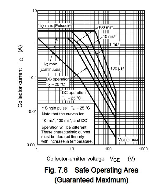

150V is too much for the 2N5401/5551 VAS and its CCS wich dissipate 0.225W each while R13 take 0.45W,
also the VAS driver has no current limitation and 10k is too high to neuter the VAS parasistic ICB current,
the whole is a recipe for a disaster.

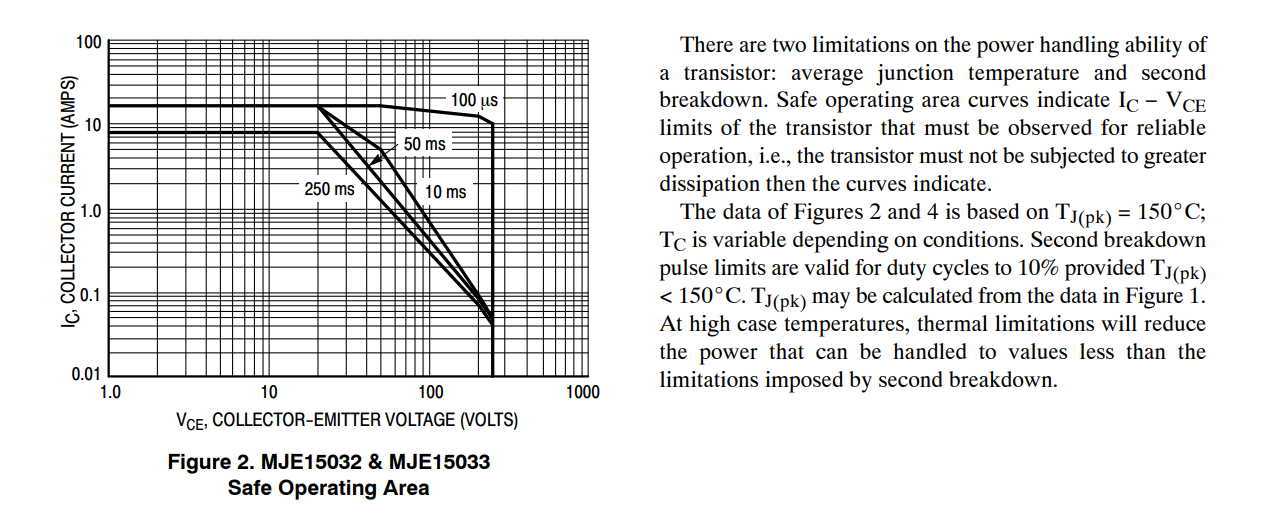

So it will act just like an IC op amp. No margin for overvoltage. Run it on regulated +/-75V and it’s right at Vceo rating, go to +/-80 and poof. Maybe. The other important spec: Output short circuit duration: zero.
Maybe compromise and make the whole damn thing out of A1381/C3503, except the MJE15032/3 pair.
