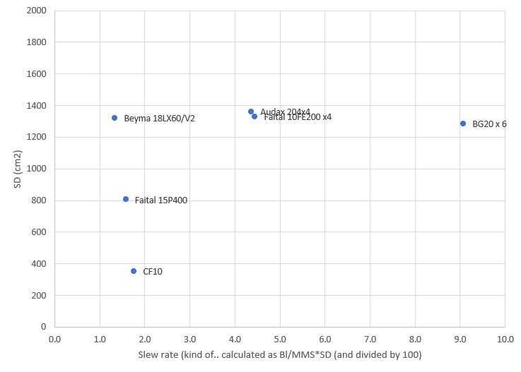

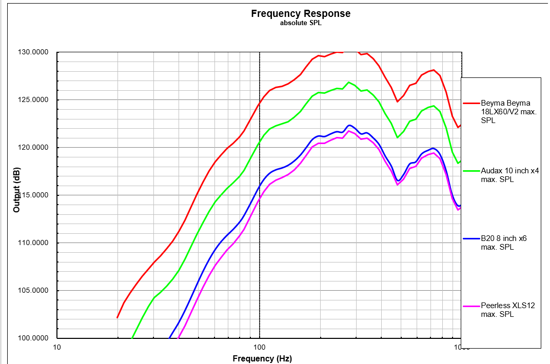

To illustrate the point i have added the room response curves and a kind of a slew rate calculation for an assortment of drivers.

Heavy cones...
First, consider the motor force/mass ratio instead of the mass alone. Ah you did... but:
Second, consider that you might want the cone to act as a piston and not break up.
Third, what do you think a lowpass filter does with ‘slew rate’?
And I probably forget some things, like Vd and thermal behavior.
Think rational, don’t focus on irrelevant aspects.
[edit] really, check the Vd of both options. You need sixteen Visatons, not six.

Thank you for the comment.
Here and there people swear by having drivers with light cones. Seemingly not just for midrange and higher, but also midbass. Claims such as "15 inches below 80gr os a must".
Low pass certainly adds about 1ms of group delay, which apparently is not audible in the lower midrange. And yes, this does beg the question whether one could then hear the difference in slew rate.
Maybe someone knows an AES paper or smth discussing the "speed" or slew rate acceptable or audible at certain frequencies.

Thank you for this link! The nifty "accelerometer" on Hornresponse makes the essence and impact of the slew rate rather clear - it essentially translates to efficiency/sensitivity. Since i have no qualms about using chip amps for the bass region, this does not make that much of a difference.
I made a quick calculation of moving mass vs the combined weight of speakers and baffle. It is ~0.7%. One of the questions now is wether to do "Wharferdale" and leave a cavity for sand between the plywood layers. Might do that for the cool factor and resonance damping anyways.
I think an array of smaller drivers can be advantageous. Apart from getting all things equal (that is certainly not the case with the beyma and the visatons mentioned) it opens up possibilities to influence the modal sound field in you room, whereas a single driver doesn’t. Arranging them in a vertical line e.g. reduces floor-ceiling resonances. In free field conditions (but that is largely irrelevant in normal rooms with these frequency ranges) the directivity of the system can also be controlled by spacing the drivers.
So, multiple drivers have their advantages, but not in slew rate. Or whatever. We have tweeters for slew rate. And you still need at least sixteen BG20’s to get anywhere near the output capabilities of the Beyma...

Double 12" like the Beyma 12BR70 is not *that* far away from the displacement of a single 18", and with the 8mm xmax I think it should be adequate for most livingroom scenarios.
Double 10" is ca 700cm2
vs
Single 15" ca 855cm2
vs
Double 12" ca 1080cm2
vs
Single 18" ca 1250cm2
vs
Double 15" ca 1710cm2
vs
Single 21" ca 1730cm2
Probably a good idea to add a HP filter around 30hz anyway. But then you might as well make a decent BR box instead, because of added group delay from low frequency filters...
Edit2:
I'd pick 12"s or 15"s any day over 10"s, 18"s and 21"s.
Because it's easier to find drivers that are cheap, have a good displacement (sd+xmax) and useable parameters.
Get more for the money using double 15"s IMO.

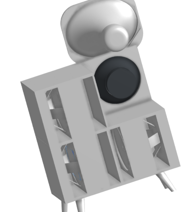

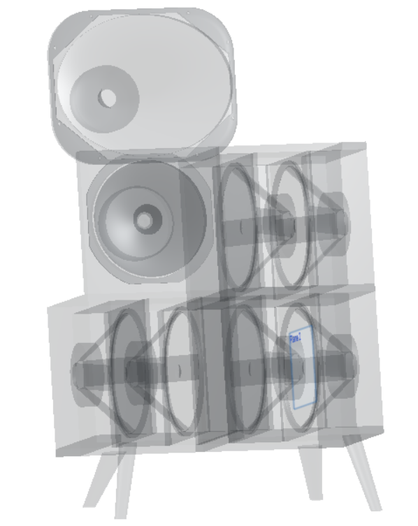

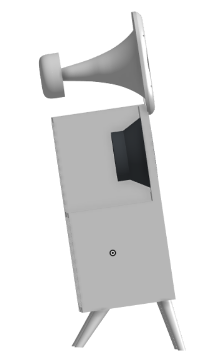

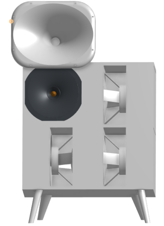

So I gobbled together a sketch. If I manage to add some proper design, I may be able to "sell" it to the better half. The box is 285 mm deep and almost exactly 570mm square. Its a little bit fat, but with the feet and being tilted back it may have some retro appeal when covered up nicely. The horn will also need something around it to look halfway nice.
There is one major unknown - the midrange being boxed in on 2 sides to the tune of 255 millimetres. That is a quarter wavelength at ~350 Hz and half the wavelength at 700 Hz, with the midrange covering 150 - 600 Hz i am not sure this would be quite invisible to the rear wave, but again, I have no idea if there is an audible effect .

The issue with those is that they are visually "difficult". Stacking them can work, but i need 60-70cm of path difference for the midrange as without that i would need to apply eq right at the crossover point, which messes up the phase.
Another issue is the resonance point of W-Frames/RiPoles, which is equal to quarter of the wavelength of the slot depth. With 10" drivers that would be around 350 Hz. Managed digitally this should not be too bad for a 150Hz crossover.
