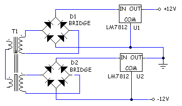

With a dual-rail supply from a centre-tapped or dual-secondary transformer it's usual to connect the mid-point (or an appropriate end from each secondary) to ground, which becomes our 0V reference. The power rails are then one positive relative to ground and one negative relative to ground.

With the usual dual-secondary transformers you can do another trick, using identical LM7815 regulators on each positive rail and forming the power ground last. (I understand the positive regulators give better results than their negative counterparts.)
Schematic is simplified, needs caps adding.

Thank you. Presumably 7815's for 15 volts ?
