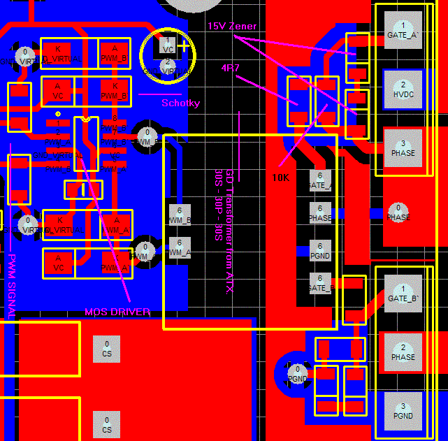

I recently build 12V @60Amp PSU (Half bridge).
At such power level, gate drive circuit are really important thing.
The PWM controller is SG3524.
For the gate drive buffer, I use MC33152, and the gate drive xformer arrangment is exactly the same in slup169.pdf at page 36 (Fig 39)
The only thing I add from the picture is :
1 . Schottky diode from VCC to OUT_A and OUT_A to ground
2. Schottky diode from VCC to OUT_B and OUT_B to ground
3. Back to back 15V zener at each of the xformer output.

Don't you have BD139 and BD140 bipolar transistors there?
To drive MOSFETs, you have to drive the transformer in a totem pole fashion rather than push-pull, the circuit should be able to sink and source current from the primary. You can use several paralleled buffers from a CD4050 or CD4049 to get rail to rail low-impedance logic gate-drive signals out of the SG3524 (the first thing that is going wrong in your circuit). Also, proper dead time is easily implemented with the help of the CD40xx and RCD networks because CMOS 4000 series switch at Vcc/2. Then you can drive some emitter-follower buffer transistors with these signals and then the transformer (through a 1uF DC blocking capacitor). Also, you can move the turn-off buffers (PNP) to the gate drive side ( transformer secondaries) and leave the 4000 buffers driving the transformer directly for turn off.

Hello Eva,
Attached is the corrected gate drive. Please comment. Also, i have been using EE25 for gate driving, how about EE16 or may be EE13.5.
You also suggested CD4000 series for implementing dead time how about a diode resistor network (for each outut of SG3524), similar to the ones used at the mosfet gate? 🙄
