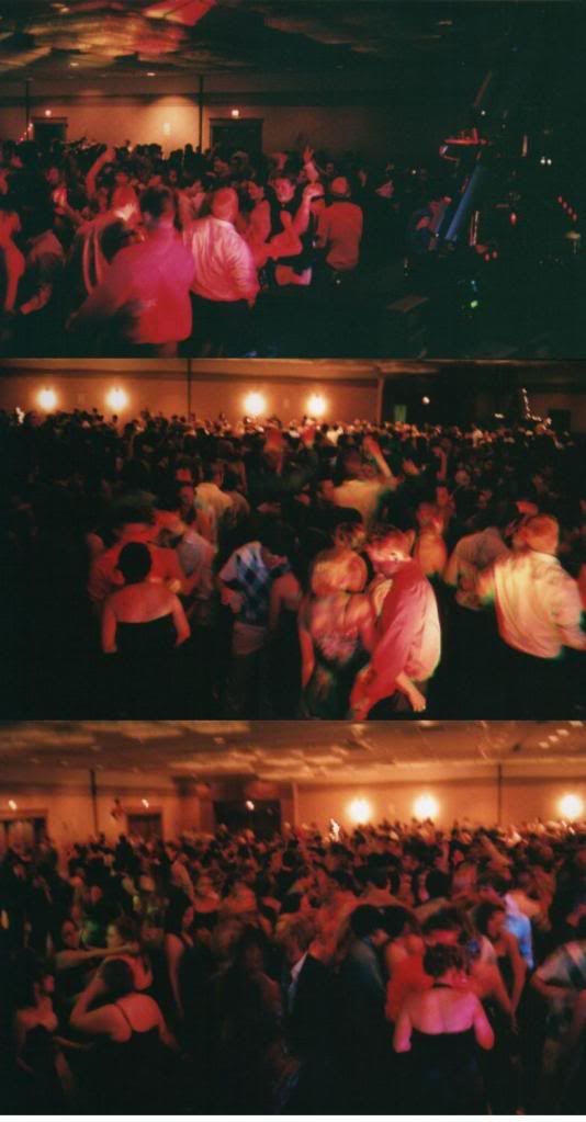

"I have to ask why? "
Large crowds in large spaces with adequate headroom.
This is a very large ballroom than has had up to 3500 people in it at one time, it can be partitioned off into six smaller spaces (each still a room large enough to play basketball in).
